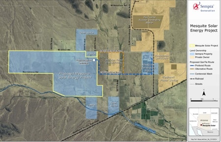

Mesquite Solar I planned location via Sempra Generation
Sempra Generation is not stopping here. Mesquite Solar I, a project in its first phase, is planned to eclipse the Nevada location by a factor of 12.5. 600 Mega-watts will pour from this Arlington Arizona based solar farm, powering up to 56,000 additional homes. This is a commendable effort.
