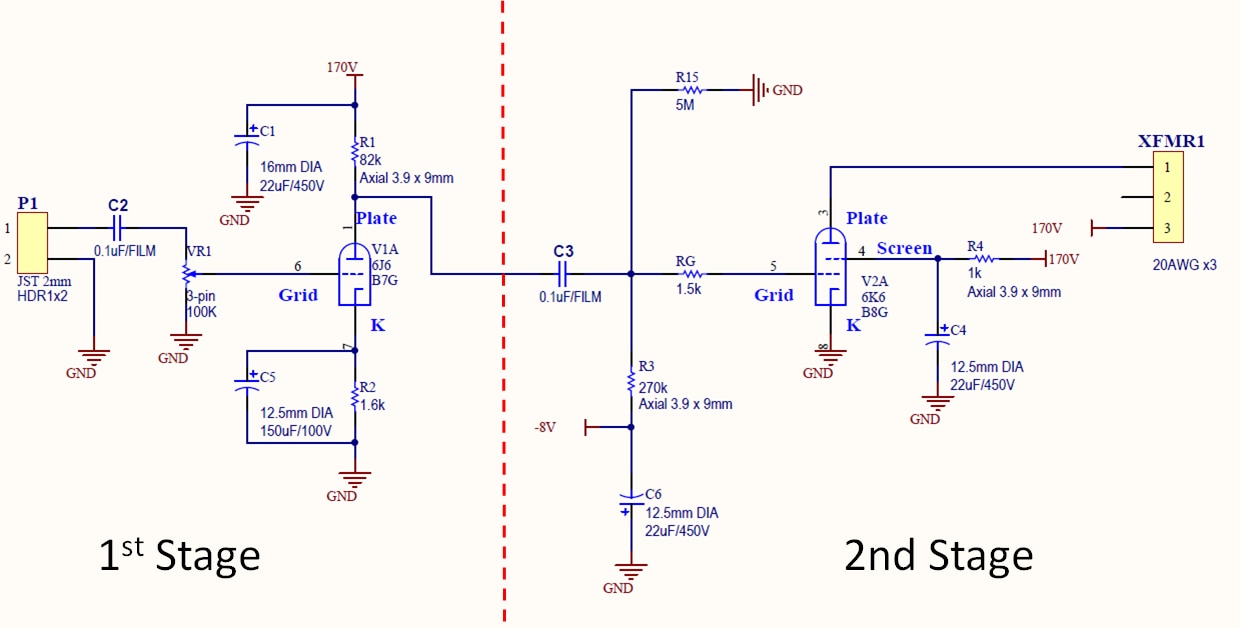

The schematic for the audio channel appears below.

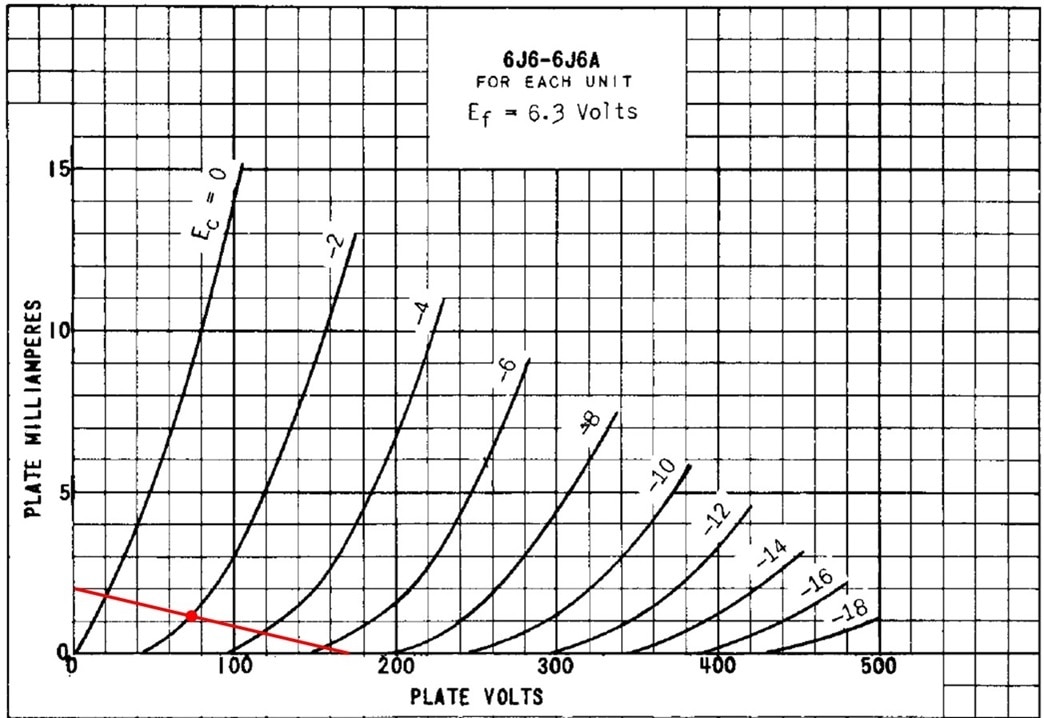

The tube amp is divided into two stages.  The first stage uses a 6J6 triode in a self-biased configuration.  The Supply is 170V and the tube is set up to bias the cathode 2V above the grid.  The output of the first stage is located at the plate.  Its quiescent point was determined by drawing a load line through the characteristic curves in the 6J6 datasheet.
The general process for this is as follows:
  1. Start the load line on the horizontal axis at your supply voltage (170V for me)
  2. Continue drawing the load line towards the left
  3. Try to intersect the -2V curve so that it occurs in the middle of the load line (if possible)
  4. In my case the load line met the vertical axis near the 2mA mark
  5. The resulting load resistor was calculated as 170V/2mA = 85k
  6. The load line intersects the -2V gate curve at 70V and 1.2mA.  This is the output's quiescent point
  7. Next you have to choose a cathode resistor that sets the -2V gate voltage at the quiescent current
  8. In my case it worked out to be 2V / 1.2mA = 1.67k
  9. The values above are ideal values
  10. In the end I went with 82k for RL and 1.6k for Rk
For working out the first stage gain we concern ourselves with the following parameters:
µ=37 Gain factor of 6J6
rp=7.7k Intrinsic plate resistance of 6J6
RL=62k 82k || 270k || 5M
The gain itself is calculated by:
G = µ x RL / (RL + Rp)
= 37 x 62k / (62k + 7.7k)
= 33

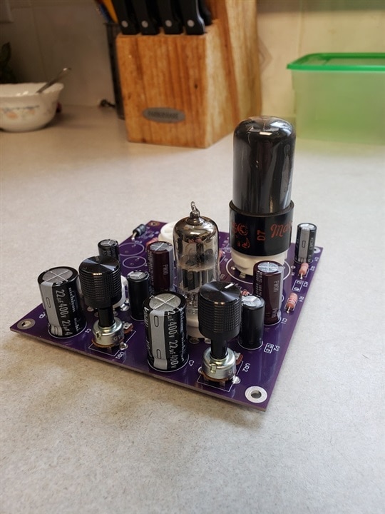

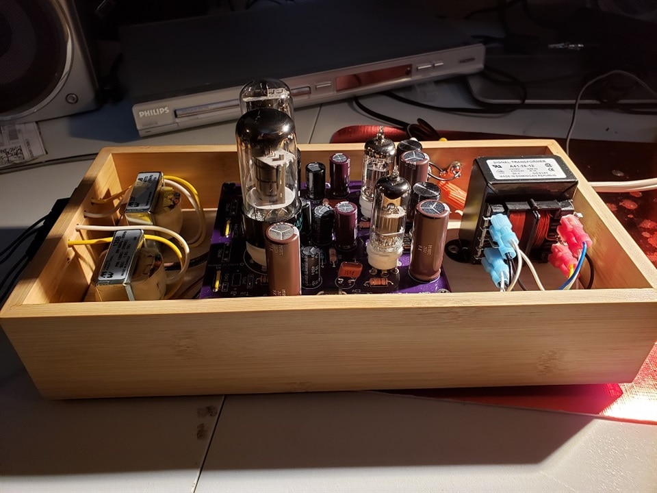

The Tube Amp PCB is shown below.  The 6J6 is the smaller tube in the foreground while the 6K6 is the larger tube in the back.

My set-up with the two transformers is shown below:
In hindsight I could have used a third transformer to isolate the circuit's main supply.  Unfortunately this was not the case and my ground connects directly to the AC neutral line.  Owing to this grounding strategy, early testing was plagued with the most god-awful 60Hz hum.  Connecting a waveform generator to the input or taking scope measurements anywhere on the board was a no-go.  Each of these instruments is referenced to earth ground so connecting them resulted in ground loops.

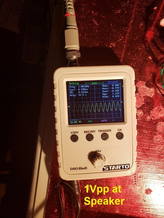

Some Lucky Breaks
Since a cell phone running off of its battery is obviously isolated from the mains, it was the go-to method for my early testing.  I played a couple of songs and it actually sounded really good.  I found a video of a 1kHz tone on YouTube and I eventually remembered that I had a cheap handheld scope.  Finally I had a method to do some characterization.  I played the 1kHz tone and took measurements at the input, second stage input and final output at the speaker.  The three captures for these measurements follow.

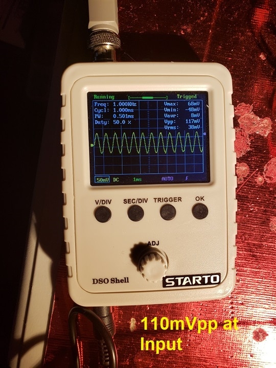

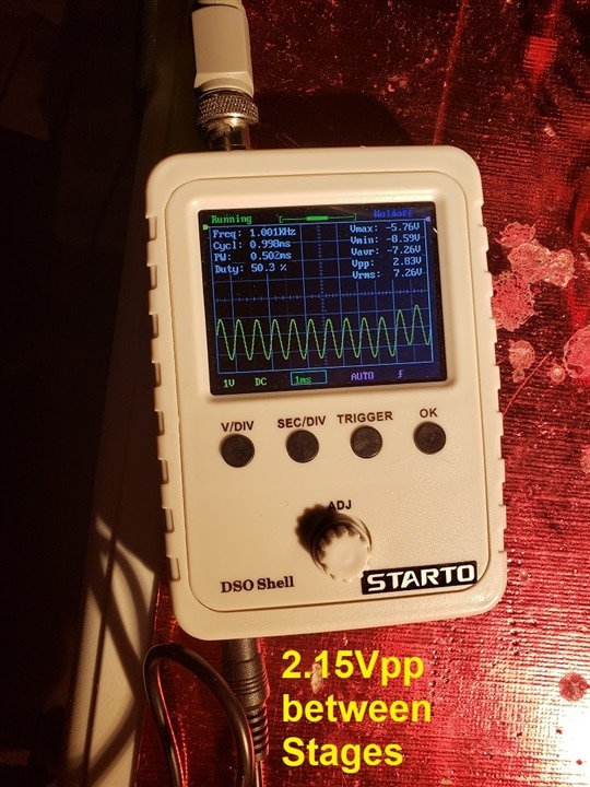

Note: At this point there was still a significant 60Hz component in the signal and it messed up the automatic peak-to-peak voltage measurement displayed on the scope.  I decided instead to measure by counting the scope's vertical division lines.
The measurements show that the voltage gain of the first stage is 19.5.  This is considerably lower than the 33 figure calculated earlier.  Fortunately I discovered that the level out of a DVD player is quite a bit higher than that of a CD player.  This more than compensated for the short fall in first stage gain.

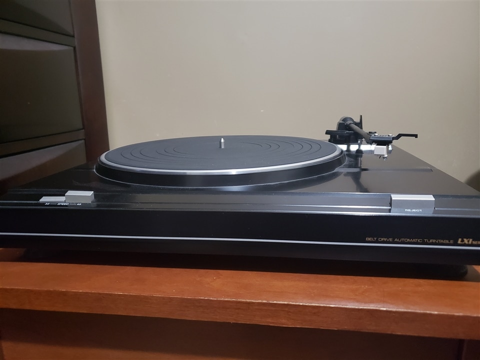

Side Quest / The $10 Turntable
Around this time I came across a Facebook market place listing for an old LXI Series turn table. Apparently the LXI brand was sold exclusively at Sears back in the early 80s. The turn table was listed for $10 and for that price, why not take a chance on it?
Unsurprisingly it needed some work. Over time the belt had transformed itself into a sticky mess not unlike fruit roll up. After replacing the belt and stylus cartridge it was up and running. I purchased an RP400 phono preamp for $15 and connected everything up to my tube amp. It sounded fine but was a little lacking in the volume department.

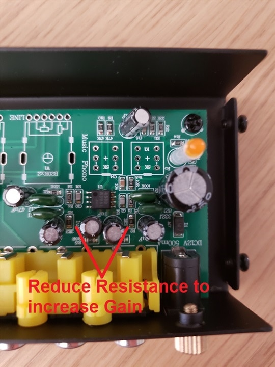

To increase gain I opened the preamp up and reduced the two 3.3k resistors by a factor of 10.
This shouldn't effect the RIAA equalization too much. It pushes the 1Hz pole up to 10Hz and the15kHz pole out to 150kHz. At any rate prior to changing the resistors I compared the modified circuit's simulated AC analysis against the original's and the plots were very similar.

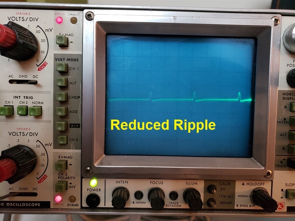

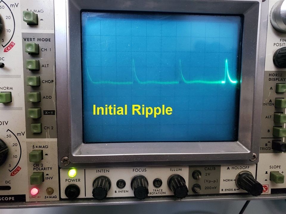

Originally there was a total capacitance of 144uF bypassing the 170V supply. I increased this to 810uF. While this didn't fully eliminate the 60Hz hum it reduced it substantially.
