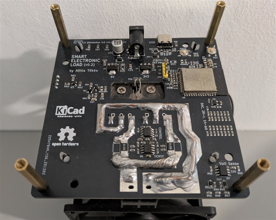

Since the last time from one year ago, Building a Smart Electronic Load | DAC and Initial Firmware (#2), the project was progressing relatively slowly, but now in the winter holidays I had a bit of time and I managed to get the load into a stable working state. Back in November I also ordered new PCB-s for a hardware revision 0.2, fixing the biggest deficiencies of the first iteration. Bellow I list some of the changes made.
image  image
Hardware changes (rev 0.2):
  • Added Load Enable/Disable MOSFET-s (for protection when no input is connected
  • Redesigned the Current and Voltage sense circuits (added opamps buffering to improve stability)
  • Duplicated the Current Sense resistor footprints to offer better thermal dissipation
  • Removed/simplified some unneeded parts (offset adjustments, etc.)
  • Fixed some bugs (RX/TX lines used for DAC), introduced some new ones (:D) and fixed them in rev 0.2b
Rev 0.2 PCB (with consolidated current path:

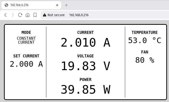

  • Created a simple Web UI with basic controls
  • Rewrote the control loop with RTOS tasks and added continuous ADC readings running at 16kHz
  • Added Constance Power (CP) and Constant Resistance (CR) modes, alongside the existing Constant Current (CC) mode
  • Implemented basic set of Protections for Over Voltage, Over Current, Over Power and Over Temperature
  • Implemented initial support Current Pulses (transient) and shaping
  • Added basic Calibration support (for voltage and current sensing)
Web UI:

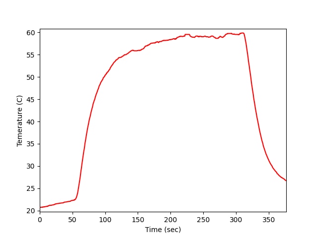

  • Tested temperature stability:
    • Big load thermally stable at 125W continuous, support up to 300W.
    • Small load thermally stable at 50W continuous, supports up to 200W
Temperature curve of the Big load, 125W, 10V @ 12.5A, 100% fan speed:
