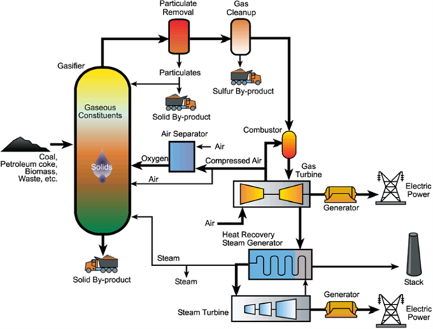

Integrated gasification combined-cycled power plant outlining Pre-combustion capture. (Image credit: National Energy Technology Laboratory)
The definition of ‘clean coal’ often refers to the carbon capture and storage process (CCS)- collecting waste carbon dioxide from power plants and storing it so that it doesn’t enter the atmosphere, which is usually deposited a mile or so underground. The most prominent form of this type of technology is broken down into three methods with the first known as Pre-combustion capture- this process involves removing CO2 from coal before combustion is completed. Coal is saturated with a fuel and in some cases steam to produce a gas comprised mainly of carbon monoxide and hydrogen.
The CO2 is then separated from the hydrogen during cryogenic distillation or a chemical absorption process, leaving a hydrogen-rich fuel source that can be utilized for any number of applications. The advantages here are higher CO2 capture along with steam pressure for increased electrical output. Unfortunately, this platform is still undergoing development for large-scale operations and is challenging to adapt to existing or retrofitted power plants.

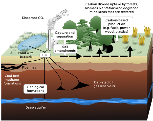

Example of CO2 capture and storage via geological and saline aquifer. (Image credit: Jarl Arntzen via Wikipedia)
After capturing the CO2, it still needs to be transported and stored (unless it’s commercially viable) with the most common being geological. What this means in the CCS chain is sending the captured emissions through a pipeline and into oil or natural gas depleted drill sites several miles below ground and stored there instead of being released into the atmosphere. Another method would be to store the carbon dioxide in saline aquifers with water that is unfit for human consumption or agriculture applications as well as injecting it into cavernous rock under the ocean and after millions of years, combines chemically with the sediment.
It’s important to note that most of these CCS technologies are still being developed and all forms of CCS must be carefully instituted and monitored to avoid contaminating the environment and ultimately outweigh the benefits of containment. The technology presented here isn’t perfect and in most cases, still under development for implementation and widespread deployment. It isn’t designed to be a stop-gap application for aging and retiring coal fleet but rather an ambitious endeavor for a viable solution on how to take advantage of the most abundant source of power on the planet.
