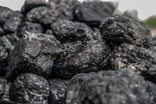

Coal ranks number one on the dirty scale when it comes to burning fossil fuels for power generation. When coal burns, it releases carbon dioxide and methane, known emissions that contribute significantly to global warming. It also creates sulfur dioxide (SO2), nitrogen oxides (NOx), mercury along with particulate matter or soot, all of which have a negative impact on both the environment and humans. As a result, more plants have shifted to natural gas and renewables to generate electricity, which (as of 2016) powers 34% of the US electrical grid, with coal accounting for only 30% and falling.
