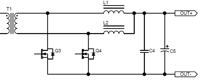

I'm reviewing a Gallium Nitrate step-down converter for Point of Load (PoL) high power conversion.
This design is intended to deliver low voltage (0.5 - 1.5V) at a power hungry point of load. It can source 50A. With a switching frequency of 600 kHz, the footprint can stay small.
Part 1 gives a high-level overview of the design. The converter is interesting for more reasons than just being GaN. There are a few advanced switch-mode conversion patterns used in the evaluation kit.
One of the specifics of this design is the Current Doubler at the secondary stage.
In this design, the output current is divided over two inductors that each take half the current. Rectifying is done by two transistors (in our design: 2 times 2 GaN FETs) that are driven by the same PWM signal that drives the primary side half-bridge.
A few advantages of this design:
  • simpler transformer: no need for a center tapped design.
  • current shared over 2 inductors, so they can be smaller and heat isn't concentrated on a single spot.
  • significant part of the output current is canceled because current in the two sides of the output is (almost) inversed and a significant chunk cancels itself out -> smaller output capacitor needed.

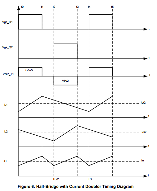

There are more advantages and trade-offs with this design. It requires current control instead of voltage contrlol. You have to use phase-shift controlled PWM; Duty-cycle controlled PWM won't do.
There's a document available on the ti site that explains the design in depth.

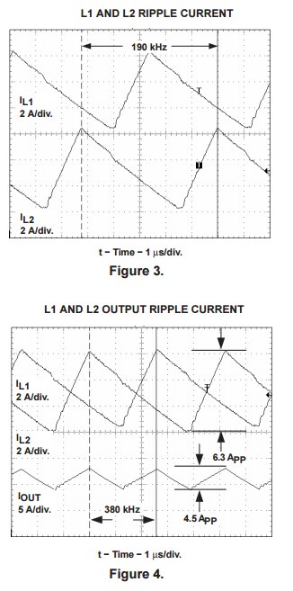

Here's the effect of the ripple canceling with a current doubler:
The two secondary sides are in essence two switching converters that run interleaved. Not exactly 180°. The controller uses phase shifted PWM to drive the two sides and the current that runs trough both inductors is a saw-tooth, not a 180° mirrored triangular signal.
So even though the cancellation isn't perfect, a significant amount of the ripple disappears because of the signals being fairly close to inverse. That allows us to reduce the output filter capacitors.
A second win is that the resulting ripple current has double frequency. So that allows us to reduce the capacity once more.

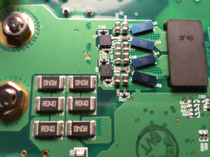

In TI's evaluation kit, the two output transistors are each a pair of EPC2023 GaN transistors. They are driven by the same signal that drives the LMG5200 GaN Half-bridge on the primary:

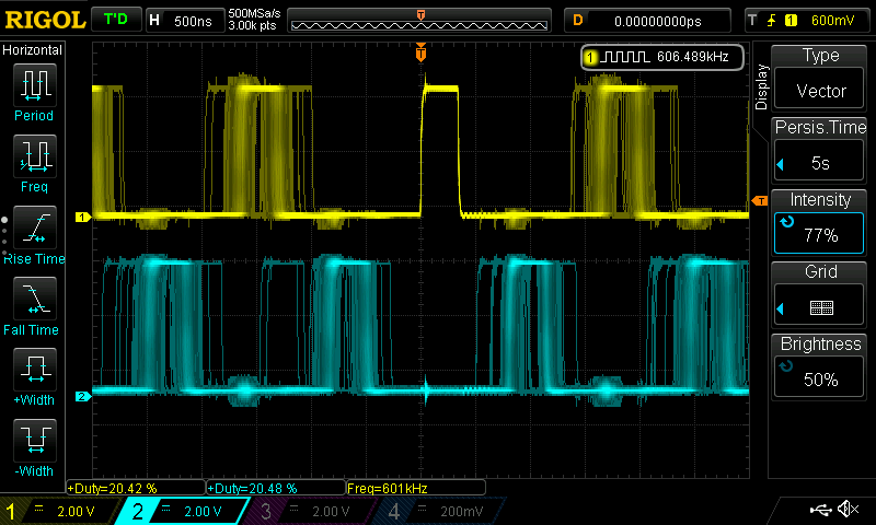

    Posting this here for the follow up blog post:
    in: 40 V; 21 mA, 0.840 mW
    load DAC 10000 (1.17A unconfirmed)
    Single shot (does not show managing load with phase)
    Normal triggered now. Blurred parts in the waves left and right of the trigger point (aided by infinite persistence) show how phase is shifted to manage load:
    (1: primary side switching node. 2: Drain 1. 3: Drain 2)

    The yellow trace is the gate of Q3. The Blue line is drain of Q3, the purple the drain of Q4.
    In reality, things are no so subtle. This is a subst of the design, showing the same FETs and inductors.
    All FETs are GaN devices. On the primary side, the half-bridge sits in a single package. On the secondary side, Each one is actually two GaN FETs in parallel.
