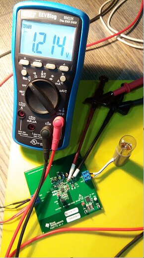

    Jan Cumps over 10 years ago
    Object under test.
    1.2 V, 1 A flowing trough the load. I'm trying to capture how the series capacitor on its own steps down the source voltage to half value.
    (also posting this because I think it's a sweet photo)
    (power cables courtesy jw0752)
