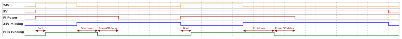

This lead to another question where I discussed about using a relay to properly disconnect the SBC from the +5V rail, respecting the following timing diagram:

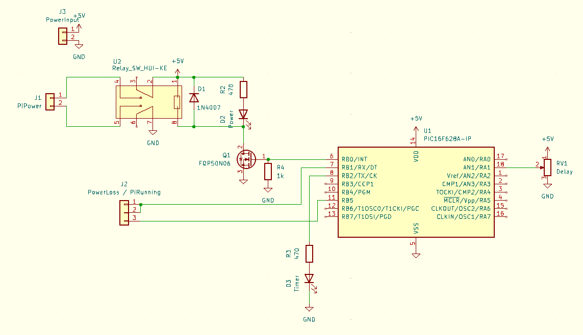

shabaz  noted that doing it all with analog circuitry would have been quite complex and not flexible at all, so I went with the microcontroller option and used a PIC16F628A that had been sitting in my inventory for many years.
As I wanted to change the PowerOff delay without reprogramming the microcontroller, I decide to use a simple voltage divider with a potentiometer. The voltage is usually converted to binary with an ADC, but in my case, the PIC16F284A does not have one. I could have bought a different microcontroller, but then I remembered that this one has a comparator and a programmable voltage reference.
By configuring the comparator to use one pin as its first input and the same pin as where the internal voltage reference is output as its other input, by varying VRef repeatedly, this gives me a “Poor man’s ADC” that is tested in this video:
Sure, it’s only 4 bits, it’s not full scale as VRef is not full scale, but it’s more than enough for this use case.

To reduce component count, the PIC is configured to internally tie the MCRL pin to VDD and to use the internal oscillator at 48kHz. This very low oscillator speed allows very long delays from TMR0, thus reducing the complexity of the code to be written.
With this setup, there is also the need for the SBC to provide a valid “PiRunning” signal to the microcontroller.

This was solved by replacing the bidirectional shifter with a simple pull-down transistor as all is needed is to shift the levels in one direction, not both. This works much more reliably.

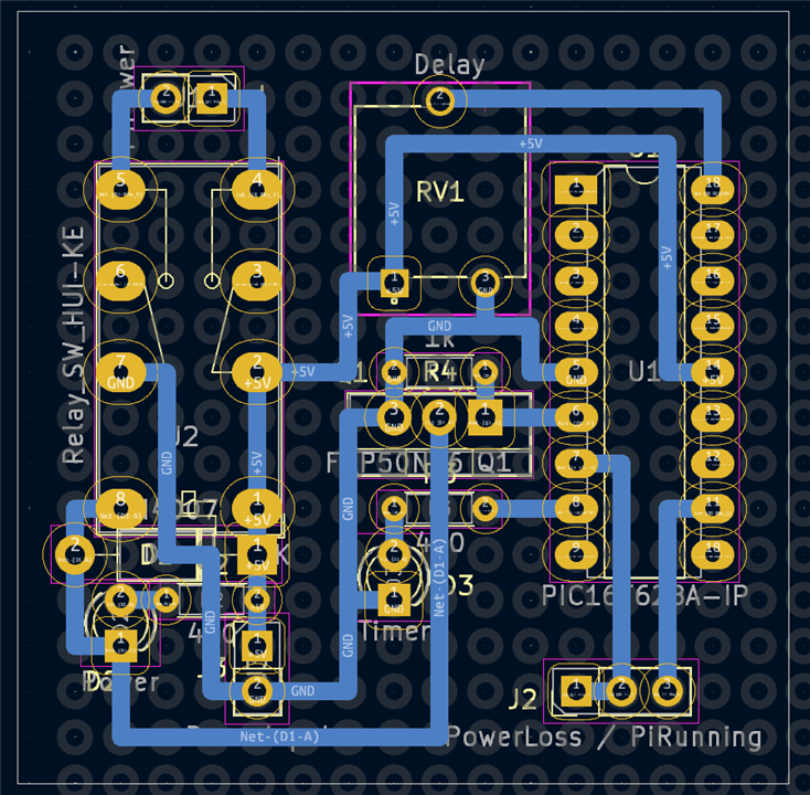

As I did not fancy creating and ordering a custom PCB just for this one off small project, I went with my existing prototyping boards, simply using KiCad to create both the schematic and the grid aligned PCB:
 The only thing not shown here is an afterthought where I added a 1W resistor across the relay NC pins so that the huge capacitor from the step down converter is drained quickly after everything is powered off. This avoids a potential safety hazard with this high current source, should anyone touch the +5V leads by accident.

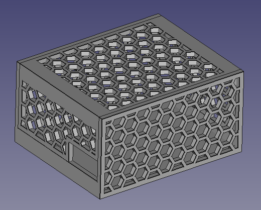

And now I finally have a system that properly manages power supply for the OrangePi, meaning that I could also create a nice box for it in FreeCAD before printing it:
