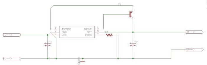

    I agree with you but i just have a doubt on the ciruit below using LTC1734.This is a direct solution from LTC. Inother words could you let me know the which could be the best MMPT IC to be used along witht he LTC1734 here???image

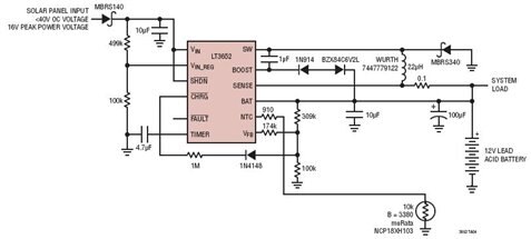

    We are designing the circuit for solar charger; we have a small problem in selecting the Inductor , even though there is a Equation given for Selecting the Inductor, I tried for the Application Information given in the datasheet they say Delta Imax to be between 0.25 to 0.35 of the max. charging current. But When I do reverse calculation for Delta Imax, for the example below its no where matching. Please can anyone help me in giving the solution for the same?
    TYPICAL APPLICATION1A Solar Panel Powered 3-Stage 12V Lead-Acid Fast/Float Charger; 1A Charger Fast Charges with CC/CVCharacteristics Up to 14.4V; When Charge Current Falls to 0.1A Charger Switches to 13.5V Float Charge Mode;Charger Re-Initiates 14.4V Fast Charge Mode if Battery Voltage Falls Below 13.2V and Trickle Charges at 0.15A ifBattery Voltage is Below 10V; 0°C to 45°C Battery Temperature Charging Range HERE please explain me how that 22uH has arrived or taken based on the design The values here are Rsense = 0.1ohmVIN(max) = 16V VBAT(FLT) = 12V, ΔImax = 30% of 1A = 0.3A, L= ???????????
    e14 Contributor over 16 years ago in reply to Muju4mFrnL
    Hi Mujahid,
    As per the Discussion we had with one of the Support Engineer from Linear Tech. , VIN(max) = 32 V(Maximum input Voltage to the Charger IC) and not peak power voltage from the  panel. Also ΔImax is not 30% of charging current, its value should be between 0.25 to 0.30. By using these values in equation for Selecting the Inductor, we get the Inductor Value.
    Regards,
    Chethan R.S.
    Hi Mujahid,
