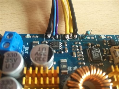

Recently I bought two of these, I was needed to remove all of the pots since they where bad. I soldered a resistor (500K) like this to the board to make sure that the undervoltage protection won't go off, since that was the issue I had when I powered up the board for the first time. That issue caused the fault led to light up and the output to not work.
I got one board working, since I wanted to get one working before I changed the other one. I am not sure if the resistor fix is correct here.
Now, a few days (maybe weeks further), I continued with the project and tried a reverse polarity protection circuit. That didn't work very well, but it was fun to see something, that is not supposed to light up, light up (@28.5V). Everything continued to work after the short!
The next day I soldered the banana plugs that came in to the output wires and all of a sudden the device wouldn't power more than around 2.8V. The fault led is lighting up and the chip is getting very hot.
Did I blew up the chip by testing out the lighting effects on components?
The strange thing is that, the other board isn't working at all. Same problem as the first one.
I didn't test the shortcut capabilities of the second board though.
I have ordered two new LTC3780's and a few of the LM358N's to make sure that they are all good.
I am doing anything wrong?

    What is the LM358 doing - do you have a schematic for this board ?
    I'd need to see that before I could suggest things to measure - what test gear have you got (it affects what I might suggest checking) ?

    I think it's for the power cut off circuitry. I found this link that explains it. It also contains a partial schematic.
    I only got a multimeter.

    Check to make sure none of those solder joints are shorted to a pin adjacent. Use the continuity checker on your multimeter. If you don't have a continuity checker, use the ohm meter to check for 0 resistance.

    I think you should trace out the board to work out exactly how that extra chip is connected. You can just connect the 3780's run pin with a resistor - op-amps aren't needed.
    Before changing anything it would nice to know the supply current being drawn and the voltage measured on all the 3780 pins.

    0.17A @ 12 V. I'll check the voltage tomorrow

    According to the datasheet of the LTC3780 (G package).
    Here are the voltages
    Pin:
    1: 8.89V
    2: 5.30V
    3: 0.18V (at lowest and highest voltage output setting)
    4: 0.18V
    5: 0.32V at lowest output and ~ 2 V at highest output
    6: 0.80 V at lowest and 0.08V at highest output
    7: 0 V
    8: ~ 9.2 V
    9: 0 V
    10: 1.53 V
    11: 0 V
    12: 1 V
    13: 6.42 V at lowest and 7.84 V at highest
    14: 1.12 V (lowest) ~ 3.45V (highest)
    15: 0.80 V (lowest) ~ 2.80V (highest)
    16: 5.84 V (lowest) ~ 1.18V (highest)
    17: 0V
    18: 0.06 V (lowest) ~0.12V (highest)
    19: 5.95 V
    20: 0 V
    21: 12 V (lowest = input voltage) ~ 3.80 V (highest)
    22: 0.77 V (lowest) ~ 2.00V (highest)
    23: 5.60 V (lowest) ~ 0.90 V (highest)
    24: 5.63 V (lowest) ~ 7.30 V (highest)

    I don't quite understand what lines like this mean:
    this is the power input - it should be constant
    The voltage on pin 8 looks like a serious fault - but it has that ~ again and I don't know what it means.
    What is connected to pin 8 - it should be a steady 0V or 5V  - I really need a full schematic to help properly.
    From the history it looks as if something has blown but I can't tell what.
    It is very ambitious to try to debug a switching power supply when you don't have access to a scope - can you borrow one ?
    At the lowest output voltage selected, that line is 12 V.
    At the highest output voltage selected, it is around 3.80 V
    I do have access to a scope, but then I don't have access to my own gear.
    The chip get's very hot when I put the output voltage at max.

    Well, if Vin is collapsing it suggests a huge current - what is the power supply ?
    The fact that the current is affected when the demand for output volts is altered suggests that the 3780 is trying to work.
    It could be that the 3780 is faulty or it could be one of the MOSFETs (or both).
    You could remove the 3780 and test the MOSFETs in place.
    MK

    Unfortunately, the mosfets are covered with a heatsink.
    The power supply is a 600W server psu.
    The board receives 12V from the psu and when I turned the output voltage to max voltage, the extra current draw was 100mA at max.
