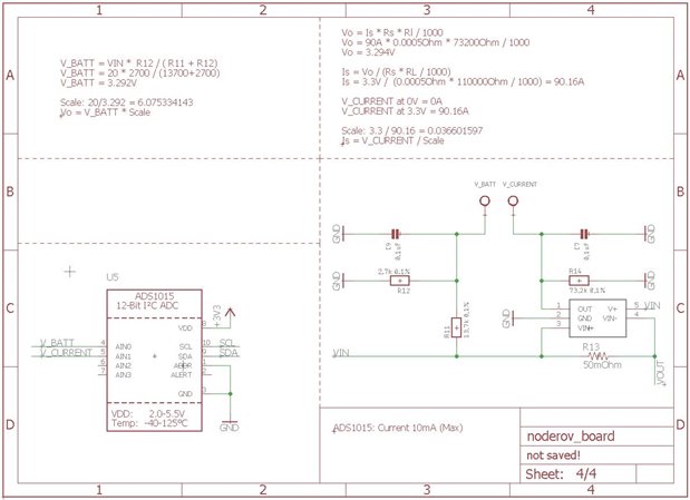

I'm trying to create a circuit in Eagle for a RPi HAT. Currently I am stuck at finding a reliable circuit which meets my needs for power.
The HAT is going to contain a 16ch PWM controller, gyro, compass, accel and a power sensing and voltage sensing circuit. All who speaks over 3v3 i2c.
What I am looking for is a circuit which can read amperage and voltage (send to raspberry pi over i2c) of a Lipo and step down 5V and 3.3V for the raspberry PI. Must be able to tolerate up to 4cell LiPo.
I dont really know the efficent way of doing this. My current idea is using two buck converters like the LM2678 one for 5V and one for 3.3V but it seems like a waste of components to create two seperated circuits. Maybe its my only hope?
Also for the current sensing and voltage sensing i see its hard to find examples online. Anyone here got a tip for me? Would the 5v and 3v3 placed after the amp/voltage sensor be a problem?
Any tip is appriciated!

    Hi Shazbaz, thanks a lot for a lot of good information. I've been looking around to sense both current and voltage I can use a INA169, after a little googling i found INA219 which also measures "bus voltage…
    I've been looking around to sense both current and voltage I can use a INA169, after a little googling i found INA219 which also measures "bus voltage". Which then acts as a voltage, current and power sensor?! It it possible to measure up to 90A 20VDC with this? (Edit: seems like it needs 5v input then I must create 5v first then measure, that means I'll miss the 5v on the measurement. So less accurate readings. So that chip might not work image)
    Here is the circuit using the INA169 i created but I am really insecure about this. Circuit is based on a current sensor I have here from APM.
    Secoundly I have four circuits PCA9685  L3GD20L3GD20 BMP180 LSM303DLHC all connected to reaspberry pi 3.3V how much current can that 3.3V from raspberry give Maybe i dont need two regulators Maybe i can just make a 5v regulator and use the raspberry pi's 3v3

    Hi Thorleif,
    The INA.. chips can be used for any current range, but are you sure you need it for 90A, this sounds an extremely high level of sustained current at up to 20V. If it isn't sustained then you'll need to be quick reading the current value, so it depends on your use-case. There isn't enough information to know for sure.
    Regarding what you can run from the 3.3V pin on the Pi, there is no datasheet/specification for the Pi, so try to keep it low (say 20 milliamps max at a guess). The parts you specify do not consume a lot of power, so they should hopefully be alright.

    Hi again.
    The PCA (PWM driver) says it consumes 25mA pr channel, 16 channels = 400mA so there blows my dream of only needing 5V regulator. image
    90A is "burst", I am making a PCB for kinda a flight controller PCB. Want the chip to be able to handle 12A motors and ESC for 8 motors which is around 96A total. Might be overkill but really want it to be "capable" to handle those bursts. My only consern is powering the PCA with 3v3 will it be enought for ESC to understand the signal when it can only generate 3v3..
    The other chips use sub 10mA in total. I might add a step down for I2C from 5v to 3v3 and run PCA and my ADC on 5V... Thinking loud!
    See latest circuit:

    Hi Thorleif,
    The PCA.. device can supply to 25mA per channel (i.e. it is not a consumption figure, but a capability), and it is up to the connected hardware to use however much current as needed up to that value. If each connected device uses just 0.5mA then 16 channels would only use 8mA total for example.
    I don't know what the ESC will consume, if it is not documented then you may need to measure it, to get a ballpark.
