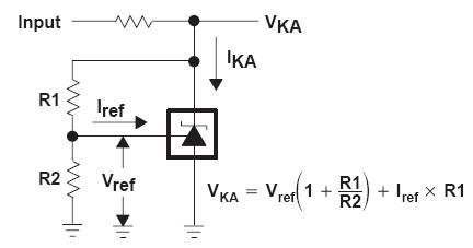

Just a thought, we know you can change a linear voltage regulator like the LM317 into a series constant current regulator by just adding one resistor (loads of application notes on Farnell Web site) but can it be done with the LM431 adjustable shunt regulator?
Anyone know?

    This above picture is the typical application circuit of LM431, it shows us how to adjust VKA. If we replace R1 with LEDs, LEDs current will be adjusted by R2 and Vref. If  Vref and R2 is constant, LEDs current will be constant too

    From  efficiency point, maybe only LM431 is not a good solution because input resistor will share more power dissipation.

    your solution is only for small power LED driver.How about Power LED(350mA current or more ) for resistor will result in lower efficiency
    0 e14 Contributor over 17 years ago in reply to kemmi
    In fact, your solution is a series regulator with discrete parts. The transistor will consume power like the resistance does in my solution. I agree that my solution is suitable for low power led only. For high power led application, I'd like to choose Malcolm's LM317 solution.
