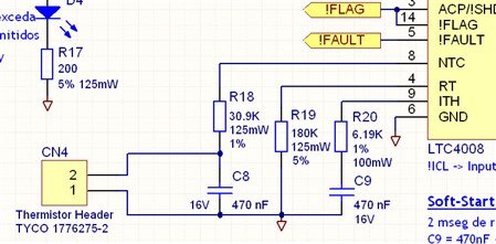

    From the two packs I received, only one of them has a third white terminal (cable). Is this a voltage related to the temperature? Can I connect this cable directly to the Thermistor Voltage In (of the IC charger)?
    The other pack has only two terminals... so, I don´t know, maybe buy a thermistor and put it inside the second pack? So each IC charger receives the temperature of their associated pack. Is this a normal way you think?
    Best Regards,
    Cristian.
  • RWM
    0 RWM over 14 years ago in reply to e14 Contributor
    Interesting, according to product pages on farnell.com and datasheets both modules should have three wires, you have got different model? Anyway, I have not found wires description neither in datasheet nor on gpbatteries web site. I can guess that there is connected 10kohm thermistor between V- and white wire, but you should check this using ohmmeter. If this is not true, you can attach themistor to the pack. It is not necessary to put it inside the pack, it can be attached on outside sleeve but on battery cell (glued for example). Same for second pack. Themistor can be connected to charger NTC input as in datasheet. It is used to determine whether battery temperature is in safe area for charging (usually 0-40 deg C).

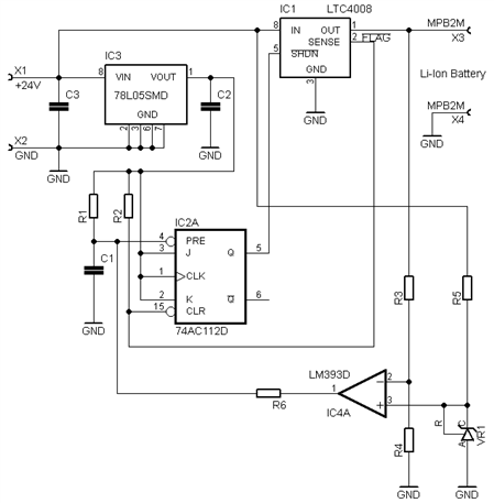

    I have chosen two IC Chargers for each of the two Li-Ion packs. Now when I´m going to design the circuit I realize that if this two packs are connected in series, the GND of the 24V that powers the two IC chargers must be different on each other.
    It´s an automatic charger so I can´t disconnect the packs. So, do I need two source powers? I fear that it will be the only possibility... Anyone has pass through this?
    Hi,
    as these packs have protection circuits which can disconnect pack, you have some options:
    1) use 2 floating power sources (it means GND of both sources not connected, as GND will be connected to negative electrode of power pack),
    2) remove protection circuits from power packs, connect them in series and use one charger; however, you should add protection circuit for 5 cells (for example http://www.ti.com/product/bq77pl157a4225 or more advanced
    http://es.farnell.com/texas-instruments/bq77pl900dl/ic-battery-protec-li-ion-10cell/dp/1640400).

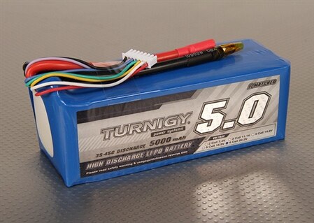

    Hi Christian, by the characteristics of the battery I guess the use to R / C, told him that I had the same problem with Li-Ion batteries are quite sensitive with respect to the overtemperature and overvoltage. In addition, the battery pack that I use are of high capacity (5000mAh) and Vienne linked in series-parallel with no internal protection. I decided to break the pack and reset CI placed a pair of of protection against overload / over temperature and also balances the load of the cell. For the latter decided to take a pair of wires to each cell to the back of the pack and charger by using a load cell by cell in a battery, a load at the end of the cables so that the pack is reinforced parallel series. As an additional point of C.I. also use the download intelligently manage each cell preventing its voltage falls below 3.3V, which were to happen if the cell loses its ability to recharge.

    I´ve also looked for this type of batteries. But I think that packs which are sold in the market that includes protection circuit are also included with a balance charge circuit. The only problem is that they don´t have temperature protection, some of them without even thermistor. (correct me if I´m wrong)
    According to the post with RWM, I´ve been speaking with tenergy about prices of pack batteries with temperature protection included (5 cells - 4,400mAH) but prices goes too high. So the best solution I have is to implement temperature protection by myself, (IC or whatever.).
    The link of Texas Instruments pdf shows nice ICs for implementation. But I don´t see the difference buying one pack with protection included (5 cells in a pack) than buying a battery without any electronic inside the pack.
