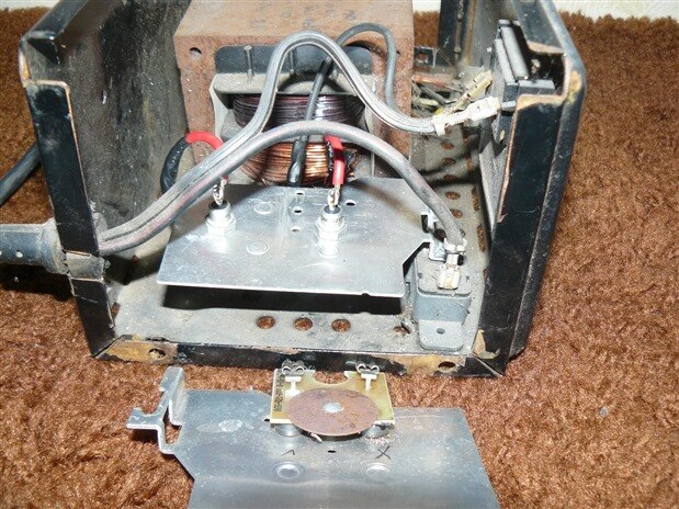

I have 6 and 10 amp, 12 volt manual automotive type battery chargers with bad diodes. These diodes are mounted on an aluminum plate.
I am looking at replacing these diodes with stud mount diodes, style DO4/DO5 etc. I have used MUR2515 in the past, but 1 of these has blown when hooked up to a very dead battery.
I was looking at purchasing MUR2510, 25F40 or FR30G02 as replacements.
Would these be suitable replacements and should I stick with fast recovery diodes?
Any suggested diode #s are appreciated.

    There are no #'s on them.
    I also want to get rid of the "button" style of diodes and replace then with ones that are easier to change in case of failures.

    Send a pic of the diodes please

    0 Former Member over 11 years ago in reply to supper_slash
    I will try to upload a pic of the old rectifier plate with button diodes.
    In the back is the charger with stud style diodes installed on another plate.
