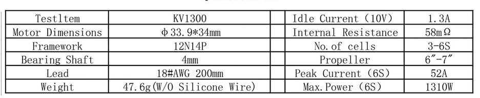

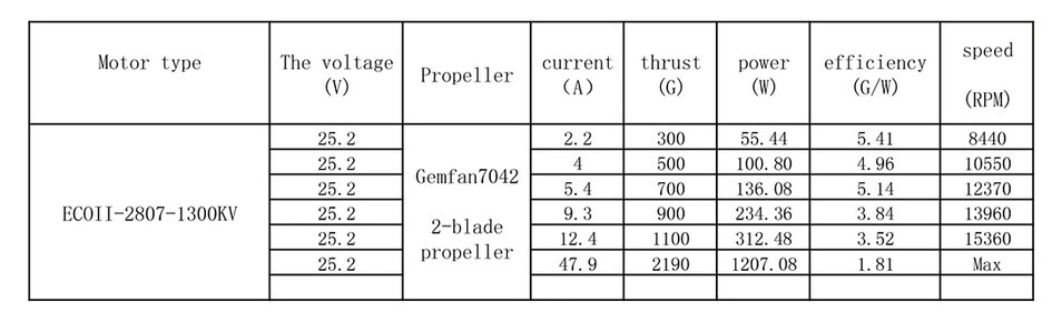

  • michaelkellett
    michaelkellett over 4 years ago in reply to phoenixcomm
    Hello,
    It's not that hard to use that much current:
    A very quick look on Aliexpress found this motor:
    www.aliexpress.com/.../1005001605801893.html
    The OP only needs 4  to hit the 200A. according to the supplier that would give  a maximum thrust of 8kg in total.
    You can power them with batteries like these:
    https://www.aliexpress.com/item/4000629938084.html
    I think the OP is wasting his time looking for a mains supply, the batteries claim 120A continuous and double that in bursts.
