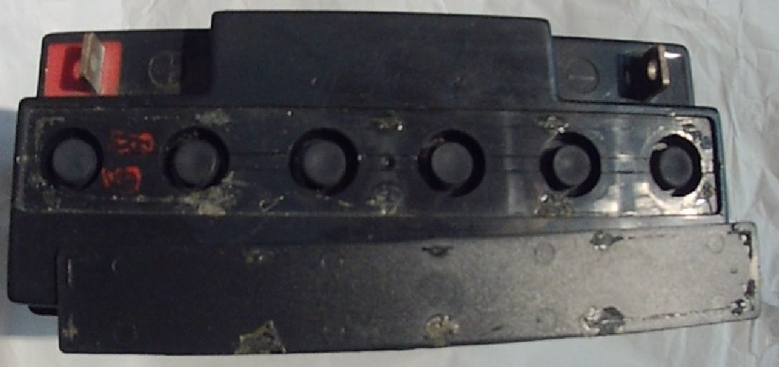

    beacon_dave over 3 years ago
    If you take the top panel off (it's probably glued down) you will likely see a row of rubber vent caps underneath. If they have dimples in them then the cells have probably vented and dried out. If the cells are ok, I've heard of people successfully rehydrating them.
    I took a look at a couple of mine, found that they had vented but a couple of cells had also died so game over.

    beacon_dave over 3 years ago in reply to baldengineer
    Mine had 10 dabs of glue around the edge of the cover, so it levered off without breaking.
    If you pop the rubber cap off there is about a 5mm diameter hole into the cell, so you can rehydrate with a syringe or straw.
    I'm guessing that the battery charging circuits in these UPS units aren't up to much. I've found that most of the batteries fail within the first year or so of use. Would be interesting to find out why they are so unreliable.
  • beacon_dave
    Here is what the dabs of glue under the cover looked like on one of mine:image

    baldengineer over 3 years ago in reply to beacon_dave
    Thanks! That gives me some context.
    I think after I get the swaps done, I'll look to see if one has a lid that is more willing to come off. Removing the lids will be much easier once I know where the glue is located.
    I dunno. I suspect most if not all of these will end up in recycling. But I really want to try and salvage a couple.
