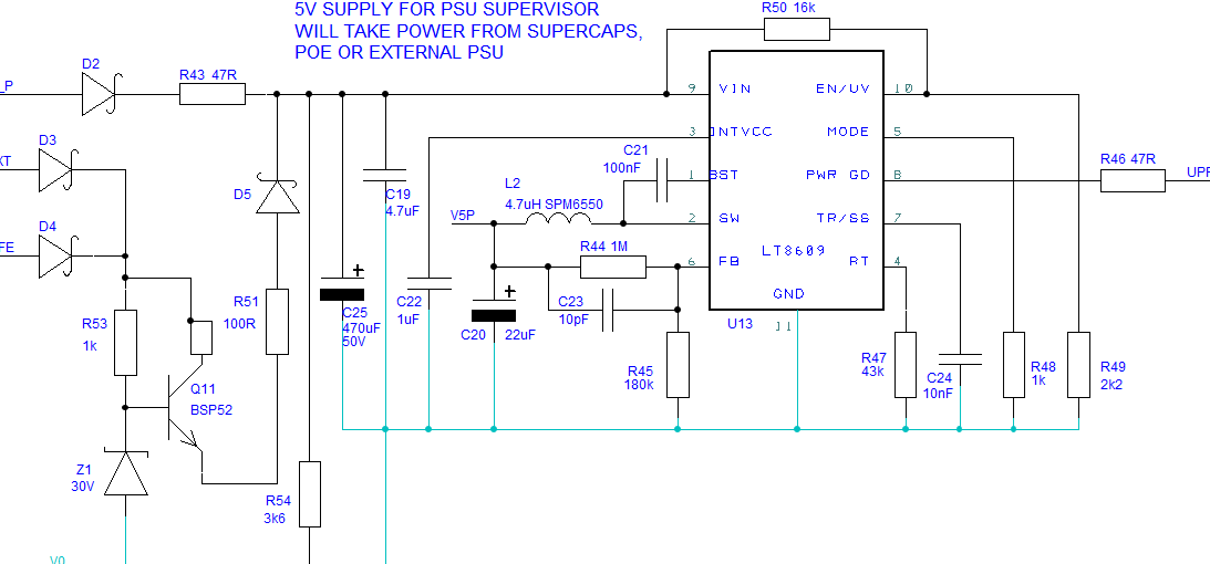

    I very often end up with an LD1117 in a SOT223 package and aluminium electrolytic caps on input and output but quite recently I did this:
    It's a 5V internal supply which is part of a much more complex power supply. It can get input power from three different sources. When running from super-caps it needs very low current drain and may need to work with an input as low as 6V and up to 30V, from the external PSU it may get anything from 24 to 48V and from POE anything from 24 - 70V with 80V surges)
    I couldn't find a switcher that could do everything including the 80V input so I had to use the Q11 pre-regulator on that power source.

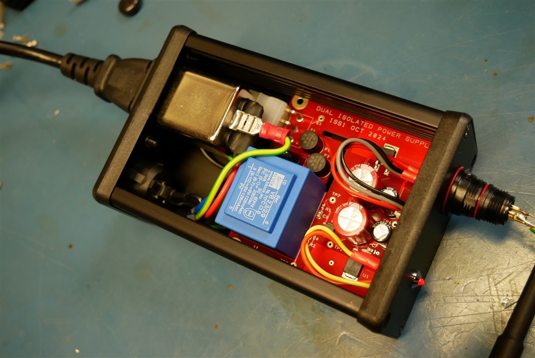

    This PSU was designed to power some current sense buffer amplifiers which needed an isolated low noise supply.

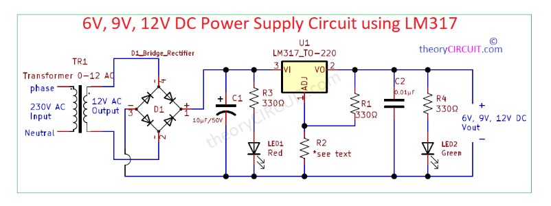

    I found an LM317 circuit drawing that holds some promise. Changing two resistor to get a different O/P voltage. This redesign is to create the ubiquitous P.S. for projects. I can't recall the last time I used an O/P other than 5V. It would be nice to have a 3.3V option. Maybe this circuit with the protection diodes from your second drawing is an option. Humm wonder how it layouts on a PCB?

    If you do a pcb for it I suggest that you add the 2 RCs across the rectifier - if they don't do any good then you don't need to fit them.
    Referring to your circuit above, 10uF on the input looks very small.
    I think the LM317 can manage 1.5A.  At 50Hz you might expect to see 750V ripple (assuming a conduction time of 5ms).
    4V ripple at 1.5 A sounds more reasonable so C1 = 1.5 / 4 * 0.005 = 1875uF - use 2000, 2200 or maybe 1800.
    You can scale with current -  so if the max current you will draw  = 500mA then a 680uF will be fine for C1.
