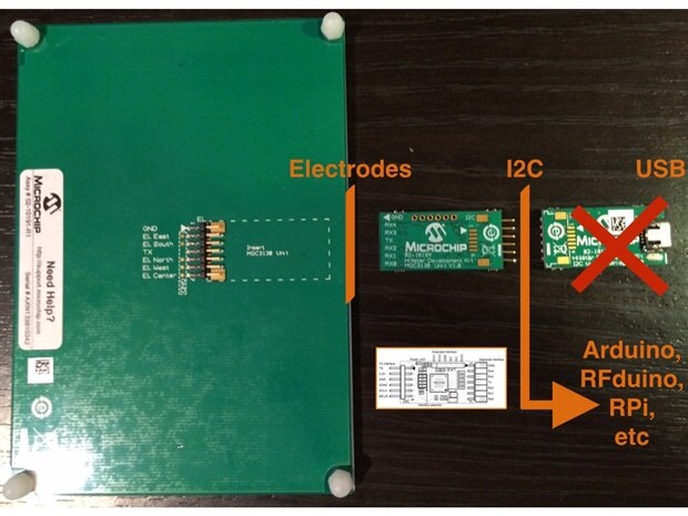

The Hillstar modular approach makes connecting to external controllers very easy. We simply remove the USB-to-I2C module and connect our controller directly to the I2C pins.

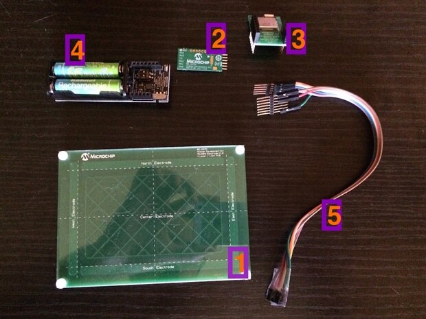

So here's my setup:
  1. Hillstar electrode board
  2. Microchip MGC3130 GestIC board
  3. RFduino DIP module (RFD22102)
  4. RFduino Double AAA battery shield (RFD22126)
  5. 2.54mm to 2mm pitch adapter cable (the MGC3130 is 2mm pitch)
For the Arduino code (that runs on the RFduino) I made some simple modifications to the Hover library since that board also uses the same MGC3130. The only tweaks were to make it work with the RFduino. Once the RFduino was programmed and connected to the Hillstar I ran the Hover example which prints the gesture events:
