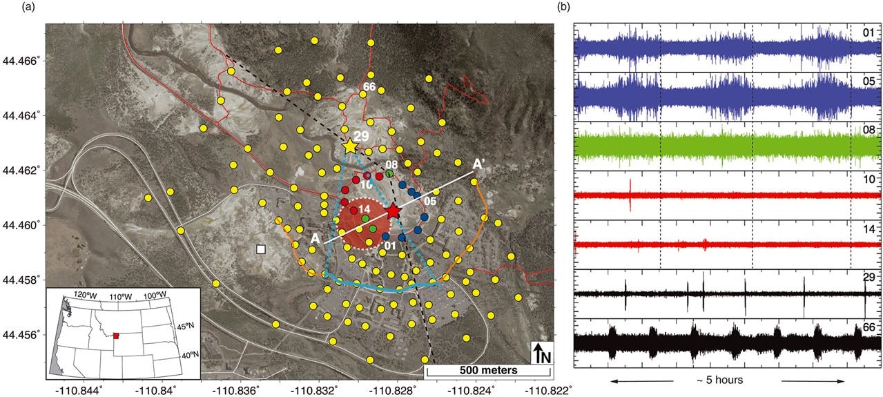

To characterize the hydrothermal system under Old Faithful, the researchers deployed an array of 133 autonomous three-component 5 Hz nodal geophones. These instruments, spaced 50 metres apart, were spread out across a 1 km-wide area in Yellowstone’s Upper Geyser Basin. Each geophone measured ground motion in three directions. Then, the scientists measured how seismic waves traveled through the subsurface.
Scientists relied on the vibrations generated by Yellowstone’s hydrothermal activity instead of creating seismic signals. These signals were produced by hydrothermal fluid and steam migration, while higher-frequency signals come from boiling water and bubbles collapsing. Researchers recorded those signals for 13 days and used the seismic waves as a source to image the subsurface.
The 133 seismic array around Old Faithful. It also shows hydrothermal seismic signals detected at different stations. (Image: Advanced Earth and Space Sciences)
