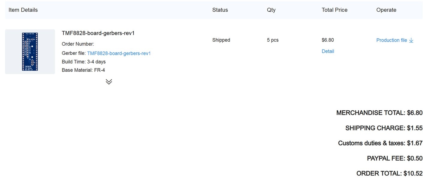

    shabaz over 1 year ago in reply to obones +2
    Hi, I ordered from JLC, and went for the cheapest shipping option. This works out to $10.52 for a quantity of 5, including all taxes and shipping. Qty 5 is the minimum they will produce as far as I can…

    obones over 1 year ago
    Thanks for this very detailed run through, the device looks quite capable!
    What I'm wondering though, is how you get to have a PCB manufactured for 2$, I have looked at various options and for a delivery to France, I'm always at 20/30€ for PCBs.
    Hi, I ordered from JLC, and went for the cheapest shipping option. This works out to $10.52 for a quantity of 5, including all taxes and shipping. Qty 5 is the minimum they will produce as far as I can tell. You're right, it wasn't a total cost of $2, but it worked out to about that over 5 items. I think to France the total should be around 10 euro, since the shipping cost should be roughly similar. For me, the cheapest shipping option typically takes less than two weeks, so it's not too slow.
  • obones
    obones over 1 year ago in reply to shabaz
    Ah that makes sense, it is consistent with my own findings.
    Thing is, I find it quite wasteful to produce 5/10 boards when I only need one.
