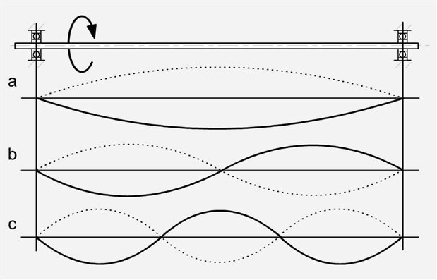

    Actually I am making an apparatus to measure the deflection of shafts at their critical frequencies along with the vibrations. I want to measure how much the shaft is deflecting at different points to verify the modes being formed at that particular frequency. The sensor would measure deflection in the axis which is perpendicular to the rotational axis.

    The shaft is smooth and shiny and is made of Stainless Steel. It is 0.8 m long and I'll be using three different shafts of different diameters, 5mm, 8mm, 10mm. The maximum deflection that each shaft will experience is around 8mm from the rotational axis. Yes we do need sense in two directions both perpendicular and to the shaft rotation as well. I highly doubt we can use a hi-res camera in this case since the deflection being measured is quite small.image
    These are the modal shapes that are formed at different frequencies. Although the image is 2D but the whole shaft flexes like that in 3D. I need to verify this deflection by it's measurement. My design includes a pair of sensors, one measuring deflection in the vertical axis and the other in the horizontal axis. These sensors will be attached to an arm which will have the capability to slide in a slot along the length of the shaft, enabling me to measure the deflections at different positions along the shaft. But since I was mistaken about the sensors, I want to find another alternative to it. The major problem is such a small displacement to be measured.
