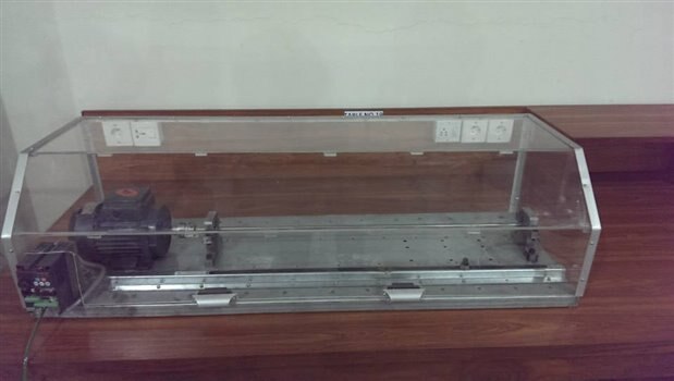

I just bought these, later did I found out that inductive proximity sensors can detect metal in close proximity rather than the distance. I wanted to know if it's possible to by any simple modifications to this sensor that may result in measuring distance. I want to measure displacements of a steel shaft from 0~10mm and I am unable to find a cheap non-contact sensor for that purpose.

    You need to specify or describe your system in  much more detail for anyone to make  a decent sensor recommendation:
    The first question is " why not measure the force directly" - unless you describe the system we don't know.
    Then you need to give other information like bandwidth (frequency range) resolution, accuracy, environment, size constraints, acceptable cost range etc etc.
    MK
    0 e14 Contributor over 11 years ago in reply to michaelkellett
    Well this is what the system looks like. As a replacement for now I am planning to use Linear Ratiometric Hall Effect Sensors to measure the displacement when the shaft vibrates. These are cheaper and for that I'll have to attach magnetic collars at different positions along the shaft.
