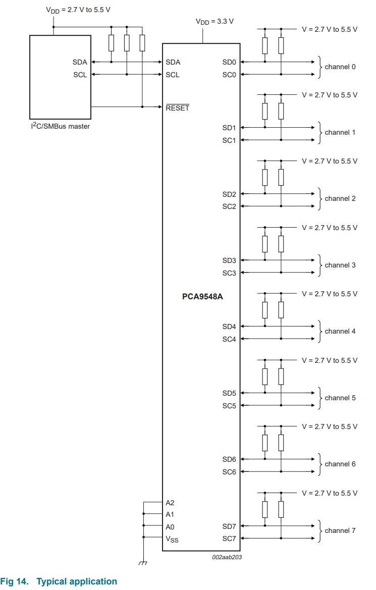

I just bought AHT10 humidity and temperature sensor. I have seen that it supports I2C and it is cheap so I didn't think thoroughly and bought two. I wanted to try them then I encounter a problem that only a single AHT10 can be connected to single I2C bus. I thought it is related to static address but it is worse (breakout board also showing two address but no details in the datasheet). The datasheet says that "Only a single AHT10 can be connected to the I2C bus and no other I2C devices can be connected." It sounds like traditional serial communication like RS232 not I2C.
Is it normal to advertise it as an I2C device? and I also wonder what is the technical issue preventing to connect other devices with different address. Did you have any experience similar to this on any other sensor?

    It might be possible to use two or more AHT10 devices with a 'chip select' type setup.
    The AHT20 data sheet shows a power control application design like this for power saving applications which may be able to be applied to the AHT10:
    'GND_CTRL' effectively becomes a chip select line allowing you to activate the device you want to communicate with using the same I²C addresses.

    Hi  michaelkellett , I am planning to use it for Save the Bee design challenge. I can use GPIO as you suggested, use I2C mux, or simply change the sensor but I wonder is it normal? I just bought it because it supports I2C so I thought I could use the same pins for various devices but it is not possible. This is a cheap product so I don't mind. I wonder it is my mistake or its product's fault. I also want to learn is there any weird things similar to this.
