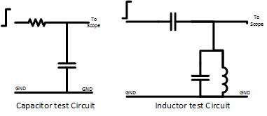

In this blog I will show you how to use basic techniques to derive the value of unknown capacitors and Inductors
All you need is a fast pulse (Compliments of the 33622A), an oscilloscope and a known value Resistor set (1K, 10K, 100K and greater), really any values will do, you just need to know the real value.
The test schematics:

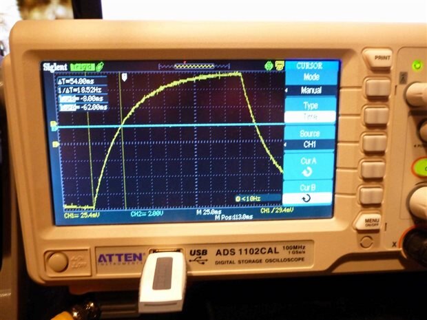

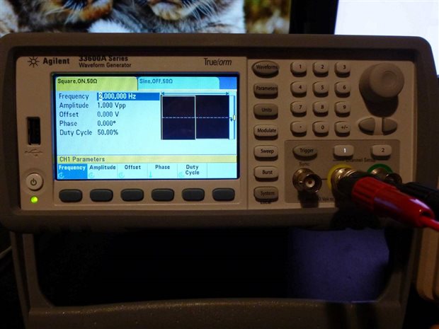

33622A Setup and sample scope display
Initial Setup for capacitor measurement and sample displays for "Scope Probe" and then C3 with a 10K resistor
The capacitor tests being performed using the 33622A as a high accuracy and quality square wave generator

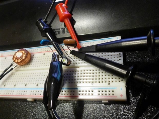

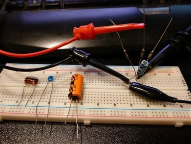

Setup for Inductor measurement, Un-Expanded ringing view, Partly expanded then expanded view in order to measure ringing frequency
The Inductor Tests being performed using the 33622A as a quality square wave generator
