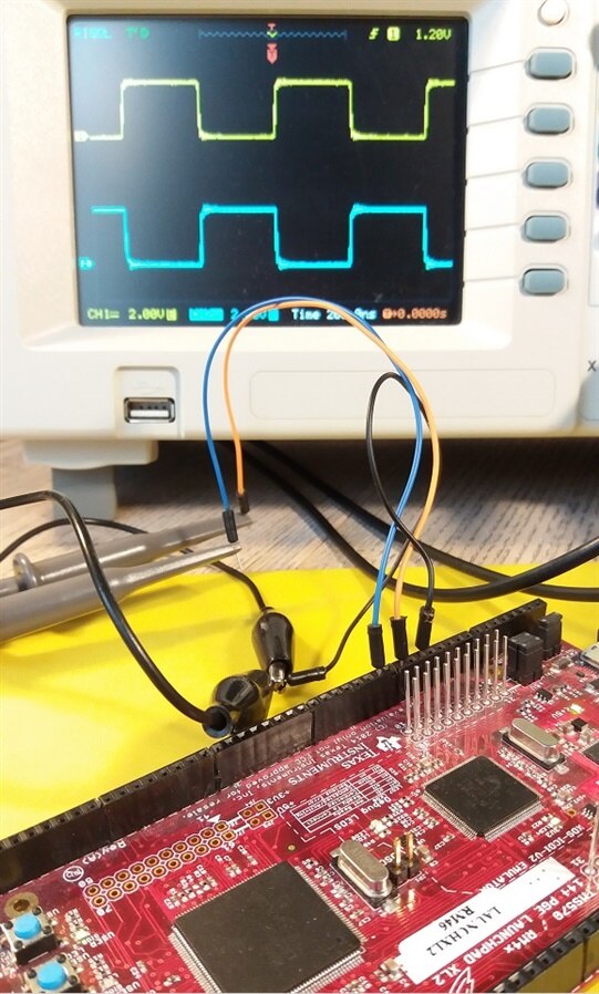

I'm evaluating new switching devices. For that exercise I need a PWM generator that's easy to set up and change to different configurations.
In this series I integrate a controller with LabVIEW, so that I can make flexible test setup - one that allows me to automate and repeat my experiments.
{gallery} LabView and Hercules talk SCPI
LABView SCPI and Hercules LaunchPad: Capture complementary PWM signals

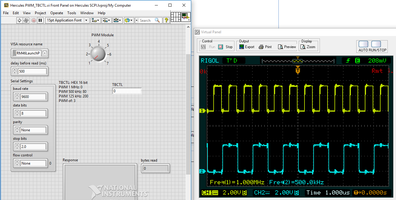

LABView SCPI and Hercules LaunchPad: Drive two PWM modules

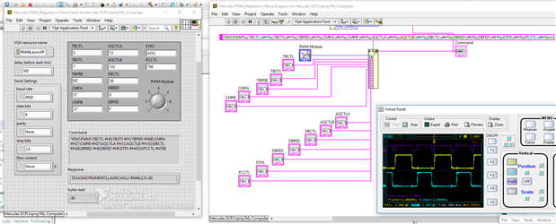

LABView SCPI and Hercules LaunchPad: Full control over the two PWM signals of Hercules PWM module 1
