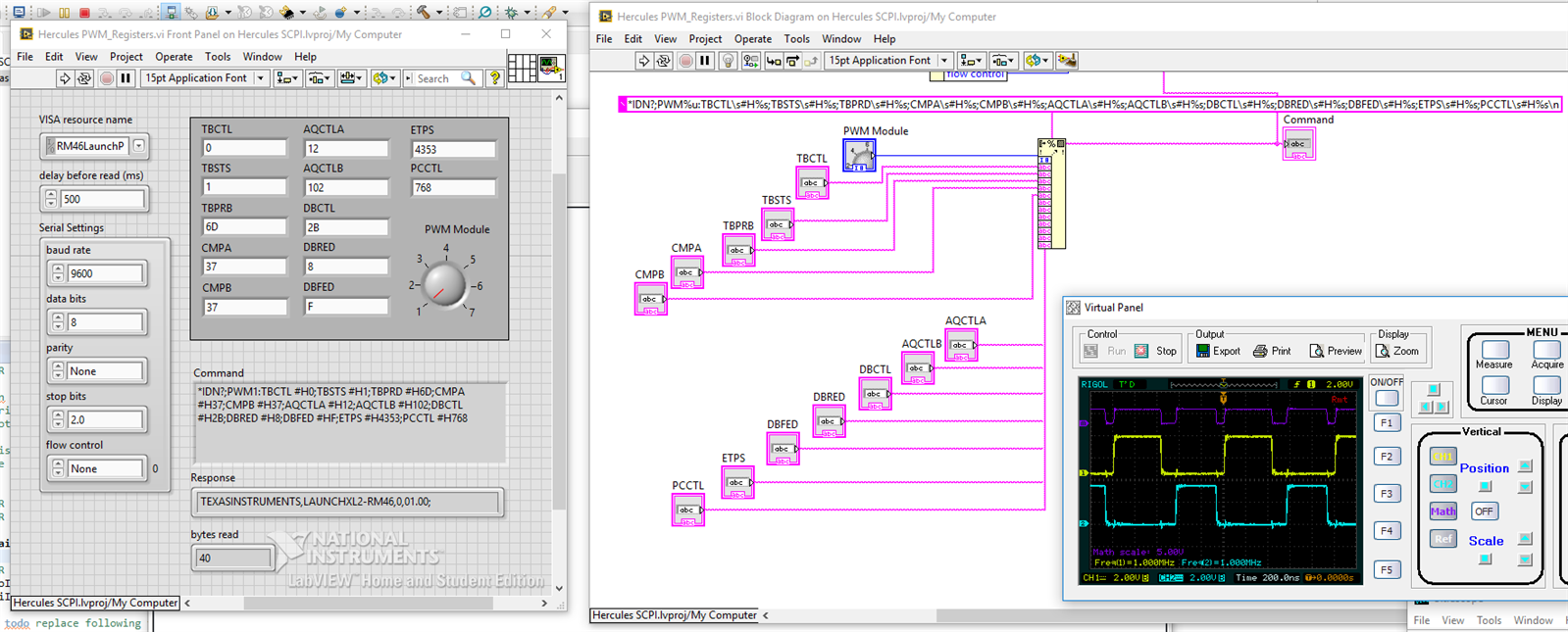

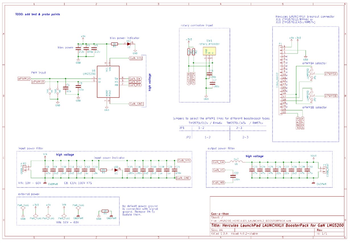

This series of blogs describes the design of a GaN BoosterPack and its LabVIEW integration.
The LMG5200 is a GaN Half Bridge that can manage 80V and 10A. This BoosterPack allows you to evaluate the performance of the device. You can change its operating parameters via software and via the on-board rotary encoder.

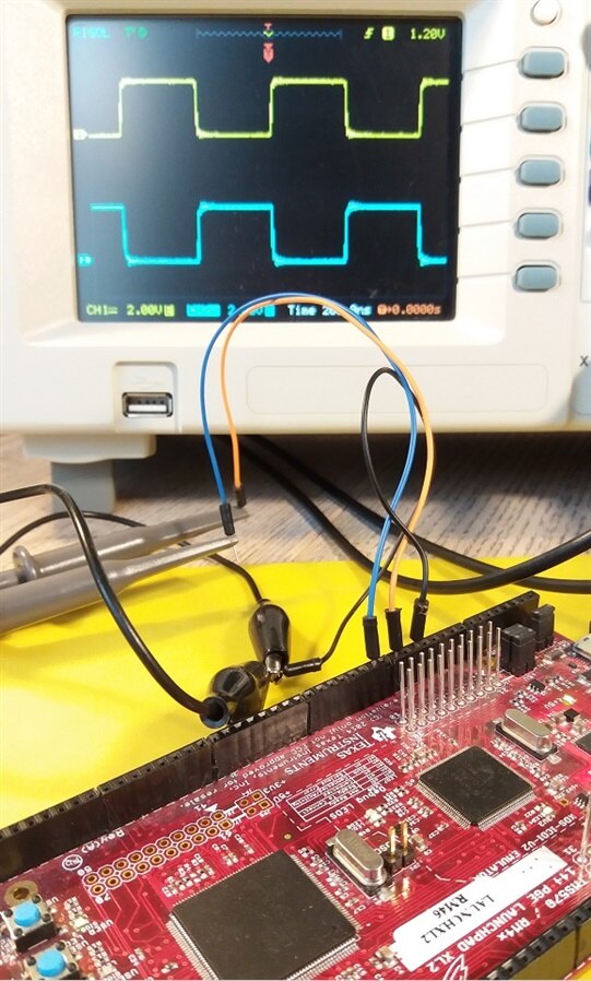

The GaN BoosterPack is designed to be used with a Hercules LaunchPad.
The LaunchPad delivers the complementary signals required to drive the LMG5200 GaN Half Bridge.
The project comes with firmware that allows you to change the driver signals to your needs.

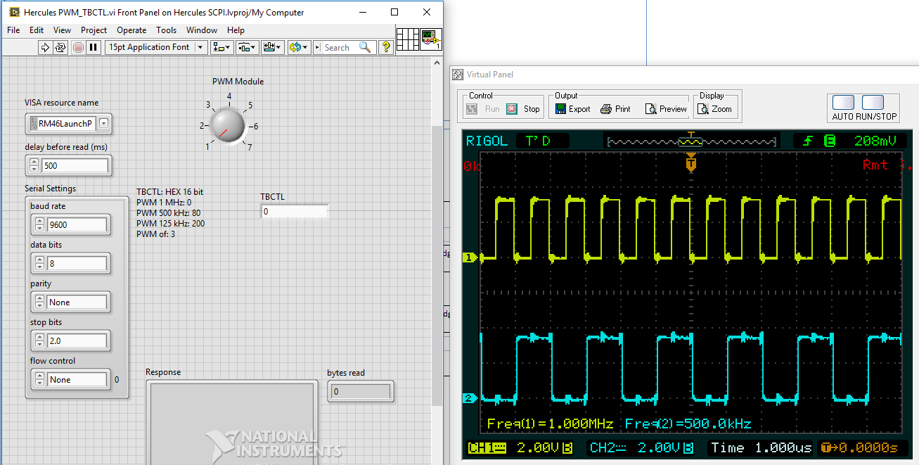

You can change duty cycle, frequency, deadband from LabVIEW or other lab automation software that supports USB and SCPI.
There's stand-alone firmware that changes the duty cycle when you rotate the rotary encoder on the BoosterPack, if you prefer that.
All schematics, PCBs, BOM and source code is attached to the blog posts.

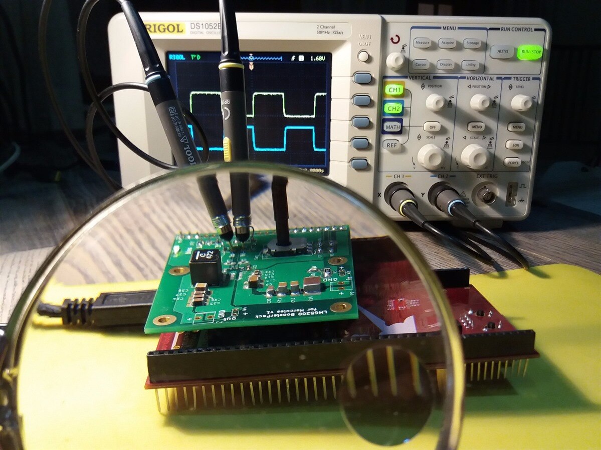

    Jan Cumps over 9 years ago
    I'm prepping to add CAN integration to the design (maybe I apply for the CAN roadtest here, not sure yet but I'm interested).
    I'd like to be able to drive the duty cycle of the GaN half-bridge via CAN commands - and add safety measures to deal with mishaps - and report them back via CAN.
    I have done CAN programming on the Hercules, but mostly educational - see if it works. I'd like to get better at it.
    As a prep, I've been running the GaN board that I made under load. Not anything heavy, it's switching a 10V input to a 5V 2 A output.
    Just enough to see that things are not overheating.

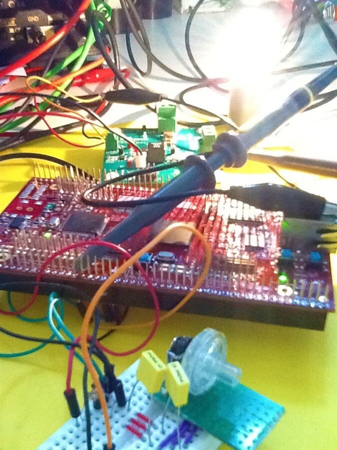

    Jan Cumps over 9 years ago in reply to Jan Cumps
    Oops, maybe a little too over-enthousiast:
    The right leg of my sophisticated electronic load melted.
    It was nice to see - happened in just a blink of the eye.
    The base of that right arm turned red, and the whole thing melted down int a ball. Not in a flash, but in a fluent gracious flow.
    Anyway, I'll have to produce a new load - I may use a similar setup as jc2048 with his matrix of resistors...
    After a few hours with 60V 25mA in, 7.7V (unknown current) out, the inductor and IC run at 60°. The PCB i 50°C.
    Room temperature 21°.
    There's no cooling involved. No air flow or heatsink...

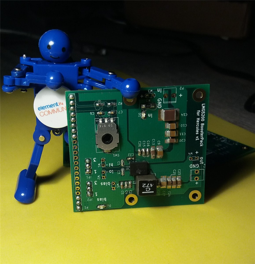

    Jan Cumps over 9 years ago in reply to DAB
    It's performing ok at the moment, DAB
    I'm slowly checking how it behaves under load.
    I haven't put the design under big pressure yet.
    Currently running a 10.3V 1.2A load with a 14V input. The GaN package temperature stabilises at 8° above ambient temperature.
    I've done brief tests with 60V input. But I'm trying to avoid vaporising the chip before I had the chance to evaluate the design...
