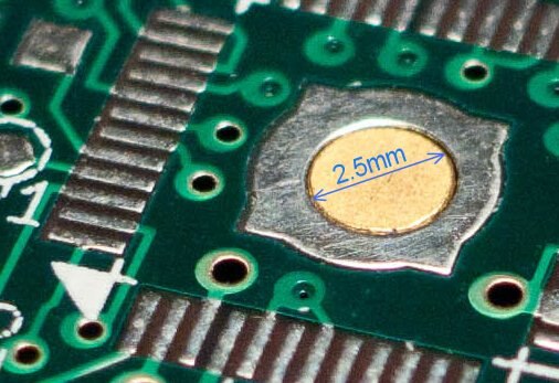

It was hand-soldered in place (there is a procedure), but for this board it was found that the AD9954 does not get hot enough to require it. However it was good to get practice with the PowerPeg because some projects will need the thermal interface capability that it provides. The pegs really are an excellent design. Here is the underside:

    shabaz over 12 years ago in reply to Problemchild
    Hi John,
    The AD9954 just runs "slightly warm" (I will place an RTD on it tonight and measure it after it has warmed up) and doesn't need the PowerPeg. I'd placed it there because the older generation DDS devices were very hot, and I wasn't sure if the AD9954 would be similar. The AD9954 is only ever-so slightly warm, and the oscillator runs much warmer (I think it is the warmest thing on the board). Probably the PowerPeg is best practiced on a cheaper i.c. for the first time round, since it does take some practice (I didn't have reflow or hot air facility).
    The hole on the board is still convenient for soldering the rear of the chip to ground (it is mandatory for the AD9954) just by poking the iron and some solder into the hole, and doesn't need the PowerPeg. I will save my remainder PowerPegs for a different board (planning on building an audio amp) which will benefit more from them.
    You're right, the peg can be bolted on to a heatsink or chassis (TEM Products has some nice machined heatsinks).
    Hi John,
    Sorry for the delay on this (couldn't find the tube of heatsink compound! but in the end found some adhesive pad).
    Without the PowerPeg, the temp rise is not much at all; 18 degrees C above room temp after 30 minutes, measured off the top surface of the IC while it was generating an FM tone (so lots of updates). I've yet to do it with the board with the PowerPeg, but since the rise is low, and I think there is lots of experimental error with the very rough measurement, it may not reveal much difference.
    The oscillator was hotter at 31 degrees C above room temp, so that was hot but it is small so hopefully it reaches equilibrium very quickly (the measurement was after 30 minutes and it was not changing, but I should have checked earlier too); after switch-off, it was back to room temp within perhaps 3 minutes.
