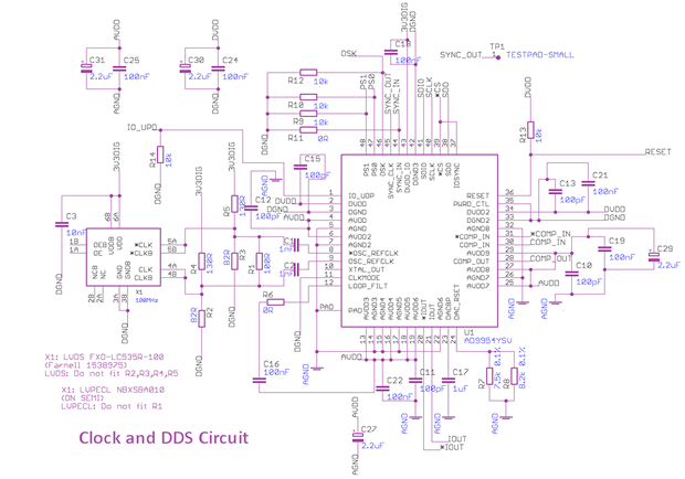

How does it work?
When it comes to a stable, adjustable frequency source a phase locked loop (PLL) is extremely common. The circuit in this post however uses a different method known as Direct Digital Synthesis (DDS) to create the signals. It is described in more detail further below but for now the diagram here shows an overview of the entire system. Node.js is used to create a web server and to handle requests from the user. These are then used to call a program written in C called (imaginatively) ‘dds’. Parameters include the desired frequency and the mode of operation. The C program toggles pins using a simple library described here. The DDS board consists of a DDS chip from Analog Devices (AD9954) that is used to construct up the desired frequency. It is quite closely based on AD’s reference design. The output is filtered and available at an output connector. How Direct Digital Synthesis works is described next (the section can be skipped if you are only interested in the results).
The DDS method in summary constructs a sine wave digitally by sending a table of numbers to a digital to analog converter (DAC). The block diagram from the AD9954 datasheet shows how it works. The areas relevant to the following discussion are highlighted in green.
The DDS chip is fed by a high frequency clock (in this case a 100MHz oscillator is multiplied up to 400MHz by the DDS chip).
DDS devices allow a desired frequency to be programmed using an internal register (e.g. programmed via an SPI or other I/O bus). The programmed value is fed into a summing device or counter, known as a phase accumulator. This is just responsible for repeatedly adding the programmed value to the existing sum, on each clock cycle. So, if the desired frequency is a low value then the phase accumulator will increment in low values too (e.g. the accumulator may count 0,1,2,3,4… if the programmed register value was 1). If the desired frequency is higher, then the phase accumulator will increment in larger chunks (e.g. the count may be 0, 5, 10, 15… if the programmed register value is 5).
The phase accumulator loops back to zero once it reaches its maximum. As can be imagined, each possible value that the output of the accumulator can take represents a different point on a sinewave. The block marked COS(X) in the diagram above can be a look-up table to convert from the phase accumulator output to an amplitude on the curve of a sine wave. This then drives a DAC.
With a low programmed value in the ‘desired frequency’ register, each clock cycle gradually steps through the entire sine wave and eventually repeats. With a high programmed value, each clock cycle still steps through the sine wave but by missing out chunks of it so that the wave is completed in fewer clock cycles; this means that the output frequency is higher. The output from the DAC must be externally filtered to remove image components beyond the Nyquist frequency (half the clock rate).
The Direct Digital Synthesis method results in extremely low noise close to the oscillation frequency This noise close to the oscillation frequency is known as phase noise. However, the frequency spectrum view may also reveal frequency components in seemingly random (but actually some is deterministic) locations, known as spurious output; these are due in part because the resolution of the DAC can be low and therefore the constructed sine wave has errors that in the frequency domain show up as spikes of signal at different frequencies than the desired one. These artifacts can be filtered and removed, but filters are expensive and usually non-adjustable so there is a practical limit to what can easily be done to remove the artifacts.
Sometimes a DDS can be used standalone, or it can be used as part of a PLL in a more advanced frequency synthesiser. The DDS can replace the crystal oscillator in a PLL as an example (other topologies are possible too). The combined approaches provide the best of both worlds; it provides the extremely low close-in noise that a DDS exhibits, and greatly reduced spurious content. Today, if there is a need to create a variable frequency oscillator to span a large range, it is likely to be impossible to beat a DDS based system for all-round performance and value. A more high-end design would combine it with a PLL (but a DDS alone can have incredible performance).
Just to continue with the benefits; a typical feature of Direct Digital Synthesis is the capability to control frequency to a very high granularity; with the AD9954, the 32-bit resolution allows granularity to under a Hertz - perfect for fine-tuning radio receivers.
More notes on Direct Digital Synthesis can be found here.
There are a few additional features of the AD9954 i.c. that are of great interest beyond the basic DDS functionality described. Additional registers allow for functions such as automatic frequency ramping (using a ‘frequency accumulator’) and for adjustment of the output amplitude (by multiplying the output from the look-up table by a factor). One of the best features is that there is a large amount of RAM available that can store 1024 different frequencies. It is possible to instruct the AD9954 to step through the RAM in certain programs of operation. This opens up possibilities to rapidly change frequency (far quicker than any analog oscillator) and to implement some interesting frequency-hop types of use-cases. Yet another use for this feature is to implement modulation; this will be the way frequency modulation (FM) is implemented in this project (it is described later). There are also pins on the i.c. to allow automatic switching of frequencies (or programs) based on the digital state of the pins. It allows for the device to be used for frequency shift keying (FSK); it was not tried in this project. Finally, the serial interface to the AD9954 can run to very high speeds; it allow for features like linear sweeps to be implemented under control of the BBB. This was not tried but would be feasible too.

Clock and DDS circuit
The diagram here shows the main schematic. A few unusual value resistances are required, in places. Most parts were 0603 sized, but the 100pF capacitors were 0402 sized. The DDS circuit is controlled by the digital lines shown at the top of the schematic (SDIO, SCLK, *CS and SDO). Optionally, the OSK, PS0 and PS1 pins are needed if high speed switching of frequencies is needed (e.g. to use as a FSK modem).
The output of the DDS (current, not voltage) is at the IOUT and *IOUT pins at the bottom of the schematic. There is also a built-in comparator (pins shown at the right of the schematic) which is used to convert the sine wave output into a square wave if desired.
An On Semi oscillator was used. There is a alternative part Farnell code indicated in the circuit above but the price looks incorrect for it - another replacement would be Farnell code 2095912). The AD9954 does get warm during operation, but not too hot to worry (if anything the oscillator runs warmer than the AD9954). The board had space to install a PowerPeg (part code TCAP-4325) from TEM Products:
It was hand-soldered in place (there is a procedure), but for this board it was found that the AD9954 does not get hot enough to require it. However it was good to get practice with the PowerPeg because some projects will need the thermal interface capability that it provides. The pegs really are an excellent design. Here is the underside:
