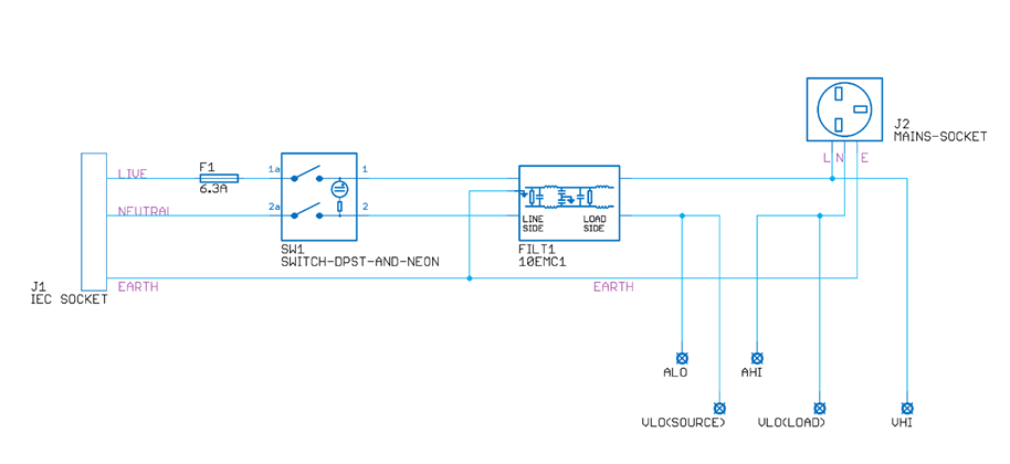

The circuit is straightforward; the incoming mains supply passes through a fuse and then connects to the double-pole mains switch that connects to the mains filter input. The output of the mains filter is connected to the mains socket for the equipment-under-test, but with a break where two banana plug sockets (titled ALO and AHI) are attached, for series connection of the current measuring apparatus, such as a current shunt. If a clamp meter is being used then these two connections would be shorted with a banana lead, and the clamp meter would be connected around the lead. Three additional banana plug sockets are wired for measuring the voltage applied to the equipment-under-test. There are three connections because sometimes it is preferable to measure before the current shunt, and sometimes it is preferable to measure after the current shunt.

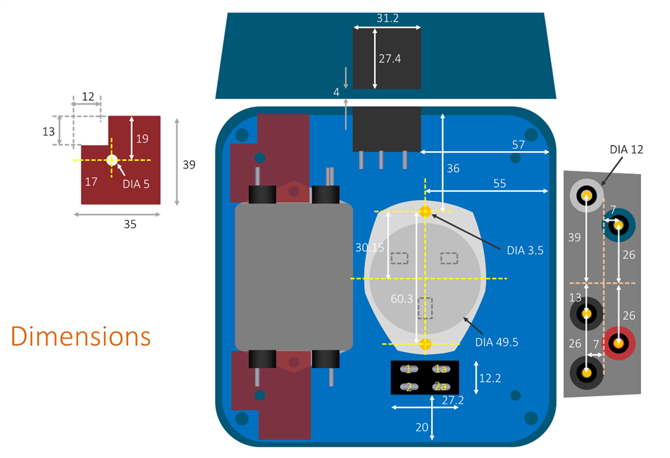

Creating the Enclosure

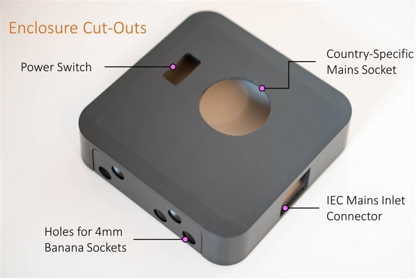

A Takachi enclosureTakachi enclosure was used, and holes were drilled for the various connections.
The required dimensions are shown here (it isn't a true CAD drawing but it is self-explanatory); the shapes on the left indicated in red are used to secure the mains filter in place (see the later photographs):

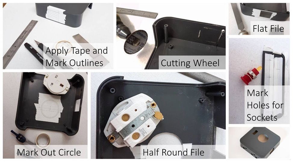

See the photo below for a quick walkthrough of the marking/cutting/filing process. I like marking on tape, to keep the enclosure clean. A Dremel cut-off wheel was used for the larger rectangular holes, and then the corners were drilled out and then filed. For the circular hole, lots of smaller holes were made, and then the cut-out was made circular by using a half-round file. It doesn’t take long because the plastic is soft.
The UK mains socketUK mains socket posed a bit of a problem because it had screw holes for mounting on the surface. I didn’t want them there for cosmetic reasons, so instead I created a bracket of the correct height to keep the socket tightly sandwiched between the top and bottom surfaces of the enclosure once the enclosure is screwed together. Also, epoxy glue was used so that the load would be shared between the top and bottom surface when a mains plug was inserted. The bracket needed to be made from flame retardant plastic; I used PTFE because it is easy to cut. All this is optional; it is unnecessary if you’re ok with the screw holes on the top surface.
The IEC mains inlet connectorIEC mains inlet connector is intended for slightly thinner walled enclosures, so I needed to thin the wall in a small area so that the connector clicks into place.
To hold the filter in place, a couple of brackets were made, again from PTFE sheet. Aluminium sheet could be used too, I just didn’t have any handy. The brackets are optional and not needed if you’re prepared to have screws on the top surface of the enclosure.

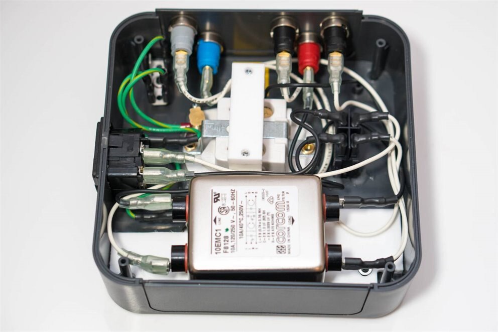

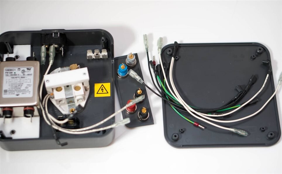

Wiring

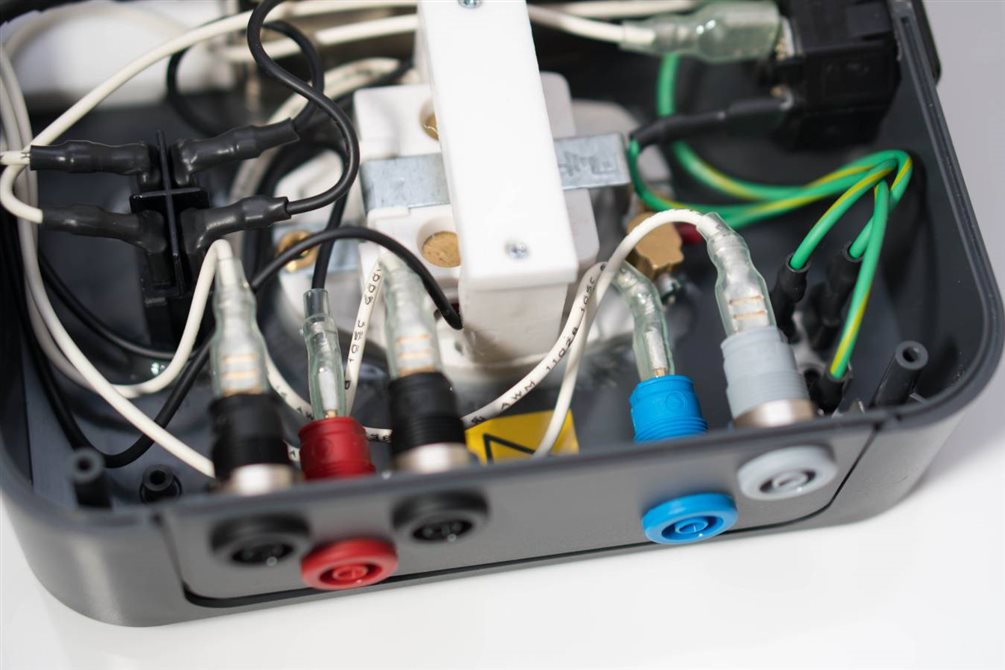

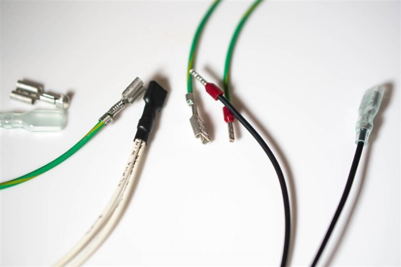

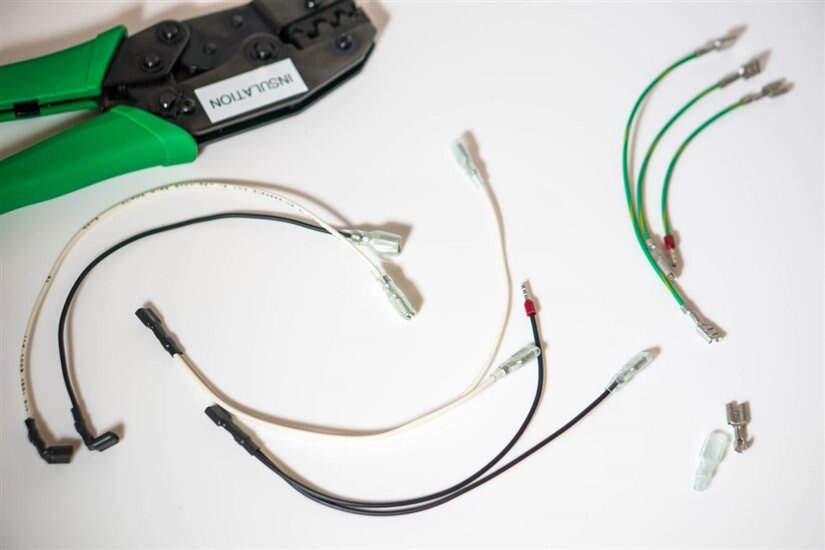

I used 16AWG white wirewhite wire, black wireblack wire and green-yellow wiregreen-yellow wire. For the connections, I used crimp terminals (mainly 16AWG terminals16AWG terminals, but also some 13AWG terminals13AWG terminals where two wires needed to be inserted) and boots or heat-shrink tubing. I used a Duratool crimp toolDuratool crimp tool which produces really excellent results but requires quite a lot of force. It secures the wire and the insulator with a single action. In the photo below, the side of the tool marked ‘INSULATION’ is the side where the wire is fed in. The other side is where the crimp terminal is held.
The switch with integrated lampswitch with integrated lamp requires right-angle crimp terminals which I didn’t have, so I folded them over manually. Not great, but I may swap them out later. For the UK mains socket there are screw terminals, so ferrules were used to make sure that all strands made good contact. I used a Knipex toolKnipex tool for the ferrules (see here for a review and ferrule part codes).
There is a fair amount of cabling but it was fairly quick to cut and crimp them all.

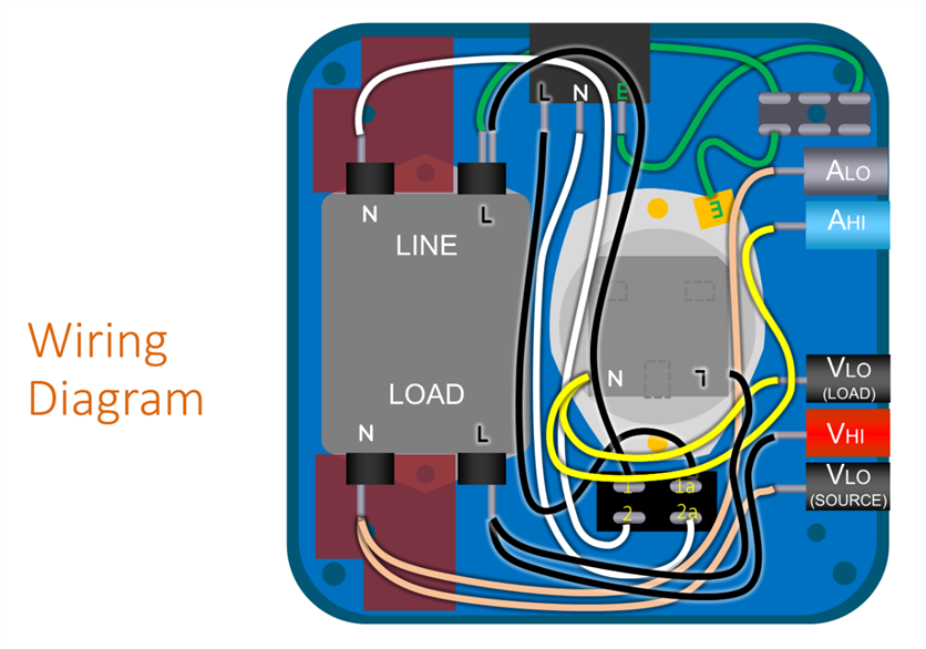

I used white wires for neutral connections and black for live connections. In the diagram below, the green wires are earth connections, the black lines indicate live connections, and the remaining wires are all neutral (just represented in various colors for clarity). Hirschmann banana sockets were used; a blue socketblue socket, two black socketsblack sockets, a grey socketgrey socket and a red socketred socket.

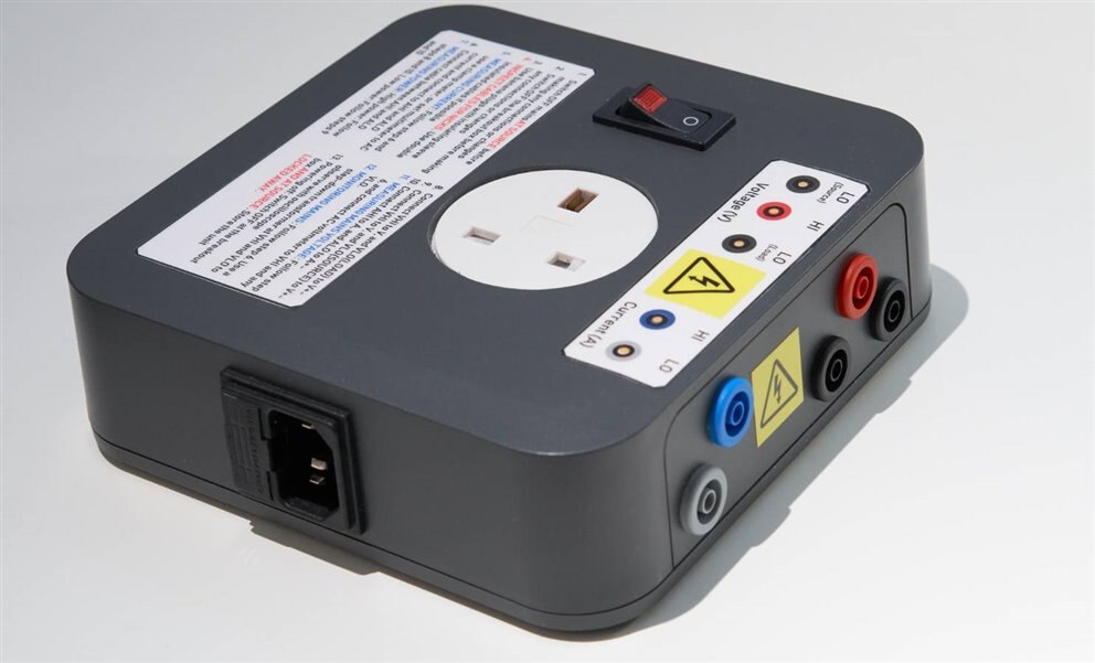

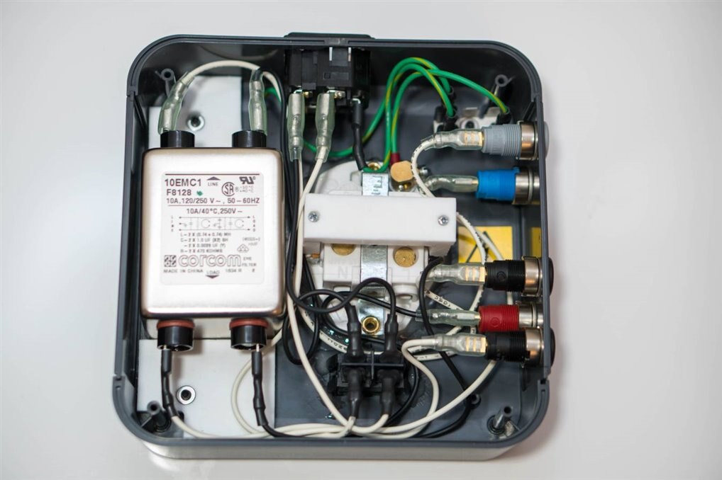

Finally, it was complete! I used some 5-minute epoxy resin glue to secure the mains socket and the switch although it wasn’t really necessary.
Prior to fitting the wires, I applied a tiny dab of epoxy resin glue to the retaining collar/nut around the banana plug sockets, so that they wouldn’t loosen over time. I also stuck a mains warning label inside (the outside of the enclosure will require a lot of warnings and labels too).
In summary, everything fitted really well. The enclosure base was screwed on. It comes with rubber feet too. All that remains is to perform some tests and apply some instruction and warning labels to the enclosure.
Testing It
Prior to closing up the box, I gave it an inspection and made sure all connections felt secure. Next, prior to connecting to a real mains supply, a couple of IEC mains cables were connected to the box, to the IEC socket and the UK mains socket. This allowed me to stick multimeter test probes into the leads and test out the connections without connecting to any mains supply. I confirmed that the live, neutral, and earth connections were not shorted at either end, and then confirmed that the live and neutral connections were end-to-end when the switch was turned on, and a test lead was used to short the AHI and ALO connections. I also tested with the connections opened, and with the switch turned off, to check the expected behaviour.
Finally, I attached the mains supply and checked with a multimeter that 240VAC was measurable across the VHI and VLO connections and that it was possible to measure current for a connected load, by using a current clamp meter placed around a test lead that was shorting the AHI and ALO connections.
