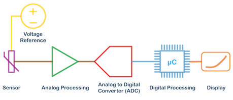

First some temperature measurement technologies will be examined. Then the analog portion of the design will be presented along with some theory that can be totally skipped, and some initial test results. The analog design is actually very simple – it uses just two integrated circuits (surface mount devices but hand-solderable) and can be tested with a multimeter.
The digital portion (which again is quite simple) and software will be covered in a follow-up blog post so click on the ‘bookmark’ link to the right side if you wish to be auto-notified.

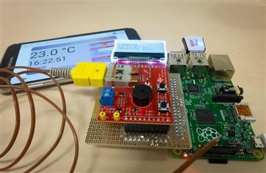

If you’re on a home budget then it is possible to make a simple thermocouple system with a Texas Instruments development board and a Raspberry Pi.

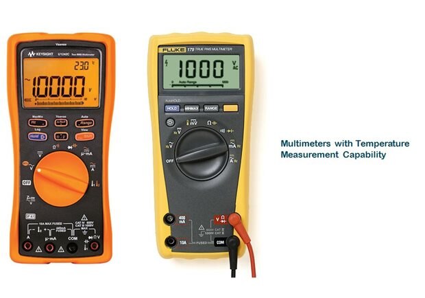

The thermocouple is extremely popular in labs especially because some multimeters support them! As a result it can be one of the lowest cost ways of measuring temperatures in a lab. A single thermocouple is never enough, so you may need to specify several multimeters and thermocouple kits for the lab.

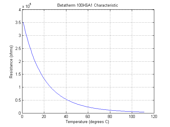

Thermistors change resistance as a temperature change occurs. The negative temperature coefficient (NTC) device selected for this project (Betatherm 100K6A1BBetatherm 100K6A1B) has a high resistance at cold temperatures, and a low resistance when it is hot. The resistance change is large however it is non-linear.
The graph for the specific device used for this project is shown here; at zero degrees Celsius the resistance is close to 350k ohms, and at 100 degrees C the resistance has dropped to close to 5k ohms.
One school of thought is to use a current source and then measure the voltage across the thermistor. The approach works however it has a major disadvantage that it does not begin to address the non-linearity. It means a very high resolution ADC (24 bits or higher) is needed just to be able to handle the high temperature measurements with any decent resolution since the gradient on the curve is so shallow at those high temperatures. The required ADC resolution of 24 bits can be approximately guesstimated by examining the change in voltage that would occur for 1 degree C change (or 0.1 degree C change – depends on your desired output resolution) at the shallowest area on the curve which is at the upper temperature region, and seeing how many bits are needed to resolve such a difference in voltage.

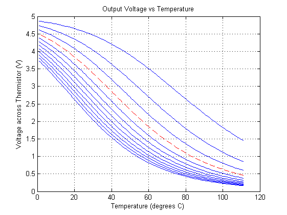

Another approach is to construct a potential divider and size the fixed resistance appropriately such that the measured voltage is more linear. Then, after the signal has been digitised the exact reverse function can be applied by computation by the processor to get back to the original non-linear curve and then do a calculation to work out the temperature. The final result can be astonishingly accurate thanks to the work of Steinhart and Hart who in the 1960's came up with a mathematical model which very closely represents the actual resistance-temperature curve of thermistors. More on that in Part 2.
What value of resistor to use? This depends on the range of temperatures for which accuracy is needed.
As an example, the graph below (for 0 to 110 degrees C) shows the voltage across the thermistor when the resistor in the potential divider takes a value from 10k ohm to 120k in steps of 10k; the top curve is for 10k, and the bottom curve is for 120k.
From this one might want to select the curve which is most straight; perhaps the red dashed curve which corresponds to a 30k resistance.
The benefit from doing this is huge; performing this linearization, the ADC requirements dramatically drop from perhaps 24 bits to 14 bits, if resolution sufficient for 0.1 degrees C is needed.  Furthermore, even though the line is not exactly linear, it is well-defined. This means there is no major impact to accuracy because the opposite transformation will be applied by the software running on the processor. Were this an analog-only temperature measurement system, more care would be needed to perform better linearization. We don’t need to do that with this combined analog/digital solution.

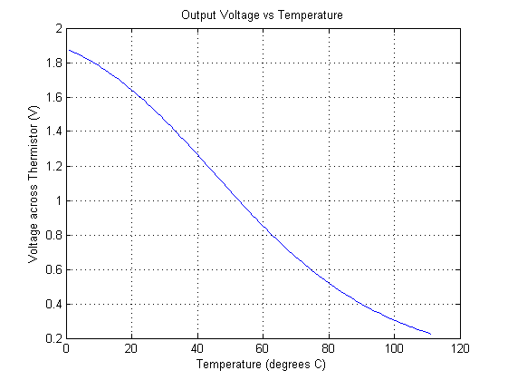

The actual resistor chosen was 33k ohm; this allows the inflection point of the curve to fall at almost exactly 50 degrees C which is a typically expected temperature for heat sink experiments. It is also important that the resistance is not too low and the voltage is not too high, because then a lot of current passes through the thermistor to cause self-heating. To calculate this, the power dissipated in the thermistor is calculated (using Ohm’s Law and the Power Equation) and compared with the ‘dissipation constant’ for the thermistor. If the power dissipated matches the dissipation constant then the temperature of the thermocouple will rise by 1 degrees C due to the current. As a result, a voltage of 2.048V was chosen and this combined with the 33k resistor selection meant that the error due to self-heating would be limited to under +-0.04 degrees C. These values should be ideal for thermistors down to about 1mm diameter; any smaller and the self-heating error would need to be further considered.
The graph below shows the output with 2.048V powering the potential divider circuit (33k ohm resistor and the thermistor). It shows that as long as the subsequent analog to digital converter (ADC) stage can handle an input between 1.9V down to 0.2V, a range of zero to 100 degrees C can be covered. Beyond these limits, the curve becomes shallower again and some accuracy and resolution will be lost.

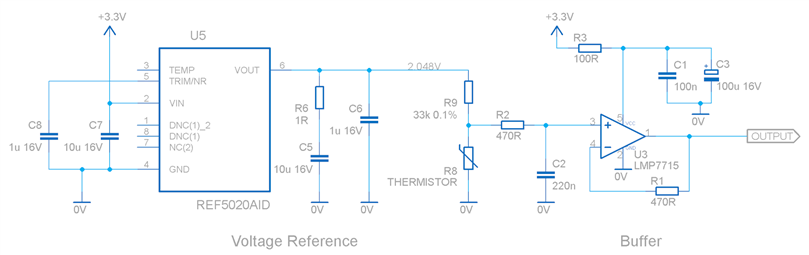

Buffering the Signal

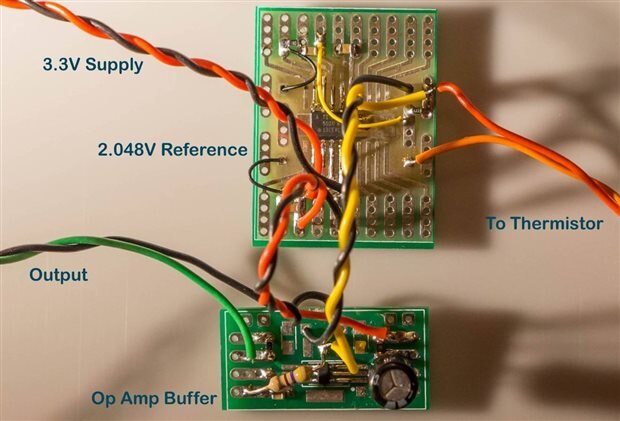

Because the resistance of the thermistor varies so greatly and takes on a very high resistance at low temperatures, the signal is inappropriate for feeding into an ADC without buffering. The choice of buffer was a fairly easy decision; Texas Instruments has some op amps with extremely low input bias current. The LMP7715 was chosen and a conventional non-inverting buffer circuit was used.
For increased accuracy a 2.048V source was created using the REF5020 integrated circuit. The entire circuit can be powered from a 3.3V supply.

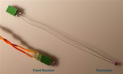

Eventually a PCB will be designed but the prototype was constructed on SMD adapter boards. To test it out, the thermistor was temporarily replaced with a fixed resistor to simulate any temperature of interest. I used a 20k ohm resistor and then observed the output on an oscilloscope. However, any noise on the signal was below the measuring capability of my scope and probe. The output voltage level was at the expected voltage (770mV) given the accuracy of the resistor was just 1%.
