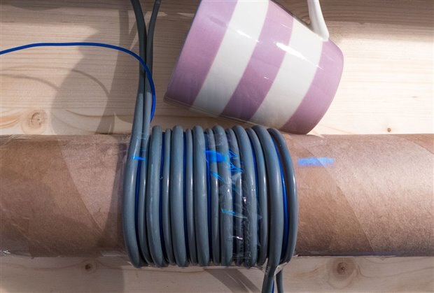

    I thought about it some more, and the point mcb1 mentioned of being able to do comparative tests, and constructed this thing (coffee mug for size comparison):
    It is three windings around a poster tube basically, with the centre wire being the source signal (the 1kHz rate switched 2A), and the other to being the two cables to be compared (the two Belden cables I had).
    One end of each cable was shorted. The other end went to the radio antenna (the shield going to the ground connection of it, and the inner conductor going to the antanna input. I could hear a tone (radio tuned to 20kHz) but the strength readings (S-meter) were slightly different with each cable. The 9533 cable provided a strength ('S'-value) of 4.8 and the 9841NH had a value of 4.4.
    So, there is a difference, but so tiny that I need to improve the test method. Furthermore not only is the difference tiny but the signal is tiny too. I could dispense with the radio, and use an op-amp to amplify the signal, and then maybe even a peak detector before measuring with a voltmeter.
    Also I need a lot more cable to get more turns (I only had these short lengths), and a more controlled testbed in general, I had wires all over the place.
    So, in summary I think it is possible to compare cables this way, but needs a much nicer testbed created.

    shabaz over 10 years ago in reply to mcb1
    Thanks mcb1 and Problemchild for all your ideas and support - I'm glad I'm not alone in trying to figure it out!
    I should have mentioned (it was late while I was typing : ) the intent behind this test was to do with the article in michaelkellett comment that mentions how a shield can in certain cases (low frequency) be less effective against signals that are
    due to changing magnetic fields. (i.e. particular relevance for unbalanced audio since it means we can't rely on a pair of wires to cancel it out).
    The foil shield seems to be very effective at shielding against RF pickup as seen in the earlier test. This modification was to create more inductance and coupling, i.e. to get transformer action. Basically in the hope to see enough of a measurable signal received via transformer action.
    The plan was to get as much flux change as possible, hence the coupled coils to make it one physically large transformer, and air cored only due to the physical size of the cables not leaving many options on the table.
    The end aim would be to avoid testing at harmonics and just use an op-amp amplifier and voltmeter on the secondary (the cable under test). The radio has given me confidence that some signal is being picked up, although it is tiny (at least at that harmonic).
    Problemchild the technique where the cables could be parallel, using the poster tube to keep it a fixed distance away from the centre (which would be the source signal) is pretty good. Basically still a coupled inductor, but the inductors are now smaller and this technique actually ends up being very close to the one mentioned in an IPC test method paper, but that paper is for testing up to 4GHz. For the audio scenario, since we're only testing at a far lower frequency, we could provide better transformer action with coupled coils, and just use an op-amp circuit to measure the inductively coupled noise, i.e. not far removed to how it would be observed in the field, with an audio amp. Just here we can match the inductance for two cables by the triple wound coil (or the parallel system that Problemchild proposes, for comparison purposes. The coil is just a small inductance (about 10uH with the coil I have now - approximate calculation) so transformer action is not great, but hopefully enough for an op-amp circuit to then provide a measurable signal.
    But I do need to start again with a better testbed, because with wires all over the place I won't be sure all things are equal and there may be pickup from unshielded ends for example. Maybe I need a big shielded test box (biscuit tin?) where the ends of the cables are plugged in, and it to contain the amp circuit and the MOSFET circuit, separately shielded. Not sure! Hopefully we can refine it and eventually use it to determine some useful price-performance cables to use..
