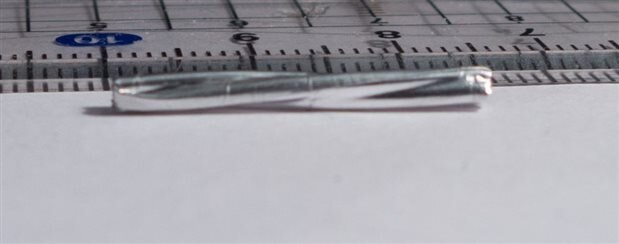

The Belden 9533Belden 9533 is a 4.1mm thin cable with three cores and a foil shield with an associated bare wire (called a drain wire) and is primarily intended for RS-232 use. The 9841NH9841NH has two cores and a braid and foil shield. It is thicker (5.9mm) and physically tougher. It is overkill for home audio applications but I liked it because it could also be used for non-audio applications. It is primarily intended for RS-485 signalling.
It should be noted that these cables are actually even better constructed than their datasheet description : ) The 9533 cable is not a controlled impedance cable but nevertheless the three conductors are tightly held together in a consistent intimate configuration in their foil shield as seen below. Also the foil shield is nicely folded on the outer edge for very effective 100% coverage.
The 9841NH 9841NH also has a similar folded foil shield but it is also covered with a 90% coverage braid surrounding the foil shield making the cable better screened at lower frequencies and providing physical resiliency.
Also the 9841NH does have a controlled impedance pair of wires and filler material is used to keep the wires in formation. We don’t actually care about the impedance, but we care that the two wires are consistently intimate with a twist, so that any noise signal that is picked up will be common; it will therefore be eliminated in a balanced audio configuration. The 9841NH would be superb for balanced audio applications as a result.
