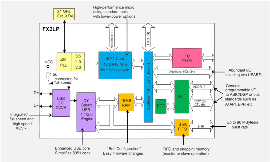

Cypress FX2LP
Due to short time to design this project (schematic and PCB layout were completed in one day), I used Cypress Semiconductor’s FX2LP technology because it simplifies high-speed data transfer via USB. FX2LP chips contain a very basic microcontroller, but includes a USB accelerator function that bypasses the processor and allows for data to be shuttled between input/output pins on the chip, and the USB attached host, extremely rapidly. The FX2LP chips work at USB 2.0 High Speed (480Mbit/sec) rates.
(Image source: Cypress website)image
There are also FX3 chips which operate at an incredible 5Gbit/sec (USB 3.0), and I’d like to explore them one day.
Such a design requires the actual protocol decoding to be done on the connected computer. I liked the idea of having some basic, general-purpose hardware that could be attached to any PC, and have the bulk of the processing done on the PC. It should also work with a Pi, for portable, battery-powered use and possibly long-term logging too.
Incidentally, the commercial Saleae logic analyzer uses the same FX2LP chip (I do not own this device, but there are photos of the internals on the web). The Saleae device contains the FX2LP chip and little else. Anyway, it is likely compatible, if the firmware is available. I’m personally more interested in creating new firmware eventually, with the extra features mentioned above. Today, with no firmware or software written for it, it is nevertheless supported by the open source Sigrok/PulseView project, with no extra work, because many logic analyzers use the same chip.

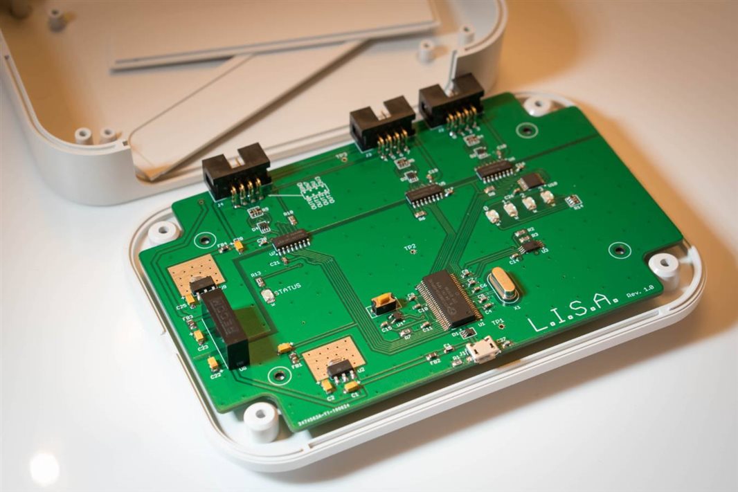

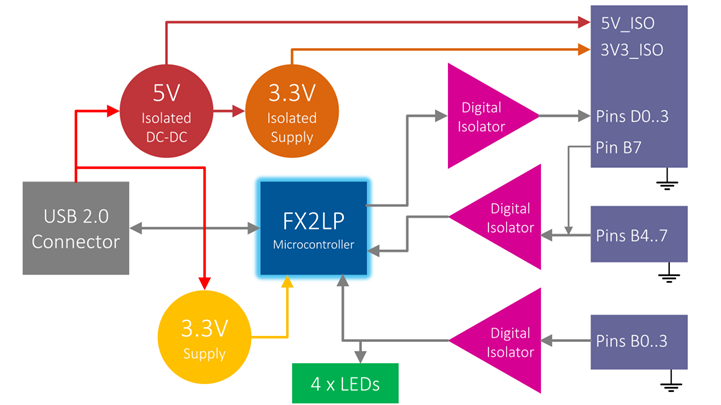

The diagram below shows the functionality on the board. It contains a total of 8 input ports, and 4 output ports. LISA version 1.0 supports 3.3V logic levels only, although it will tolerate 5V on the inputs. Isolated 5V and 3.3V supplies are exposed on a connector, so that LISA can power up some externally attached equipment if necessary.
Everything on the board is hand-solderable with an iron (no need for reflow tools), so this should be an easy project to construct with the minimum of tools.
The project is expandable too; instead of using right-angle header pins, it is possible to use vertical pins, and plug on a board on top, which could (say) expose input/output at different logic levels such as RS232.

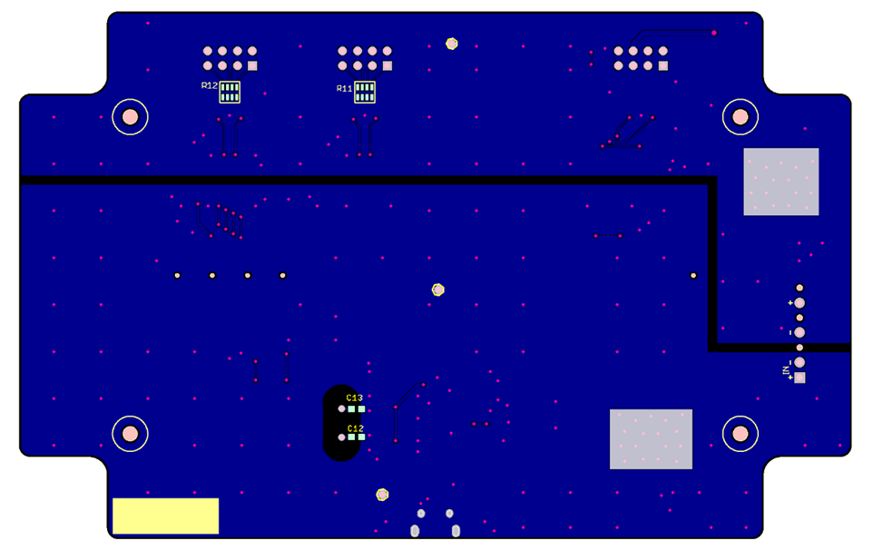

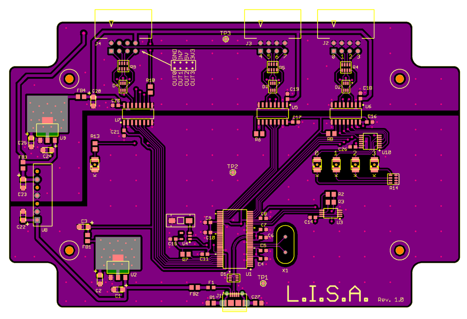

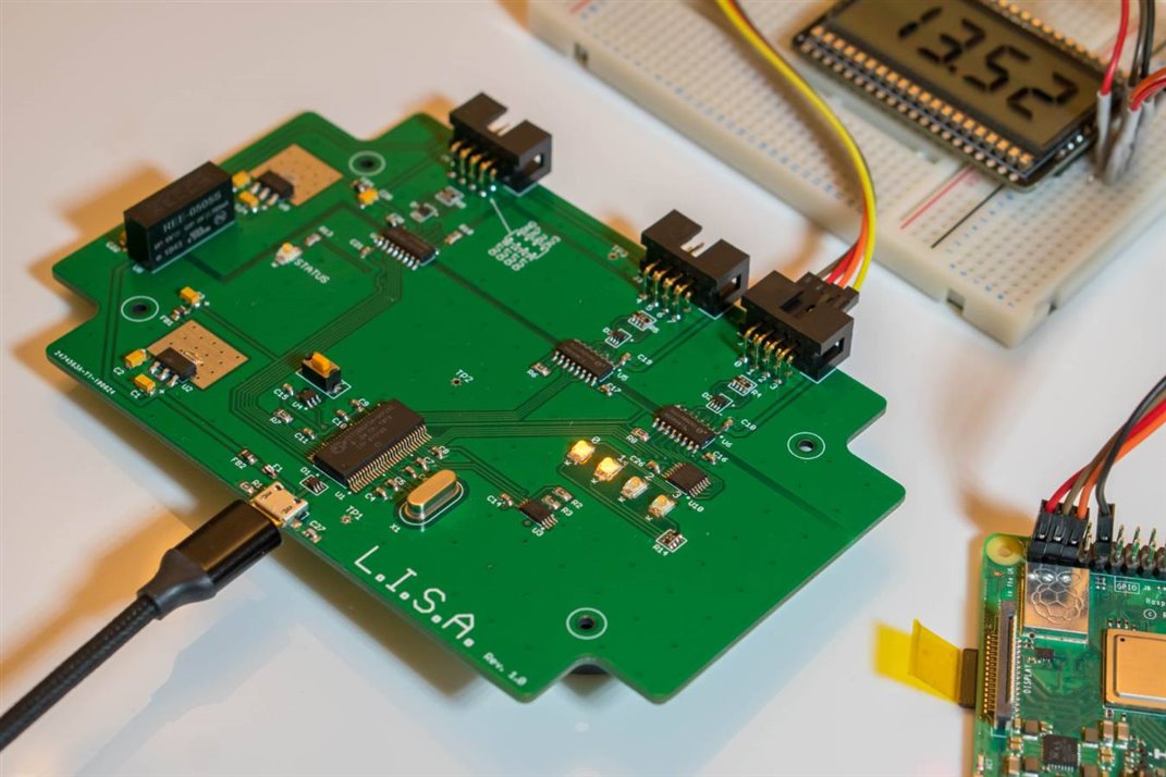

The PCB files are attached to this blog post, ready to be sent to a PCB factory. It is a 2-layer board, 142x90mm. Everything can be hand-soldered with a small-tipped (around 1mm) soldering iron.
A few of the parts need some thought due to the size of them. For the micro USB connector, I put a small dab of solder paste on the pads, and then placed the connector on the board, and then heated the pins. It’s quite easy. I used solder paste in a similar way for the LEDs. Everything else was soldered as usual with thin (0.274mm) solder wire.
The diagrams here can be used for locating the components on the board.
Board underside:

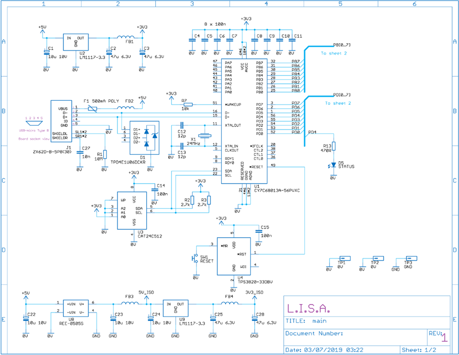

Here is the schematic (click to enlarge), sheet 1 of 2:

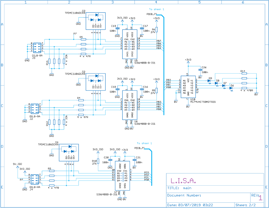

Sheet 2 of 2:

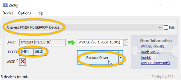

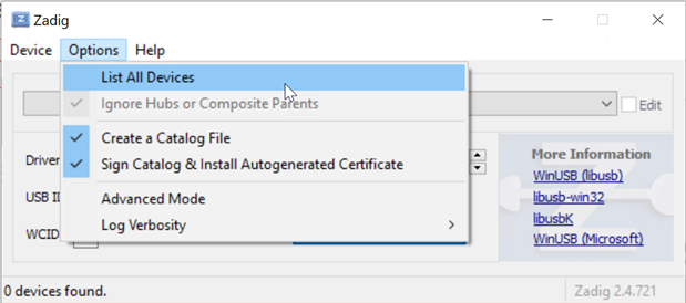

As part of the installation, the software will also install a utility called Zadig which is used to associate a particular driver with the Cypress chip. Run that utility, and plug in LISA. Click on Options -> List All Devices, and look for the USB device with the name Cypress FX2LP No EEPROM Device.
It should have USB ID 04B4 8613. Once you’ve found it, click on the button labelled Install Driver, or Replace Driver (it depends on if there is already some driver on your PC that needs to be overridden). Once you’ve done that, Zadig freezes for about half a minute and then displays a success message.
Now Zadig can be closed, and it doesn’t need to be used again.

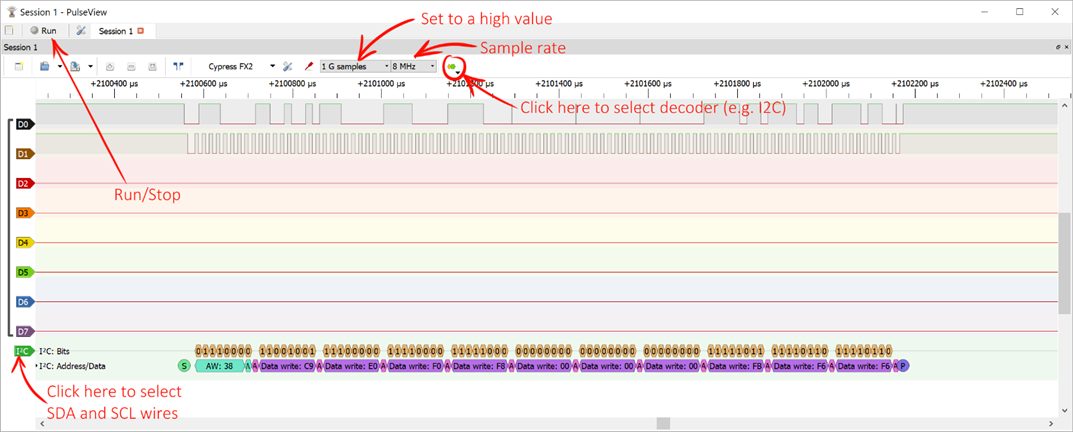

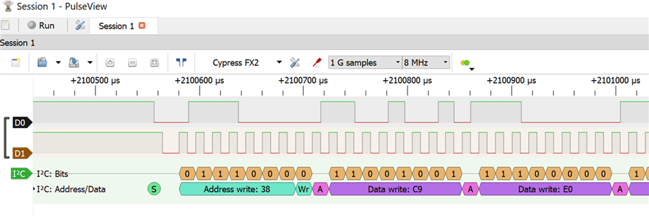

To use the logic analyzer, run the PulseView application. The screenshot below shows what it looks like.
Note: If PulseView generates a Failed to open device error, then there is a chance that you've got other devices that use the same Cypress chip, that you've in the past installed on your PC. I don't know of a solution except this one: uninstall the device from the Windows Device Manager, then unplug the device, then go to the C:/Windows/INF folder, and using a text editor that can 'Find in Files' (an example text editor is Microsoft Visual Code) and search for the text FX2LP. You'll find some files such as (say) oem1234.INF that contains this text. Delete all such files, as well as any corresponding .PNF file. Then, plug in the device and run Zadig and follow the steps as described earlier.
That screenshot was obtained by using LISA to examine the I2C bus from a Raspberry Pi, connected to a LCD module. The LED lights come in handy, to confirm that connections are made properly. The I2C bus is at logic ‘1’ most of the time and so the two LEDs are lit.
