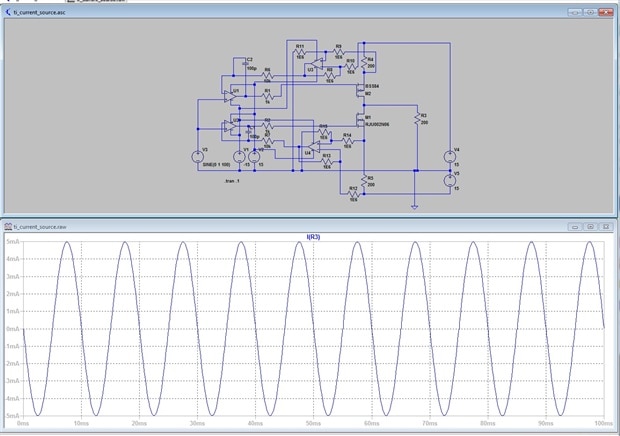

    I don't think that TI are telling the whole story with their diagram of the current output of the DAC8775.
    As they draw it (page 35 of the data sheet)
    considering just the lower or sinking half:
    Iout = -(DACvolts - VNEG_INx)/Rsense, so the sink current is a function of the difference between the negative supply and the DAC voltage.
    And worse, at zero DAC volts both amps will be trying to turn their MOSFETS on enough  to drop the full rail voltage across their sense resistors.
    You could fix this by using a diff amp to look at the voltage across Rsense.
    If jc2048  is reading this is right up his street for simulation.
    The problem is that with two diff amps this circuit needs 10 precision resistors to work.
    Here's a very quick and messy LTSpice of it, with diff amps, can't make it work without.
    The classic Howland current source (TI app note snoa474a) only needs 4 precision resistors.
    MK

    Yes, just shopping for ideas at the moment, browsing, reading and collecting. I'm fully aware that the drawings and text in the TI application note are a vast oversimplification.
    I'm also looking at your circuit and the way you approach building for performance and precision.
    They don't show it in the drawing, but in the operating narrative they explain that they never drive both outputs: "Only one of the current stages are active at any given time".
