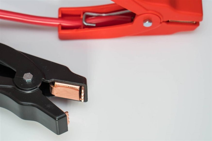

Adapter Cable
The car battery adapter cable consists of a couple of really nice alligator clips (with lots of surface area and sharp teeth), 8AWG 200 degree C rated cable, and an adapter connector box with some circuitry.
The adapter box connector has three terminals, but only two are used – the center one is not connected inside the adapter box.
The construction of it all looks really nice.
The alligator clips have the wires terminated extremely close to the jaws, to minimise resistance presumably. Interestingly, the red cable actually contains two separate wires. One is thinner, and goes to the opposite jaw on the alligator clip, so that the circuitry can know if the jaws are touching each other, and to measure the battery voltage. This is part of the protection functionality.
In the photo below, you can see the thinner red wire in the alligator clip.
