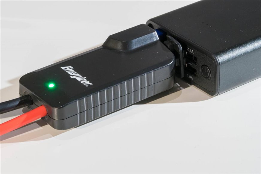

The supplied red and black clips for the car battery are connected to a separate housing that plugs into the main unit (there is a connector under the rubber flap for it). An LED light indicates status.

Using it is extremely easy, no power buttons need pressing. Just connect the red and black clips to the car battery, and the other end is plugged into the connector beneath the rubber cover. The LED stays lit green if the connection is ok. Then, just start the car! Once it is started, the clips can be disconnected.

The car battery adapter cable consists of a couple of really nice alligator clips (with lots of surface area and sharp teeth), 8AWG 200 degree C rated cable, and an adapter connector box with some circuitry.
The adapter box connector has three terminals, but only two are used – the center one is not connected inside the adapter box.
The construction of it all looks really nice.
The alligator clips have the wires terminated extremely close to the jaws, to minimise resistance presumably. Interestingly, the red cable actually contains two separate wires. One is thinner, and goes to the opposite jaw on the alligator clip, so that the circuitry can know if the jaws are touching each other, and to measure the battery voltage. This is part of the protection functionality.
