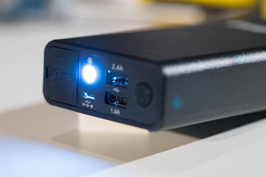

Double-pressing the front panel button turns on the torch feature!
However, it’s not a very good torch. The beam spread is huge (almost 180 degrees) and it is not very bright either. Even your mobile phone camera torch feature will be much brighter. It’s a real shame, I would have loved for the torch to be brighter so that it became a genuinely useful feature.
Battery status can be observed through four pin-*** sized holes – very hard to see off-angle.
