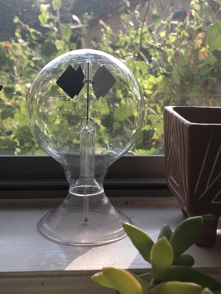

    genebren over 2 years ago
    Here is my radiometer. This little guy has had a spot near the window for over 30 years.  On a bright day, in direct sunlight this thing will really spin.

  • beacon_dave
    beacon_dave over 2 years ago in reply to genebren
    Sounds like an opportunity for an optical tachometer project.
    Although the white/black vane variety might be better for that than the curved vane black/black ones.
