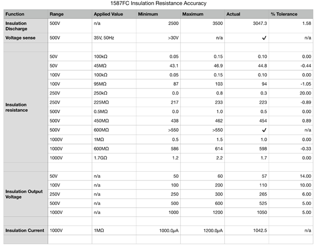

Insulation Resistance
Insulation Resistance Tests
These tests verify the resistance reading values, output voltage levels and current source level across the various ranges. Prior to any tests carried out enthuse functions, the resistance of the discharge circuit is verified along with the voltage detection cutout.
Accuracy levels are reasonable for an insulation tester. The lower resolution, in comparison to other testers looked at, impacts on the tolerance results for lower resistance values measured.
Voltage outputs were all within the +20% tolerance specified by Fluke and the 1mA load current tested on the 1000V range is satisfactory to the IEC standard.

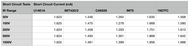

Highest loading on the battery was during a 1mA load test on the insulation testing function. At 0.815W load, this is lower than the other units that all take around 1W during this test. The wireless function also drew quite a low load. The backlight load is typical compared to other units.
The next set of tests centred around the accuracy of the insulation testing function. Due to the low maximum insulation value, only 91 tests could be performed, against the 200 tests for the Keysignt, Megger and Chauvin Arnoux units. The number of tests for the Fluke is actually lower than the reduced 100 set of tests for the Flir IM75 insulation tester.
As with all the testers, the accuracy measured far exceeded the manufacturer's specifications for all of the ranges. With the Fluke, there was a fair amount of deviation noticed between the different test voltages, not seen on other insulation testers. Overall, the accuracy over the 91 tests averaged out to a very respectable -0.13%.
