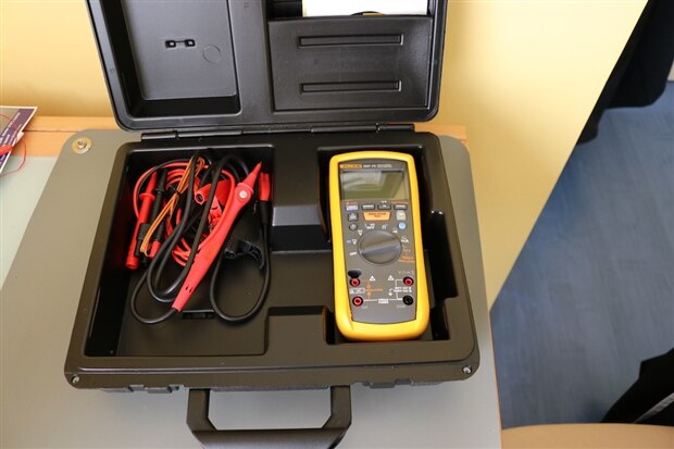

The 1587FC comes in a black hard plastic case, with the Fluke logo on the lid, the case is covered with a cardboard advertisement sleeve. Opened up, the meter and leads arrived packaged in separate plastic bags. Emptied out, reveals the full list of contents to be the meter, a set of silicone red and black test leads accompanied with red and black probes and crocodile clips. A temperature probe and remote trigger probe complete the items to use with the meter.
Paperwork wise, for me there is a lack of a calibration certificate, instead there is a quick reference guide, a download guide card for the manuals and software, a safety booklet, a CD ROM containing the manual for the meter, a paper supplement for the manual and finally a Chinese market notice. The plastic case contains a guide pocket in the lid where all of these can be neatly stored and carried around with the meter.
This leaves three large open cut outs to house the meter and the leads. It gives plenty of room for storage but also allows for components to become mixed together very easily and rattle around. I am aware that the 1587FC is available in optional kits along with a current clamp and phase rotation meter, so I presume the case is moulded to allow these extra items to be added. Without them, I see the need for tool foam to be added to allow the accessories to be stored more securely.
One element missing for me is the lack of a calibration certificate for the instrument. However, as with the majority of Fluke instrumentation, a service manual is available for download from Fluke that contains the performance checks and calibration procedure. The performance checks are quite extensive and interestingly for me, contain a procedure to test the operation of the test circuit discharge function. This is something that I have not seen in a calibration procedure for an insulation tester before, and I must say that I do like it.

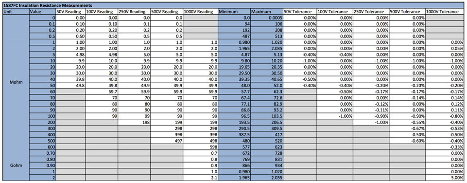

These tests verify the resistance reading values, output voltage levels and current source level across the various ranges. Prior to any tests carried out enthuse functions, the resistance of the discharge circuit is verified along with the voltage detection cutout.
Accuracy levels are reasonable for an insulation tester. The lower resolution, in comparison to other testers looked at, impacts on the tolerance results for lower resistance values measured.
Voltage outputs were all within the +20% tolerance specified by Fluke and the 1mA load current tested on the 1000V range is satisfactory to the IEC standard.

The next set of tests centred around the accuracy of the insulation testing function. Due to the low maximum insulation value, only 91 tests could be performed, against the 200 tests for the Keysignt, Megger and Chauvin Arnoux units. The number of tests for the Fluke is actually lower than the reduced 100 set of tests for the Flir IM75 insulation tester.
As with all the testers, the accuracy measured far exceeded the manufacturer's specifications for all of the ranges. With the Fluke, there was a fair amount of deviation noticed between the different test voltages, not seen on other insulation testers. Overall, the accuracy over the 91 tests averaged out to a very respectable -0.13%.

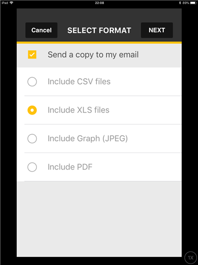

Saved readings can be exported via email in one of four formats, only one format at a time can be selected. For an insulation measurement, the app saved three to four readings per second. For me, this is excessive, for a DAR reading over 250 measurement values are recorded in the Excel file, for a PI reading this increased to over 2200. This means that to get a sensible data table to enter into a report, a bit of Excel data manipulation is required.

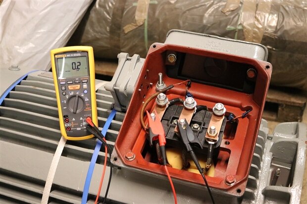

Back in the motor store at my favourite 90kW motor, it was time to see how the 1587FC would perform at the terminals of a real motor. First test a winding balance check using the resistance function of the meter.
No real problems found with taking the readings, as expected the meter read high against the other instruments due to the lack of resolution on this function and the inability to zero the leads. When measured with the Keysight, the phase winding resistance was circa 0.055Ohms, but the Keysight has more resolution on the resistance range, a 200mA test current and a lead zeroing function. At the end of the day, the readings were all balanced when measured with the Fluke, so the test can be seen as successful in my opinion.
One minute insulation resistance tests were then carried out at both the 500V and 1000V ranges on the 1587FC. Initially, I made a slight error taking the measurement - using the wrong input jacks on the meter, it took me a little longer to realise as I was expecting the meter to go over-range on the 500V setting. On this occasion, there is no immediate safety issue, as I used the voltage input jacks and the motor terminals are obviously dead anyway. An issue could have occurred if the motor did have a fault, as I would have missed it and could have installed a faulty motor. The error is nothing more than down to me used to using the voltage terminals of an instrument to carry out an insulation test.
With the correct terminations on the meter utilised, the test was repeated. As seen in the second picture the meter goes to over-range during the test and then at the end of the 1 minute produced an error message and cannot display a DAR value. This is because the motor has an insulation resistance of circa 4GOhm, which is above the range of the 1587FC.
The same outcome was seen when the 1587FC was switched to the 1000V test range. Although this extends the reading capability of the 1587FC up to 2GOhms, this is still inadequate for this particular motor, and the same error message was seen.
