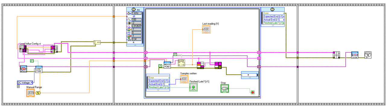

What I find most annoying is that despite telling it I was a perfect noob at this, it failed to explain LabView’s base concepts, the most important one being that everything runs at the same time (on every system tick?), even if the “boxes” are connected. This is perfectly counter intuitive to people like me with a developer background.
In the end, I got a set of VI files, with a “master” one that links to the others in what I find a very convoluted way for something that I believe has to be quite simple:

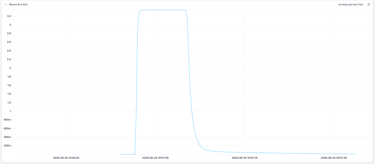

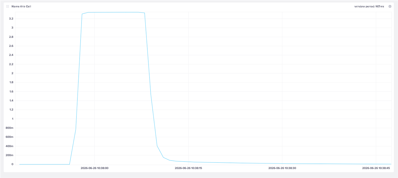

A seasoned LabView user would most likely have done things in a simpler or clearer way, but at least I now have values in InfluxDB and can display them in a dashboard like this:
The value does not appear to overshoot the programmed value, but it did not feel right that the graph is so “jaggy” with this broken lines aspect.
As it turns out, the issue was not with the reading frequency in the LV project but just with the way InfluxDB displays values in a dashboard.
Basically, it always “groups” values in bins and uses the aggregation value of each bin as the point in the graphic. As you may have noticed at the top right, this is the “window period” and in the above case, its length is 167ms, automatically computed according to some heuristics that I have no idea about.
But this is configurable in the dashboard and with a setting of 1ms, it gives this smoother image:
Still no sign of overshoot which is quite reassuring.

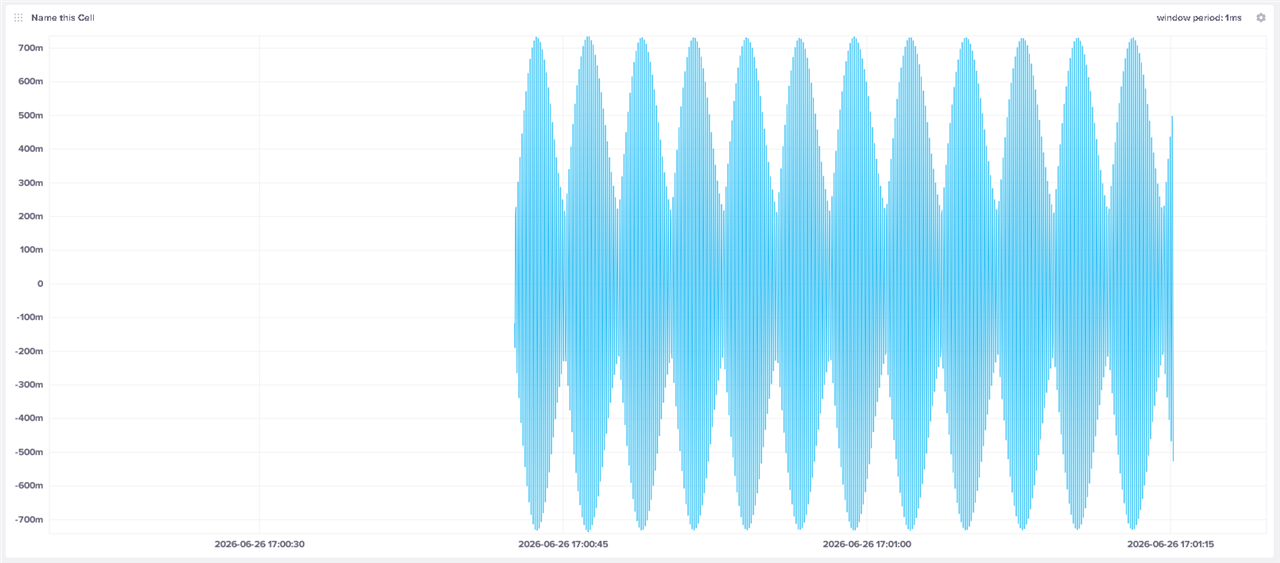

And with this I am now able to “see” the noise that gets picked when the leads are left floating:
I’m not sure where it’s coming from exactly, but with so many electronic gadgets around, it’s not surprising to see this.
