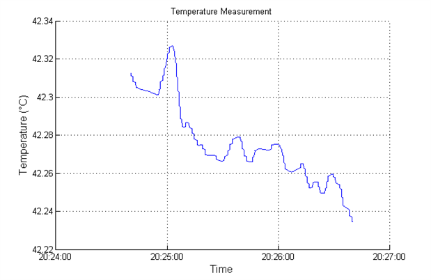

The graph below shows the temperature of an idling CPU(Raspberry Pi 3 over a period of two minutes the resolution is under 1/100 of a degree C and time resolution was 100msec due to the high speed capability of the  I used a tiny thermistor with extremely rapid response time The temperature was calculated in real time based on the measurements from the  U1282AU1282A
The MATLAB software to retrieve data from the  U1282AU1282A is available here. It uses SCPI commands to capture data and plots it to a graph.
The short video below (there appear to be rendering issues; try YouTube) shows it all in action during power-up of a Raspberry Pi 3 You’ll notice how rapidly the temperature rises towards the end The specific details of that are the subject of a 30-minute video which is needed to do that justice For now the important thing is how easy it was to control the  U1282AU1282A with MATLAB and perform math equations on the fly before graphing the results

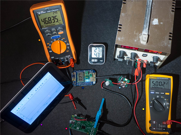

Next I wanted to combine the data from the  along with other data captured within a test bed I had a test bed that I had built for monitoring power consumption by the Pi 3 It was easy to include the  U1282AU1282A and simultaneously show real-time temperature voltage current and power all on the same display As useful as MATLAB is this time it was decided to go open source I used a kst application to do all this.
It was tested and it all nicely runs on another Pi 3, so for remote data capture there is no need to dedicate a PC to it.
The test bed I had created for measuring the Pi’s power consumption benefitted greatly from the  integration I could finally measure multiple things in a single session and see the effect and interaction of each one If I had multiple  multimeters I could rip out my home-made test tool which won’t have a guaranteed specification unlike a multimeter not important for this particular test but very important for commercial tests Still for now the  U1282AU1282A integrated seamlessly with my existing test bed From top-left clockwise in the photo above you can see
Orange Keysight  U1282AU1282A performing thermistor measurement
Dark blue: Custom ADC board performing voltage and current measurement
Light blue: Current sense resistor
Unmarked: Bench supply powering the device under test
Yellow: Fluke 175 for voltage confirmation (not playing a part in the data logging/monitoring)
Pink: Device under test (Raspberry Pi 3)
Purple: Another Raspberry Pi 3 (and touch screen) performing all data capture, math conversions and real-time graphical reporting

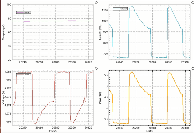

The graph below shows some typical output; clockwise from top left you can see temperature, current, power and voltage. All of this updates in real-time (10 captures per second) indefinitely.
To achieve this, I made some changes to the fastlog application devised for the previous blog post. The main change is to provide an equation capability (the graphical tool also has equation capability but I felt it to be easier to implement it in my code). It can still run in the normal mode, for example:
