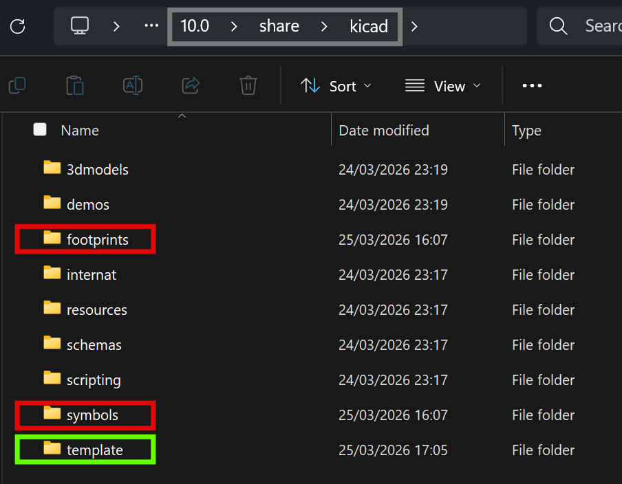

KiCad creates a folder KiCad\10.0\share\kicad during installation.
Within that, there are footprints and symbols folders, and within those are a load of yet more folders, one for each library. In other words, each library is a folder (this wasn't the case in older KiCad versions, but it is in the past few KiCad versions).

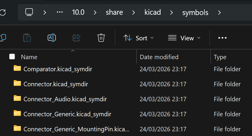

For instance, here is some of the content in the symbols folder:

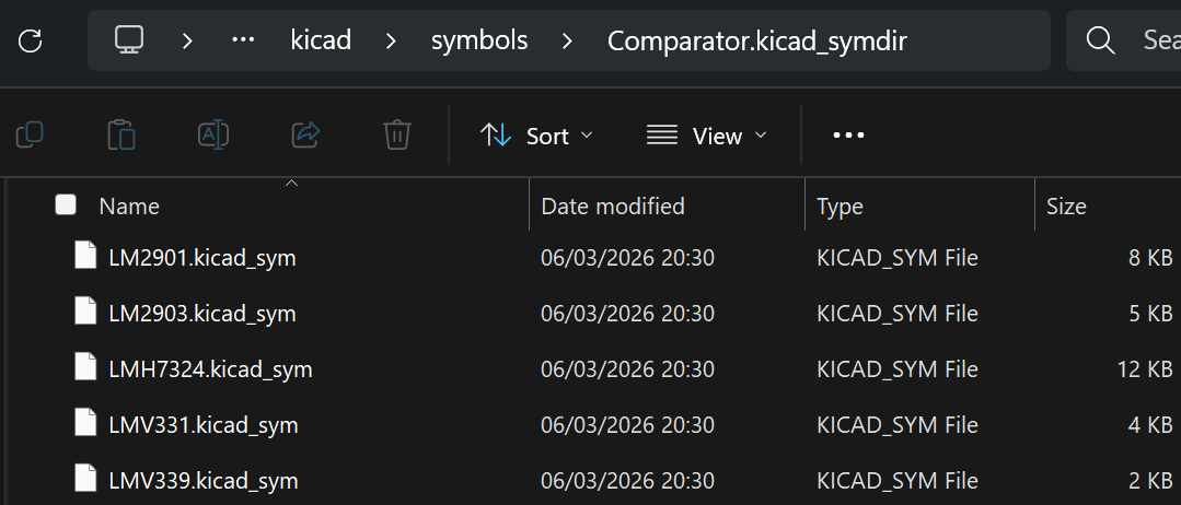

Clicking on (say) the Comparator.kicad_symdir folder reveals files, one per symbol:
There are hundreds of libraries, and KiCad maintains a list of them; two lists actually, one for symbols, and one for footprints, called sym-lib-table and fp-lib-table, respectively. They are stored in the template folder highlighted in green in an earlier screenshot.

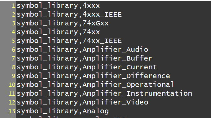

With some AI help, I created a couple of Python programs. One program will read the two files and save a list of all libraries in a simple CSV format to a file called lib-list.txt, which looks like this:
Then, using any text editor, I can delete line entries for libraries I do not care about and save the file with a name such as desired-lib-list.txt.

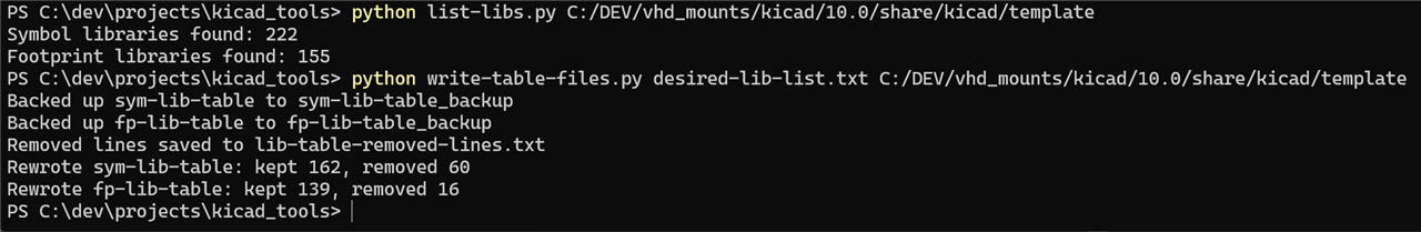

python write-table-files.py desired-lib-list.txt C:/DEV/vhd_mounts/kicad/10.0/share/kicad/template
That was all I needed to do. Here is a screenshot of the commands and their output:
Next, I started up KiCad, opened an example project and schematic, and that consumes about 2.7 GB according to Windows Task Manager. Then I clicked Tools->Assign Footprints, which usually results in a short delay while the footprints are loaded into RAM. It was noticeably quicker. Also, Windows Task Manager revealed significantly reduced RAM usage by this stage (4 GB, i.e., a 20% saving of that resource).
