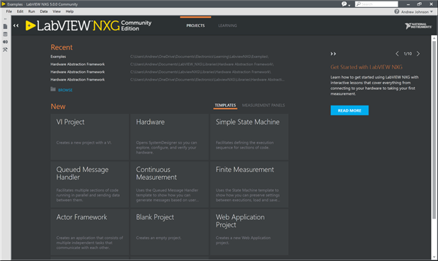

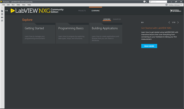

Launching LabVIEW NXG, you are presented with a home page from where you can create a new project using an existing template or take a look at lessons and examples to get to grips with the tool.
(Templates to choose as the basis of your own projects)
(Built in lessons and examples for learning how to use the tool and program with LabVIEW)
I'm not going into detail for any of these as it's way beyond the scope of this review.  Suffice to say, the lessons and examples are worth following if you are new to LabVIEW NXG - especially given the frankly outrageous price of NI's underwhelming tutorial videos - as they go through many aspects of programming and interacting with test instruments.  The templates give excellent starting points for your own applications although many of them I would categorise as 'advanced' so shouldn't be used until you have a better grasp of developing your own VIs.

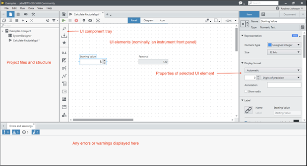

Panel View
This view of the project shows the 'Panel' of the VI that you have open, in this case the Calculate Factorial VI. The panel nominally represents the front panel of an instrument (the above doesn't) and might consist of a variety of UI components, including data values, buttons, dials, switches and so on.  It's a bit of an obtuse metaphor really as it really represents the data and interaction elements for your VI.  This example is very simple, consisting of just an Unsigned 32-bit integer that a user can enter a Starting Value into, and an Unsigned 32-bit integer that can display a calculated factorial.  More complex panels will consist of booleans, arrays, constants, switches (actually, just boolean data types) and so on.

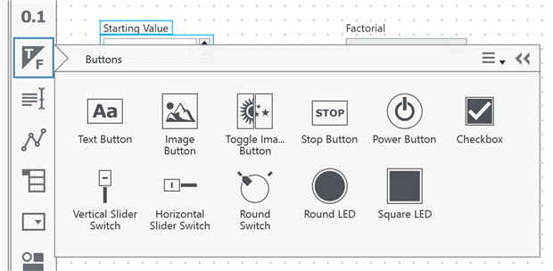

The UI component tray is used to drag elements onto the Panel - when you click on one of the symbols a 'drawer' opens given you access to elements.  The properties tray on the right is used to configure an element - in this case, you could select a Double, Float, Signed Integer etc, give it a default value, max and min values and so on.  At face value, this is similar to how you might create a UI with something like Visual Basic but these elements not only represent a possible UI they are also the 'variables' and 'constants' you might use in your program.  To clarify further, look at the Boolean options which are represented as buttons:
(Buttons - boolean data types - available to place on the UI)
These represent a type of physical button that can be pressed but all are essentially boolean variables to your program: on/off, ticked/unticked, lit/not lit etc.  LabView may also give these additional functionality under the covers - e.g. a button may be configured to operate as a momentary switch, or to be 'true' when released etc.
It's pretty clever really, works well in terms of not only creating a UI but representing those elements as variables which operate in a way you may find on an instrument's front panel, and available elements are comprehensive enough.  It's possible to create reasonably complex UIs:

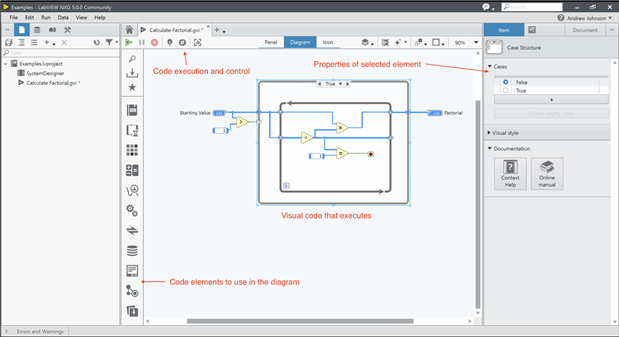

Diagram View

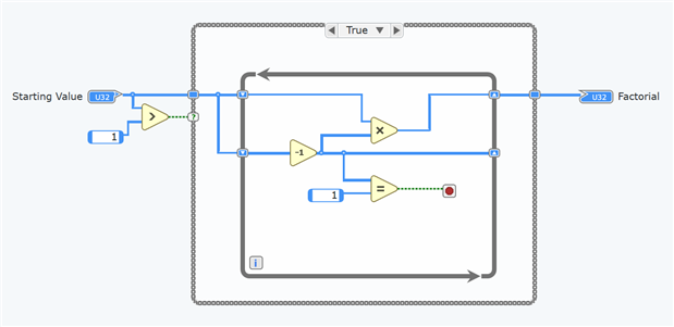

The detail view is where you write your code.  Elements dropped on the Panel View can be dragged onto the workspace to be used in your program:
Here, you can see I've dropped the two Panel elements onto the workspace and have created the factorial calculation by accessing code elements from the left-side tray.  Some elements can be configured further using the panel on the right - here, the Case structure shows two options - False and True - but I could add more.
By convention, programs are 'written' left to right but it's LabView that controls the actual execution based on data flows - when data can flow, it does so!  This is a fairly simple VI and I'll explain the elements:
  • The Starting Value panel element plus a constant '1' is connected to a > comparator element (is Starting Value > 1).  The blue lines are integer data flows: in fact, in this VI they are all blue but they are coloured by data type and have different appearances depending upon data type as well.  An array of Integers would be a thick blue line rather than the thin blue line seen here.
  • Starting Value is also connected to the 'square' labelled True at the top, as is the result of the comparator.  This square is actually a Case structure (selected from the tray on the left and drawn onto the workspace.) You'll notice the blocks at the end of the data flow - these are called tunnels as the data values are passed (tunnelled) into the structure.  Because this is visual programming, it's perfectly possible to draw a data flow straight across that structure without it passing in which will be obvious because there are no tunnel blocks.  The comparator output connects to a tunnel marked with a '?': this represents the Case structure options - True and False for a boolean, but, say, for an enumerated data type it would generate case options for each possible enumerated value.
  • The Starting Value passes straight into a While Loop structure which will execute until an exit condition is reached, represented by the Red circle on the right side.  This is connected to the output of an equals comparator which will output true when a decremented value equals 1.
  • The tunnels that are marked with a triangle just represent data passed around the While loop: the output of the multiplication element loops around to become the input on the next iteration as does the output of the decrement.
  • When the While loop terminates, the final calculated value passed out to the Factorial Panel element.
I think this is simple enough for you to get the idea even if the explanation isn't that clear (sorry.)  As LabVIEW NXG is a visual programming language, then you'd be right in thinking that there are lots and lots of these programming constructs.  To put it into some better context - think of the keywords available when writing a Java, C, Basic etc program: each of these has its own visual element in LabVIEW NXG (as well as library VIs.)

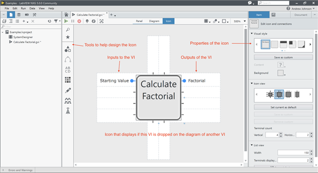

Icon View
This view is used to configure how the VI is interacted with when used as a sub-VI (i.e. embedded in another VI.)  Like the elements you saw in the Diagram View, such as decrement, it has a visual look, points to connect inputs and points to connect outputs. Here, the Calculate Factorial VI has been defined with the Starting Value as an input and the Factorial as an output.  If I was to drop this onto, say, a calculator VI as a function, then the value entered on the calculator could pass in to this VI when the calculator's '!' button was pressed and the Factorial passed to the calculator's display value.
Again, I'm sure you get the idea.  This is quite a plain icon but the facility exists to jazz them up and the icon can be sized to have any number of inputs and outputs.

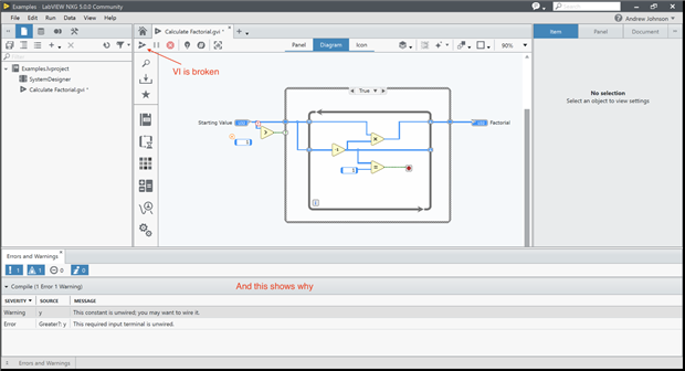

VIs are run by clicking on the green triangle above the Views (refer back to the Panel View.)  Being a green triangle the VI can run: if it is a black, broken triangle there are errors to fix in the VI execution chain somewhere:
Like any other programming IDE, LabVIEW NXG allows the debugging of VIs using breakpoints, stepping, data inspection and so on.

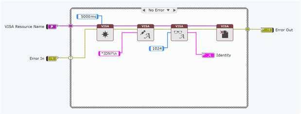

  • On the Panel View, add in a Session Control and a String Indicator
  • On the Design View, create the program: open a VISA connection to the Instrument selected in the Session Control, write a command, read a response and load it into the String indicator, and then close the session.
  • Run the Application

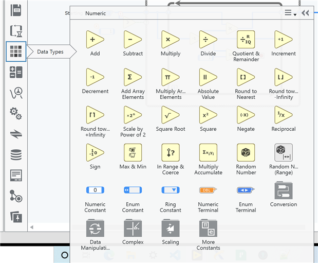

(Programming elements for Numeric data types)

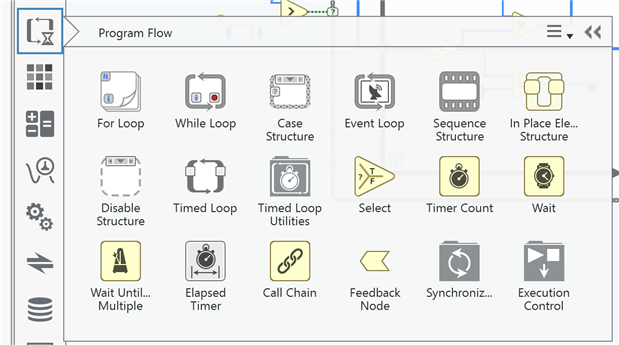

(Programming elements for program flow of execution - to the extent that LabVIEW NXG allows that!)
These are just dragged out of the tray and then wired up with data flows.

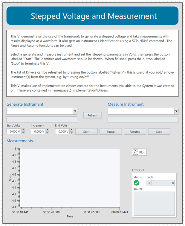

  • LabVIEW NXG Community Edition: Post 2 - Hardware Abstraction Framework. A framework that encapsulates functionality for sending commands to Test Instruments and dealing with the responses.  Your test application just needs to inject the needed commands.
