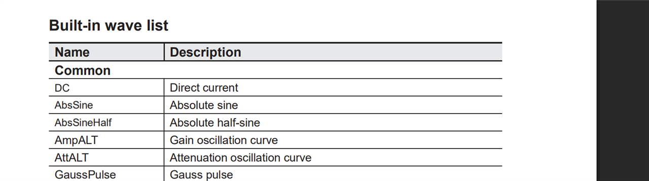

    Jan Cumps over 1 year ago
    Looks like it has a DC arbitrary waveform:
    Ideal if you need a DC signal (bias, offset, reference, ...) for a test setups. Because this instrument has way better resolution than most programmable DSUs.
    shabaz over 1 year ago in reply to Jan Cumps
    I just gave it a try, in high impedance setting, it is configurable for -10.000 to +10.000 volts, not completely linear (varies up to maybe 5-6 mV in this quick test at some spot values) but still very useful, and as you say, better resolution that many programmable power supplies.
