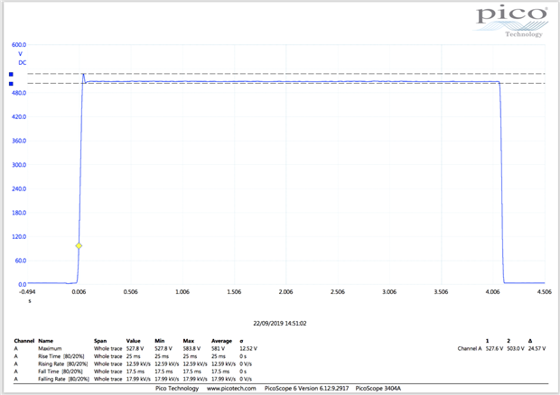

The initial trace of the output curve on the 500V range showed a very fast rise and fall of time, the fast 25ms rise time leading to a little overshoot on the output voltage. This is a trait I often associate with the cheaper insulation testers, that have a poor voltage regulation in comparison to the more expensive units that have a slower more controlled voltage rise in the region of 200 to 300 ms with little or no overshoot.
Applying a 10Hz filter to the signal allowed a fall time to be captured, coming out as 17.5ms. This parameter is not as important as the rise time and overshoot as the type of electrical items tested are not susceptible to fast voltage drops.

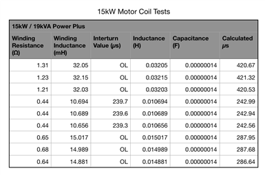

Motor Tests
More motor tests were carried out with the MetraHit, mainly to investigate the functionality of the Coil Test, rather than the insulation test, as it was already apparent that this element was substandard.
The coil test is another test carried out with the motor isolated from its energy source. It utilises a small extra test box connected between the MetraHit and the motor under test. As the box comes with its own test leads that plug into the MetraHit, the test leads from the MetraHit are used from the test box to the motor.
Another slightly bemused scenario occurs. The operators manual for the MetraHit includes the warning below, that the tests should be carried out using crocodile clips and not to hold the test probes onto the motor - shame they didn't supply some crocodile clips with the package then.
I have a variety of motors to use the coil test facility on. The manual indicates that the standard 'Coil Test' adapter supplied is suitable for use on motors with an inductance between 10 uH and 50 mH at 100 Hz. I do not find this much use, as the inductance of a motor winding is very rarely known. It could be measured of course, but that would mean another meter. A look at the data sheet provided, (extract below) provides a bit more information stating that the 10 uH to 50 mH corresponds to motors in the region of 15 kVA to 80 MVA rating. This is obviously, much easier for engineers to relate to. It would be beneficial to include this information in the subsection of the manual detailing the coil test function.
The coil test function is easy enough to use. Unlike an insulation test where the connections are on the winding and the motor case, the coil test requires both connections onto the windings. There is no stipulation that the winding must be in star or delta, so I tested each motor in both configurations.
The test is specifically designed for three phase windings and provides a comparison of the three phases tested. Each phase test is marked by a progression bar on the left hand side of the screen. The comparison is seen in the analogue display at the top of the screen, there is no digital confirmation of this. The actual reading is shown on the main screen, but as with the insulation testing it is lost as soon as the test button is released.
The manual gives a basic interpretation guide that a difference greater then 10% indicates the presence of shorted turns in the stator winding. The motor tested above shows a difference of circa 17%, which is annoying, because as far as I am aware, the motor is new and never been in service.

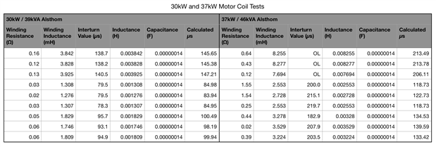

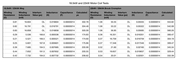

Overall, I tested 7 motors in the store, I did test another 15kW motor but unfortunately, the links provided were too large for the terminal posts and I could not configure the windings into star or delta. I also went back at a later date to measure the inductance of the windings with my Voltcraft LCR-300 instrument. A 1 minute insulation test was carried out using the Chauvin Arnoux  insulation tester, as it could measure higher values of resistance.
A summary of the results can be seen in the table below.
As you can see, I struggled with making the coil tests on some of the motors, predominantly this seemed to be more when the windings were in a 'star' configuration. This increases the inductance of the winding. However, only the 22 kW motor measured over the 50 mH inductance limit specified by Gossen Metrawatt, and only for the 'star' configuration. Yet, I could not get any coil test reading for this motor either in 'star', delta, or split winding configuration.
I could only get a coil test reading for the 15 kW motor whilst it was connected in 'delta'. The reading obtained was close to the 250 us limit of the MetraHit instrument, and the inductance was around 10 mH. In contrast, the 37 kW and 90 kW motors had around 8 mH and 7 mH inductances in 'star' configuration, but I could not obtain a coil test reading, despite these inductance values being below 10 mH, when a coil reading could be obtained.
I could only get a coil test reading for all 3 winding configurations for the 30 kW motor. When in 'star' configuration, it is possible to measure individual coils by placing one connection onto the star point and then moving the other connection to each winding in turn. Using this methodology, a coil test reading could be obtained for the 18.5 kW, 37 kW, 55 kW and 90 kW motors, leaving only the 22 kW motor unable to be tested.
However, other inconsistencies are also observed within individual motors, particularly the 3 larger sized motors. The table below, shows the differential for the winding tests for the delta configuration and individual windings.
The most concern is over the 55 kW motor, that shows the presence of an inter-turn fault in 'delta' configuration, that is not present when each individual winding is tested. The 90 kW motor also shows a drop in the differential going from 'delta' to individual windings. The 37 kW motor shows the opposite. The four smaller motors showed much more stability across their coil test readings.
The video goes through the tests on the 90kW motor for each winding configuration in turn.
As far as I am aware, all of these motors tested are of the random wound variety and I wondered if this could be the source of the inconsistent results. I do have a spare 3.3 kV motor available, so decided to carry out some tests on this with the MetraHit.

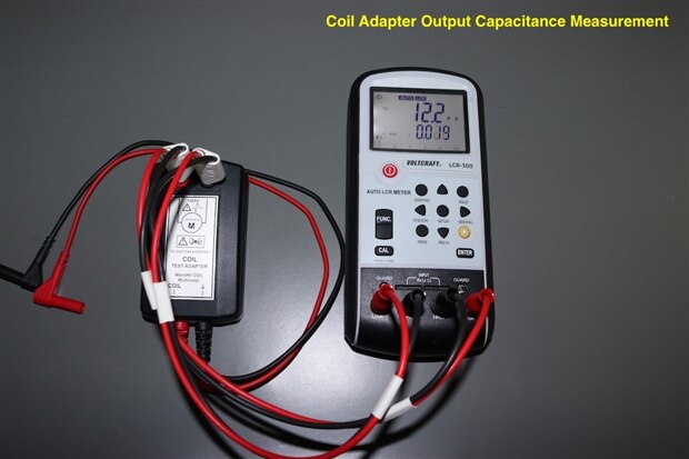

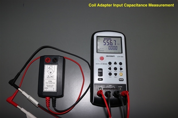

The first picture shows the open circuit output voltage of the coil test function measured through a 500x differential probe. You can see the output gets up over 1 kV with a rapid rise, that the scope could not measure and then drops away over 100 us, but never appears to go back down to zero.
I set up a number of tests using the 40 and 100 turn coils I had wound for the current amplifier to provide a load. These have been measured as having 19 uH and 135 uH inductance when tested. They read 11.12 us and 27.37 us respectively when tested with the MetraHit coil test. Interestingly, with the two coils wired in series, the MetraHit read 29.5 us, which is less that the sum of the individual tests. With the coil test having a load, the currents were measured with a Flux Flex clamp wired to the scope and the Flir CM55 set to inrush mode.
This did not work to well, so to build up the inductance, I utilised the spare coils of wire I had from winding the coils and linked them together. The table below shows the measurements and the coil test results. You can see as the number of coils in the circuit it increased, the coil test value also increases. I still did not have enough wire to reach the limit of the coil test function.
I captured the voltage and current for some of the tests. Below are the plots for 1 coil and then 4 coils under test.

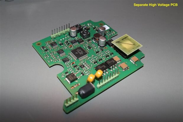

The high voltage aspect for the insulation and coil test, appears to be mounted on a separate PCB that unplugs from the main PCB. This PCB has its own micro controller in the form of a MC9S08GT16 8-bit controller from NXP as well as the high voltage transformer.
The HV PCB sits over another micro controller and the rotary function switch, amongst the passive components. The micro controller is the FS9704B from Fortune Semiconductors and provides the analogue front end for the multimeter functions.

    I have run the calculations against the side of the results obtained for each of the motor tests using a 140 nF capacitor. They work out quite well for the 15 kW motor. The two OL readings show values in excess of the 250 us limit of the instrument, effectively an over-range reading. Where the reading was obtained for the delta configuration, there is good correlation between the calculated and actual values.
    I have just noticed that I cut off the winding configurations in the tables. Top three values are star configuration then delta for next three, then open windings for last three.
    This also works for the 18.5 kW and 22 kW motors with the OL values showing calculated results over the 250 us. There also seems to be a but more difference between actual coil test values measured and calculated ones in comparison to the 15 kW motor above.
    Below are the results for the 30 and 37 kW motors but it appears that larger differences haver occurred for the 37 W motor. The calculated value for star configuration is below the maximum 250 us, but I could not measure a value. There is significant difference between the values and calculations of the other winding configurations. The 30 kW motor is more reasonable and the differences similar to the 15 kW motor.
    The 55 kW motor shows calculations beyond the limit for the OL values measured, but again significant differences for the delta and open winding configurations. For the 90 kW motor, OL measured values show a calculated value of 195 us, which is within the meter limits. Significant differences also seen for the other winding configurations between the values recorded and the calculations..

    Looking at the adapter, I measured the capacitance at the input and output using the same Voltcraft LCR meter, that I used to measure the inductance of the motor windings. Neither of the values were anywhere near the 140 nF.

    three-phase over 6 years ago in reply to shabaz
    I don't think you are that far out Shabaz. The calculations for open air coils seem to tally rather too well.
    Going back to metal affecting the motor coils, the stator windings will be embedded into the laminated stator core, that will affect the inductance value. The coils will also be wound in close proximity to one another over a larger surface area than the coils I tested in the air. This may be affecting the results.
    At the moment, the coil adapter is just a black box, so I do not know exactly what is within it. I can also get an inductance reading on the input of about 4.5 H along with a resistance of 0.20 Ohms. The output I do not get any inductance reading and a resistance reading of 0.56 MOhms.
    I will probably give them until the weekend to respond and if they don't I may consider my options to open up the coil adapter.
