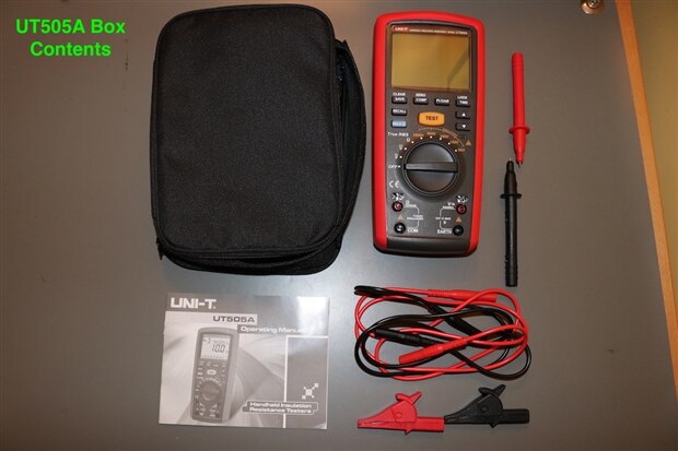

Unboxing and Overview
The tester arrived in a branded cardboard box, with everything contained within a soft case to carry the instrument around in.
The contents are quite basic. The meter itself, red and black test leads, crocodile clips and test probes along with an instruction manual. The manual is quite well written, with step by step instructions for each of the tests to be carried out, certainly enough information if one was unfamiliar with the basics of insulation testing.

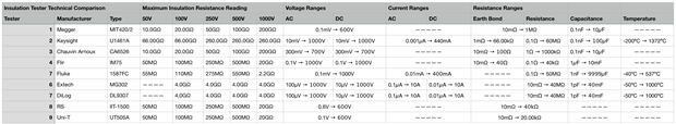

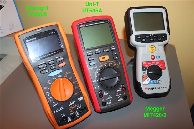

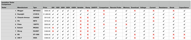

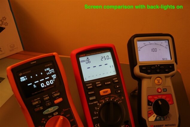

The UT505A is of similar size to the Keysight and Megger units, there are however, very few ergonomics to it in comparison to the other two units.
The UT505A is more in line with an insulation tester in terms of the functions offered. It does have voltage and resistance measurement to add to the insulation test capability, but lacks the multimeter functions that are now being seen on some of these instruments.
Interestingly, it does have a variable voltage function, that is lacking in a lot of insulation testers. This is not a ramping function though and has to be adjusted manually by the operator. Its official price  puts it in the mid range of insulation testers available, quite a bit higher than the Exotech and RS Pro units. I say 'official price' as I haven't actually seen anybody selling it for that, and it can usually be picked up for half price or even lower, making it actually the cheapest meter tested to date.
In terms of its insulation test functionality, the 500V test range, that I am predominantly interested in is limited to 500MOhm, similar to the Fluke, Flir and RS Pro units and drastically below the Keysight and Megger units that will reach up to 200GOhm. The UT505B model would go up to 100GOhm, so would have resolved this issue had it been available.
The resistance measurement function offers an automatic test current adjustment, that exceeds 200mA for earth bond testing, as required by the IEC standard.

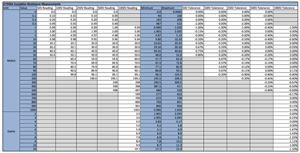

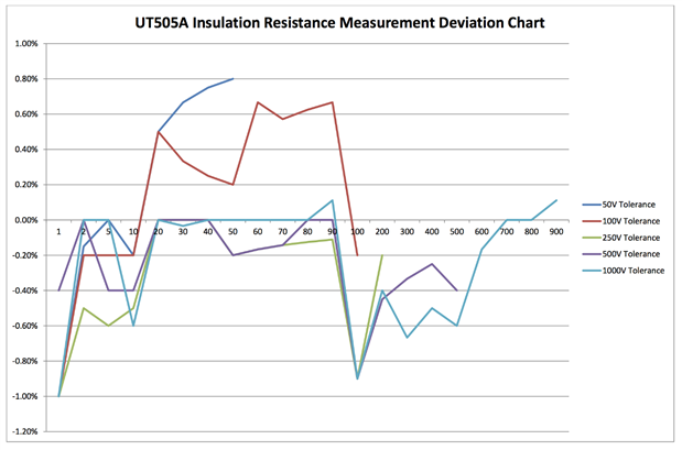

The UT505A was subjected to the same performance tests as all the other insulation testers. Insulation readings were generally within tolerance, a 10% deviation was seen for a low end value on the 500V test, but accuracy at this end is not too much of an issue of an insulation tester. At the top end of the scale, the tolerances were all found to be within 2%.
The tolerance devinions plotted produced quite a crazy graph, with a lot of sporadic behaviour seen and not much correlation evident between the five test ranges.

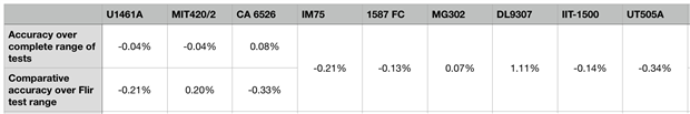

Compared to the other instruments, it doesn't come out too bad in terms of overall tolerance. It is quite a bit better than the DiLOG DL9307, approaching towards a similar accuracy level as the IM75 from Flir and close to the Chauvin Arnoux CA6526, when the two meters are compared over the same test ranges.

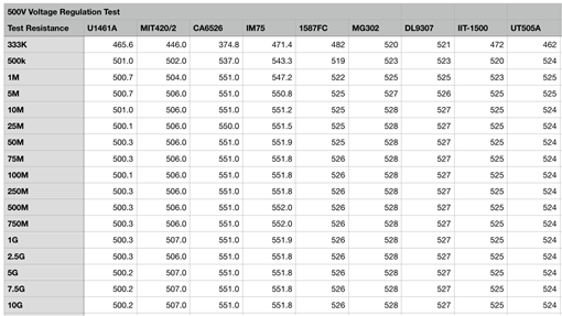

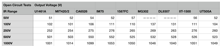

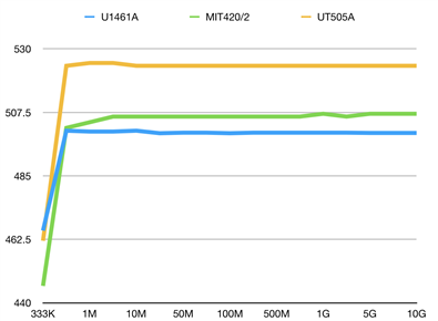

The 500V voltage regulation was typical for an insulation tester, the manufacturer specifying it to be within +10%, which it was well within. Compared to the Keysight and Megger units, it shows a much higher deviation, but these two units are just in a class of their own with this test.

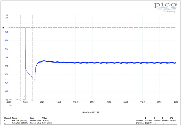

A scope capture of the output of the UT505A shows a sharp initial voltage spike, that then drops down below the test voltage before recovering back up to the specified value. This initial spike is quite significant, measuring as nearly twice the rated test voltage and is some of the worst regulation I have seen on an insulation tester.
In comparison to other instruments, the steady state voltage seemed to show more fluctuation and noise.

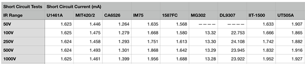

The short circuit current is within the IEC recommendations and in accordance with the manufacturer's specification of less than 2mA. It is also quite even across the test voltage range. Circuit discharge resistance seen below is the highest of all the meters tested. Not a specific problem, but worth while realising that it will take a bit longer to discharge a winding after a test.

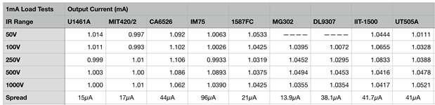

There were no problems with the 1mA load test requirements of the IEC standard. The current spread across the ranges was similar to the Chauvin Arnoux CA6526 unit and half that of the Flir IM75 unit, both £600+ testers.

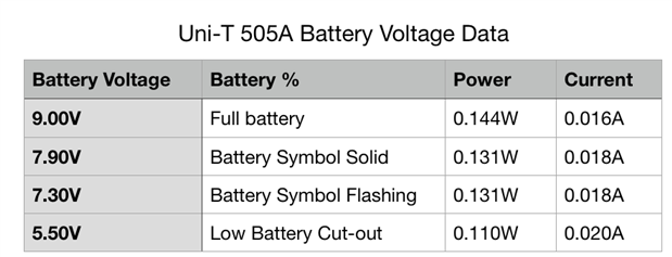

Battery performance is seen in the picture gallery below. Low cut out is at 5.5V, giving a typical battery usage in comparison to the other instruments reviewed.
{gallery} UT505A Battery Performance
Battery Voltage Level Warnings
Battery Load Tests
Battery Capacity Comparison

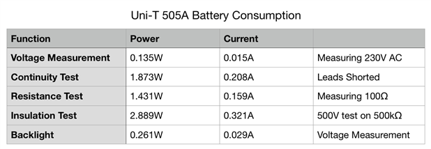

Consumption data for each test shows the much higher load requirement during an insulation test, quite a bit higher than the 200mA earth bond test. Use of the backlight only adds an extra 15mA to the battery load. The backlight works well and enhances the display, to me this display isn't quite as crisp as the Megger unit, the analogue simulation is a straight bar across the bottom of the display, instead of the arc type at the top, which I tend to prefer.

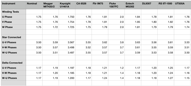

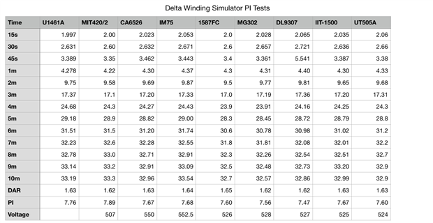

Winding Simulator Tests
Now to test the meter against the winding simulator looking at the performance of the resistance and insulation test ranges.
{gallery} Winding simulator tests
Phase resistance measurements table

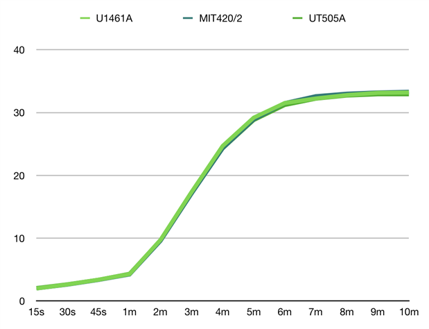

Polarisation Index measurements table
Polarisation Index Plot
Phase resistance measurements were to two decimal places and were some of the most accurate against the nominal values. The polarisation index plot showed very little deviation from the two baseline meters.

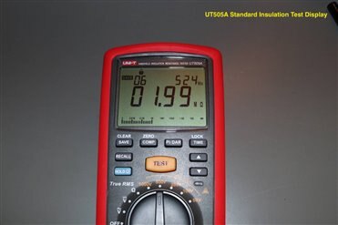

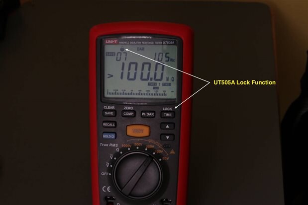

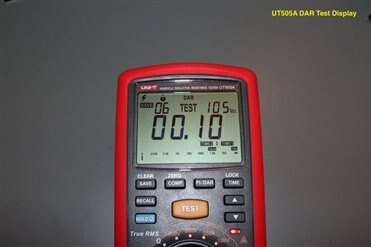

There are two options when carrying out timed insulation tests. A time button that allows a number of single durations to be tested. A PI/DAR button that provides the single standard 10min/1min PI ratio and two DAR ratios of 1min/30s and 1min/15s. This latter ratio is also unusual and not recognised as far as I am aware. A 30s/15s ratio is, but this is not one of the options.
During the timed tests, the insulation value is displayed, but there is no time value on the display. During a PI/DAR test, this is opposite, and the count down time is displayed, but there is no insulation resistance reading. At the end of the test, the readings at the two time points and the ratio value can be cycled through, but there are no intermittent values and using the PI/DAR function, you would also not be able to record them manually. I have always recorded insulation readings every 15s for the first minute and every minute after that for a PI test, as if a low PI value is obtained, the shape of the resistance plot can provide further insight into the cause of the low reading. To me, not being able to see the insulation values, is a major flaw in the design of the instrument.
The pictures below show the display for a standard and DAR insulation tests.
I also found that the 'Lock' function has to be enabled to start a PI / DAR or timed test. If it is off, the meter will not start the test and just beeps. However, whilst the meter will switch off after a timed test and display the resistance value, it does not switch off after a PI or DAR test, whilst the ratio is displayed and you can cycle through the results, the output of the tester remains on. The could easily catch someone out if there was a lapse in concentration or interruption during the test. Whilst a shock from an insulation tester of this nature is not harmful, injury may occur due to the surprise of receiving a shock, dependent upon the work conditions.
In operation, without a timed test selected, the meter automatically locks on and has to be stopped manually with a second press of the test button. This differs from all the other insulation testers I have looked at, where a second button has to be utilised with the test button to get the output to lock on. During later testing I did find out that I could turn this off by disabling the 'Lock' function, but this seems to be retained based on the last selection, even after the meter has been turned off and back on again, it does not default to being off.

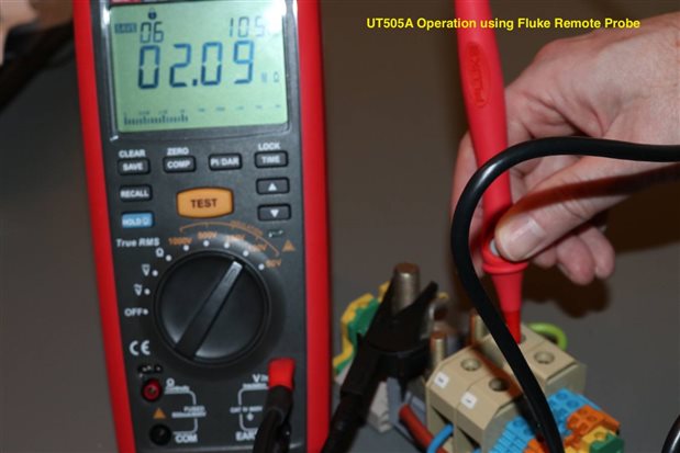

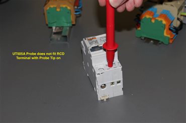

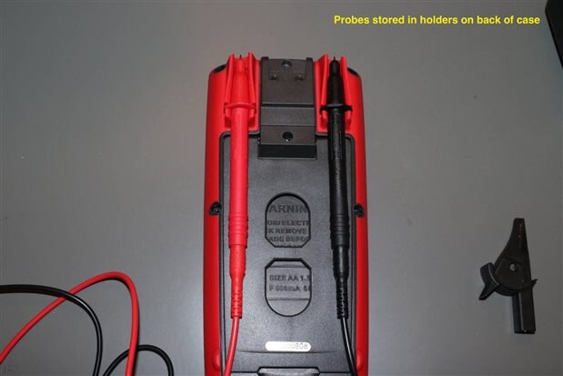

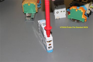

The test leads are PVC insulated and come with a pair of rather bulky test probes and two crocodile clips. Whilst the meter has a connection for a remote operation test probe for both the insulation and continuity functions, one is not provided with the tester and needs to be purchased separately. Rummaging around it my wee collection of insulation testers found a remote probe that would fit in the UT505A and operate it. This is highly unusual, the remote probes up until now have been bespoke designs to each manufacturer. The winner of the matching remote probe, the Fluke 1587FC.
The probes have removable safety caps on them, that conform to GS38 requirements. With the caps on, access to terminations can be restricted. Whilst I could get the probes into an MCB, they would not fit into the output terminals of a Merlin Gerin RCD. Anything smaller than an SAK35 terminal and the probe would not go in with the safety cap on. Removing the cap, reveals a probe tip suited to accessories with 4mm sockets. However, I could still get the probe to fit into all the terminals with the safety cap off.
The crocodile clips are a little on the small side for larger terminals. They will just go around an M12 (1/2") nut which is 19mm (3/4") across flats. They will go easily around the M12 stud. This may cause issues when seeking to find an earth to clip on to when testing larger variety motors.

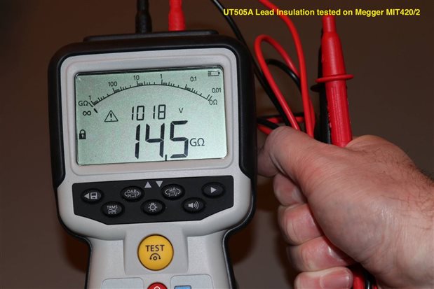

During the tests, I checked the insulation level of the leads at 1000V when they were tangled together. The UT505A at 1000V will read up to 20GOhm, so the Megger MIT420/2 was used for this test. As typical with PVC leads, the insulation was lower than the full scale range of the tester, although it is not the worst I have seen. This isn't likely to affect a standard one minute insulation test, but could well impact on a PI ratio test where the ten minute reading reaches high GOhm values.
Quick one minute(ish) video on testing the leads.

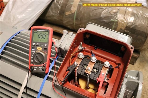

Whilst the motor phase resistance appeared to be balanced across all three phases, all three readings were 0.0 Ohms on the UT505A. Other testers on this motor have measured the resistance to be around 0.2 Ohms. I am not sure what caused this low reading on the instrument.
At a 500V test voltage, the insulation resistance is limited to 500MOhm at full scale, so I was fully expecting the instrument to go over range during the DAR and PI tests. Whilst the meter does go over range, it still returned a DAR ratio of 1.02. During the test, the insulation resistance value is not displayed, only the timer countdown. After the test the 15s, 1min and ratio can be paged through to obtain at least those readings.
Overall, the UT505A seems reasonably capable of testing the motor, and results were obtained that would lead the tester to believe the motor was serviceable.

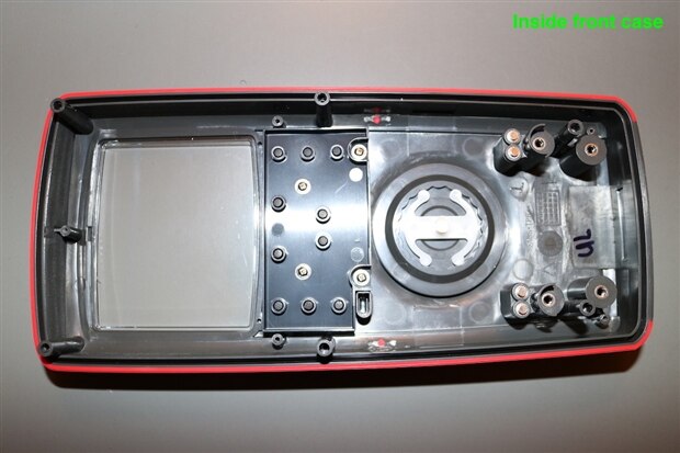

Build Quality
Uni-T is renowned with producing budget style instrumentation, so I was keen to take a closer look at the unit. The case is full moulded, with an outer red moulding, that gives the impression of a protective rubber coating. Whilst not quite as hard as the grey plastic, it does not provide the same protection as a separate rubber boot, such as those found on Keysight instruments. There are probe storage grippers on the back of the instrument, that do work well with the probes supplied, despite their chunky nature.

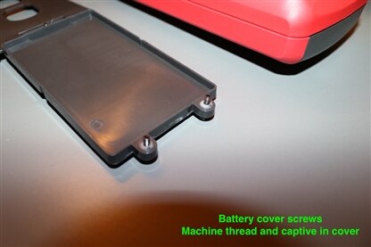

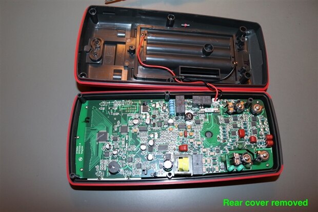

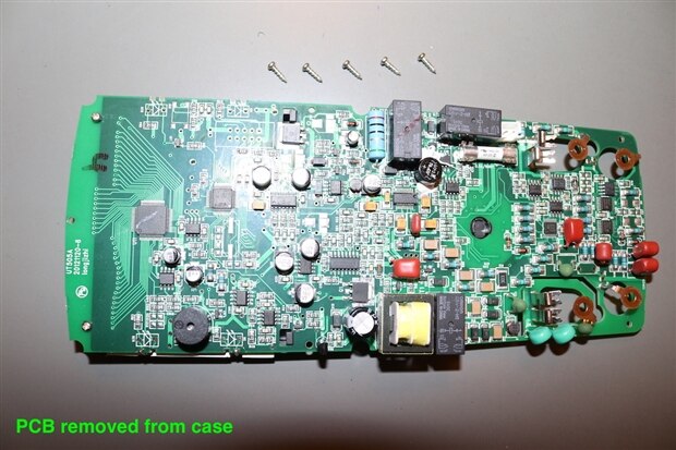

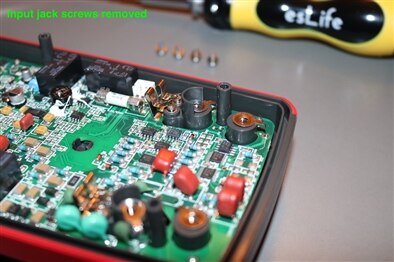

The tilt stand and battery cover are removed as one by undoing three machine screws. With the cover removed, these screws are all retained within the cover, preventing their loss. Quite a nice touch, from a more competitively priced instrument.
With the rear cover removed, another nice touch is seen. The battery case leads are held in place on the back cover to prevent strain on the soldered connections and a small JST style connector is used to connect the battery leads to the main PCB, allowing the back cover to be easily removed out of the way.

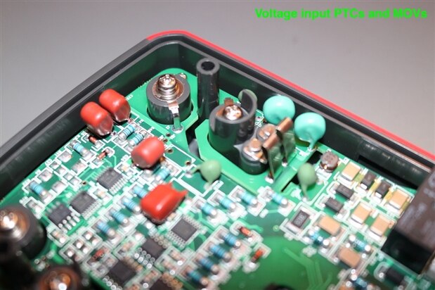

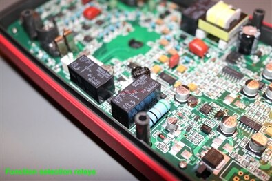

The meter is marked as having a CAT IV input rating to 600V. Whilst the input jacks are screwed into a full plastic moulding, giving great mechanical support, and there appear to be isolation slots around the positive input terminal, there are only two MOVs and two quite small PTCs to protect the voltage input.
Whilst the PCB is 'busy', its layout does seem quite neat. The pulse transformer for the high voltage is situated close to the insulation test output terminals and looks to be switched through an Omron relay. Two other selection relays, also Omron are located on the opposite side of the PCB of the resistance and continuity function.
The continuity function is protected by a small 20mm HBC fuse, but this will have a low breaking capacity and does not afford the same protection as the voltage inputs if an error is made. All four input jacks are held in place with machine screws. The two remote probe connections clip around stubs, pressed into the plastic case.
The main microcontroller is from Silicon Labs, a C8051F340, 8 bit 50Mhz device, and a PCF85176H display driver form the brain boxes of the UT505A.
The main PCB is held in place with 4 self tapping screws into the front case. Inspection of the PCB shows good attention to detail. There were no signs of modifications to the PCB or residue around any of the solder joints. A little bit of mastic type substance was found providing support to a bridge rectifier component.
The front side of the PCB contains the main selector switch, function button pads and the display.
A small pice of plastic debris was found underneath the selector switch, other than this, no debris was found inside the case.
Overall, this is a reasonable quality unit that Uni-T have produced, with some very nice touches to it, that are not found in other more expensive insulation testers.
