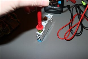

The GS38 caps were found to restrict access to the smaller terminals. SAK6 and above, along with standard MCBs all accepted the probes with the caps fitted. With the caps removed, access to the smaller terminals was achieved.

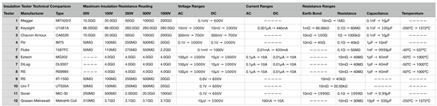

Comparing the instrument with the others reviewed puts it in as a mid-range instrument with a very high price tag. Whilst it has its unique coil test function and offers more multimeter functionality than a standard insulation tester, it lacks quite important functionality when carrying out insulation tests, not having a variable or ramp voltage function and no DAR or PI calculation capability. There is no remote probe option with this meter, although personally, I would not find that to be much of an issue for motor testing.
Looking at the technical aspects, it has a somewhat limited insulation test range, reaching 3.1 GOhm for the two higher test voltages and 310 MOhm for the lower test voltages when reading the data sheet, although this proved not to be the case when tested. Both the Keysight and Megger units along with the Chauvin Arnoux tester offer up to 200 GOhms on a 1000 Volt test.
Voltage and current functions on the MetraHit are comparable to the other insulation multimeters and better than the Fluke. The complete current range on the MetraHit is from one input jack and not split across two, as it is with the Keysight. The MetraHit does have a good capacitance range and comparable temperature range with a thermocouple.
The resistance range goes up to 30 MOhms, which is a little lower than the majority of the other units. It also lacks a bond test function, which is surprising for an instrument aimed at testing motors.

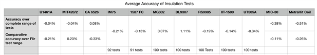

The deviation plot for the accuracy shows a consistent trend across the voltage ranges, with the most inaccuracy occurring above 300 MOhms.
Compared to the other instruments, the MetraHit lacks accuracy against the Keysight and Megger units over their full range. When compared to a reduced number of tests, the MetraHit performs a little better, seemingly more accurate than some of the cheaper units, but not as accurate as the more renowned brands such as Fluke.

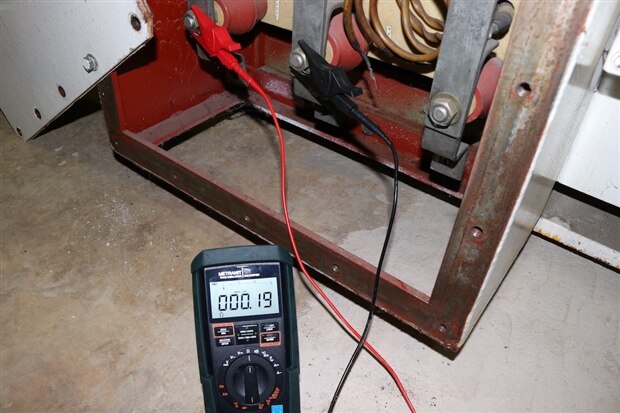

The MetraHit does have a zero / relative function to compensate for the lead resistance which was utilised during the tests. Whilst the meter remains switched on, the zero value is remembered even after changing functions and switching back to the resistance function. After the meter has been switched off, the zero function is lost and has to be set again.

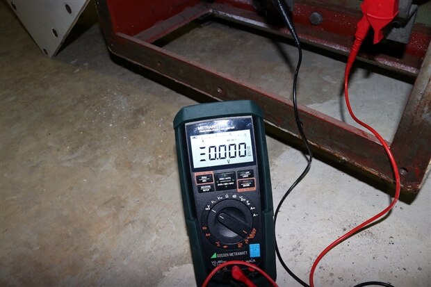

Motor Tests
More motor tests were carried out with the MetraHit, mainly to investigate the functionality of the Coil Test, rather than the insulation test, as it was already apparent that this element was substandard.
The coil test is another test carried out with the motor isolated from its energy source. It utilises a small extra test box connected between the MetraHit and the motor under test. As the box comes with its own test leads that plug into the MetraHit, the test leads from the MetraHit are used from the test box to the motor.
Another slightly bemused scenario occurs. The operators manual for the MetraHit includes the warning below, that the tests should be carried out using crocodile clips and not to hold the test probes onto the motor - shame they didn't supply some crocodile clips with the package then.
I have a variety of motors to use the coil test facility on. The manual indicates that the standard 'Coil Test' adapter supplied is suitable for use on motors with an inductance between 10 uH and 50 mH at 100 Hz. I do not find this much use, as the inductance of a motor winding is very rarely known. It could be measured of course, but that would mean another meter. A look at the data sheet provided, (extract below) provides a bit more information stating that the 10 uH to 50 mH corresponds to motors in the region of 15 kVA to 80 MVA rating. This is obviously, much easier for engineers to relate to. It would be beneficial to include this information in the subsection of the manual detailing the coil test function.
The coil test function is easy enough to use. Unlike an insulation test where the connections are on the winding and the motor case, the coil test requires both connections onto the windings. There is no stipulation that the winding must be in star or delta, so I tested each motor in both configurations.
The test is specifically designed for three phase windings and provides a comparison of the three phases tested. Each phase test is marked by a progression bar on the left hand side of the screen. The comparison is seen in the analogue display at the top of the screen, there is no digital confirmation of this. The actual reading is shown on the main screen, but as with the insulation testing it is lost as soon as the test button is released.
The manual gives a basic interpretation guide that a difference greater then 10% indicates the presence of shorted turns in the stator winding. The motor tested above shows a difference of circa 17%, which is annoying, because as far as I am aware, the motor is new and never been in service.
Overall, I tested 7 motors in the store, I did test another 15kW motor but unfortunately, the links provided were too large for the terminal posts and I could not configure the windings into star or delta. I also went back at a later date to measure the inductance of the windings with my Voltcraft LCR-300 instrument. A 1 minute insulation test was carried out using the Chauvin Arnoux  insulation tester, as it could measure higher values of resistance.
A summary of the results can be seen in the table below.
As you can see, I struggled with making the coil tests on some of the motors, predominantly this seemed to be more when the windings were in a 'star' configuration. This increases the inductance of the winding. However, only the 22 kW motor measured over the 50 mH inductance limit specified by Gossen Metrawatt, and only for the 'star' configuration. Yet, I could not get any coil test reading for this motor either in 'star', delta, or split winding configuration.
I could only get a coil test reading for the 15 kW motor whilst it was connected in 'delta'. The reading obtained was close to the 250 us limit of the MetraHit instrument, and the inductance was around 10 mH. In contrast, the 37 kW and 90 kW motors had around 8 mH and 7 mH inductances in 'star' configuration, but I could not obtain a coil test reading, despite these inductance values being below 10 mH, when a coil reading could be obtained.
I could only get a coil test reading for all 3 winding configurations for the 30 kW motor. When in 'star' configuration, it is possible to measure individual coils by placing one connection onto the star point and then moving the other connection to each winding in turn. Using this methodology, a coil test reading could be obtained for the 18.5 kW, 37 kW, 55 kW and 90 kW motors, leaving only the 22 kW motor unable to be tested.
However, other inconsistencies are also observed within individual motors, particularly the 3 larger sized motors. The table below, shows the differential for the winding tests for the delta configuration and individual windings.
The most concern is over the 55 kW motor, that shows the presence of an inter-turn fault in 'delta' configuration, that is not present when each individual winding is tested. The 90 kW motor also shows a drop in the differential going from 'delta' to individual windings. The 37 kW motor shows the opposite. The four smaller motors showed much more stability across their coil test readings.
The video goes through the tests on the 90kW motor for each winding configuration in turn.

This motor can only be connected in 'delta' configuration due to the spacing of the motor terminals and the links. The inductance measurement indicated a values in the region of 14mH, so based on the readings from the low voltage motors, I wasn't expecting to see a result for the coil test.
First, I tested the motor winding resistance. For a motor this size, this test would usually be carried out with a micro-ohmmeter, but the results obtained were balanced at 0.19 Ohms across all three phases.
The victory was short lived though, as the coil test merely showed over-range on all three phases.
This is quite a disappointing result and I am unsure as to why the instrument is failing to provide readings on so many motors. To investigate the issues a little more, I set up tests using an oscilloscope and Rogowski coil style clamp meters to record the output voltages and currents during the coil test.

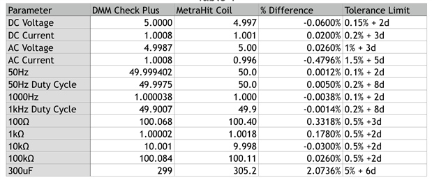

With the MetraHit Coil having multimeter functions, I decided to carry out a quick check of them against a DMM CheckPlus calibration source. The DMM CheckPlus offers single values of AC and DC Voltage and Current test points, along with four resistance values. The AC frequency can be switched between 50 Hz  and 1 kHz. Below the MetraHit can be seen measuring the 1 kOhm resistor.
The results obtained were all within the manufacturers limits.
The CheckPlus does not have a capacitance test, so to test this function a 300 uF test capacitor I built up was used to test the MetraHit to its maximum capacitance range. The reading obtained showed the highest deviation of any of the multimeter functions tested, but it was still within specification and measurement of high value capacitance usually comes with high tolerances for multimeters.
Whilst carrying out the current checks, the 10A fuse was removed to simulate the effect of a blown fuse. The meter detects this and prompts the user to check the fuse, thesis another excellent safety feature, particularly useful when a meter is used to measure current transformer secondary currents.

The DMM functions are all good, they seem to fit the needs of most electricians and are accurate against the DMM CheckPlus. The input jack blocking safety feature is brilliant and my preferred method against warning bleeps or messages. The blown fuse warning is also another excellent safety feature, that is missing from a lot of instruments I have looked at.
The Coil Test function is intriguing and something I have not seen before. In principle, it appears to work, but I think it needs more refinement. I certainly struggled to get it to work across the range of motors suggested by Gossen Metrawatt. I think the 80 MVA rating is a typo, unless they are implying that an alternative Coil Adapter is required. The Coil Test was intermittent between different winding configurations, that I was not expecting and leads to uncertainty about its reliability. There was no recording of the individual readings, just the end comparison, that, for me, also detracts from its usefulness.
Then we come to the insulation testing function. Oh dear. For me, this is one of the worst implementations of an insulation tester I have ever come across. It seems as though the inclusion of the Coil Test function has been done at the expense of the insulation testing function. However, this is marketed as a 'Motor Testing Multimeter'. Surely a basic test of any motor is an insulation test, probably even more important than testing of inter-turn faults.
There is no DAR or PI ratio and not even a way to lock on the insulation test, so that a standard 1 minute test can be achieved. The actual output voltage is not displayed, there is no option to display the leakage current. The result can only be retained on the screen when using the semi-automated test function.
Looking through the literature and meter markings, it is not obvious that the meter has been built to the IEC 61557-2 standard, the 1000V test function did not test as compliant with this standard. This, I just do not understand, especially when coming from such a renowned manufacturer as Gossen Metrawatt. Testing a customer's apparatus needs assurances and compliance with IEC and other standards gives my customers the assurance that the test apparatus is designed to function the right way.
On the good side, the insulation test does range up to 3.1 GOhms for test voltages of 100 V and above. For my specific tests, I would want a higher range, in the region of 40 GOhms, but for general motor testing the 3.1 GOhms, should be fine.
There is no 200mA continuity function. Whilst the resistance function worked very well and was very accurate, IEC requirements for testing earth bonds requires at least a 200mA test current. That means I need another meter with me to carry out this function.
Since the meter is aimed at motor testing, and according to Gossen Metrawatt, has the capability to test large motors, these types of motors are likely to be in installations requiring CAT IV protection, so the CAT III level is also a disappointing feature.
