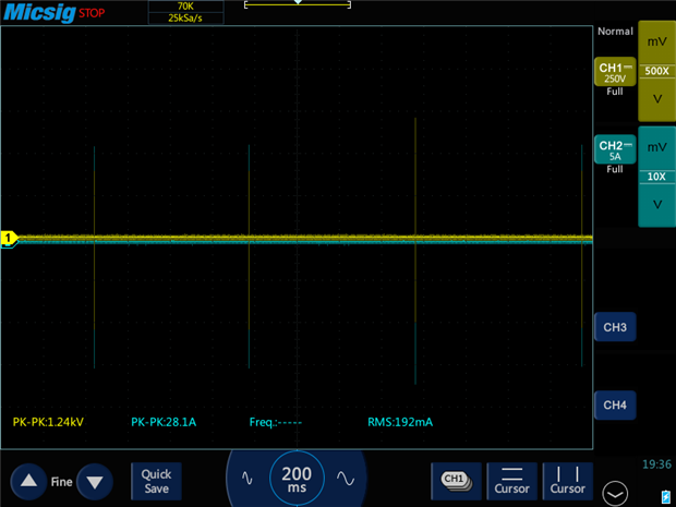

The first picture shows the open circuit output voltage of the coil test function measured through a 500x differential probe. You can see the output gets up over 1 kV with a rapid rise, that the scope could not measure and then drops away over 100 us, but never appears to go back down to zero.
I set up a number of tests using the 40 and 100 turn coils I had wound for the current amplifier to provide a load. These have been measured as having 19 uH and 135 uH inductance when tested. They read 11.12 us and 27.37 us respectively when tested with the MetraHit coil test. Interestingly, with the two coils wired in series, the MetraHit read 29.5 us, which is less that the sum of the individual tests. With the coil test having a load, the currents were measured with a Flux Flex clamp wired to the scope and the Flir CM55 set to inrush mode.
This did not work to well, so to build up the inductance, I utilised the spare coils of wire I had from winding the coils and linked them together. The table below shows the measurements and the coil test results. You can see as the number of coils in the circuit it increased, the coil test value also increases. I still did not have enough wire to reach the limit of the coil test function.
I captured the voltage and current for some of the tests. Below are the plots for 1 coil and then 4 coils under test.

Armed with this knowledge, I returned to the motor store to capture the pulses for one of the motors that I could not obtain readings for. The motor of interest to me was the 18.5kW motor that I could measure in 'delta' configuration but not in 'star'.
{gallery} Voltage and current plots during motor test
Motor testing
Pulse output during delta tests
Pulse output during star tests
Not much difference was seen in the output between the tests in 'delta' and 'star' configuration. A current was still observed to flow, although slightly lower in 'star' despite the voltage amplitude being seen to be higher during the 'star' tests. The pulse length was certainly longer in 'star' configuration compared to 'delta', presumably, this is longer than the meter can detect. Again. the measured length of the pulses, did not correlate with the readings obtained on the meter of the 'delta' configuration.
