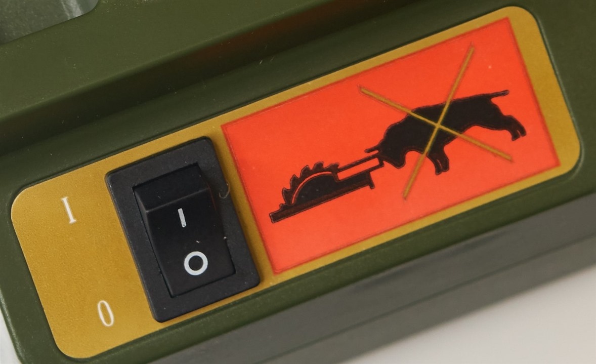

The photo below shows the power switch, and to the right of it, one of the two holes that can be used to screw the table saw to a surface (I won’t be doing that).

  • beacon_dave
    beacon_dave over 1 year ago +1
    How could you manage not to comment on this feature ?
  • beacon_dave
    beacon_dave over 1 year ago in reply to shabaz +1
    I'll just use my pet rhino to push the workpiece instead... I'll 3D print some adapters for its horn. I suspect that they realise that the symbols will either wear off the switch or become covered in…
  • beacon_dave
    How could you manage not to comment on this feature ?  Joy
    shabaz over 1 year ago in reply to beacon_dave
    That is a fantastic warning symbol! : ) Worth enlarging and placing on the wall : )
    The redundant power legends are interesting : )
  • beacon_dave
    I'll just use my pet rhino to push the workpiece instead... I'll 3D print some adapters for its horn. Slight smile
    I suspect that they realise that the symbols will either wear off the switch or become  covered in grime. It also gives them the option to use switches without markings.
    A 3d-printed rhino or a bovine-shaped push stick would make a great product : )
